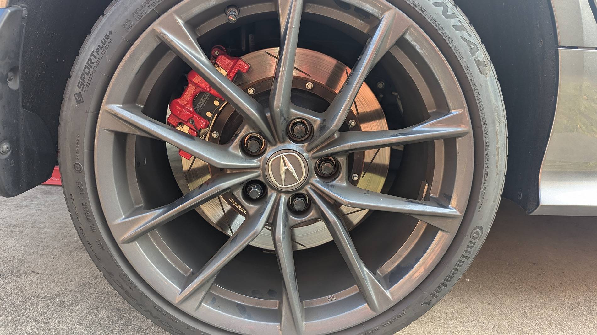

Paragon rotors front and larger rears installed. Running Dixcel Z pads in the front and M pads in the rear.. recommendation since im running a larger rear rotor .
Dirty wheel pic..
I did get a brake check light on the dash. I drove it around some and turned it off each trip,4 times in total. On the 5th power on the brake light went off.
I did use a tool to spin the rear brake piston inward.
https://www.amazon.com/8MILELAKE-Brake-Caliper-Wind-Professional/dp/B0122Q83T4/

How are you liking the rotor and pad combo? Are they loud at all?

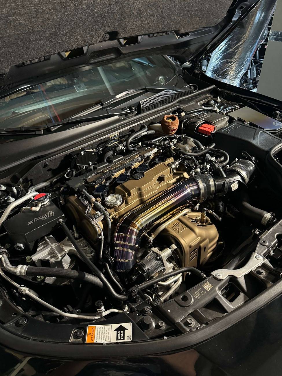

Intake, turbo inlet pipe, turbo, and downpipe among other bits and bobs installed this weekend. I'm so happy with it!!

I havent heard any squeaking or sounds from them.
It does seem to offer more bite on intiital braking which i prefer. Only time will tell if dust is better but the Ms are supposed to be.
