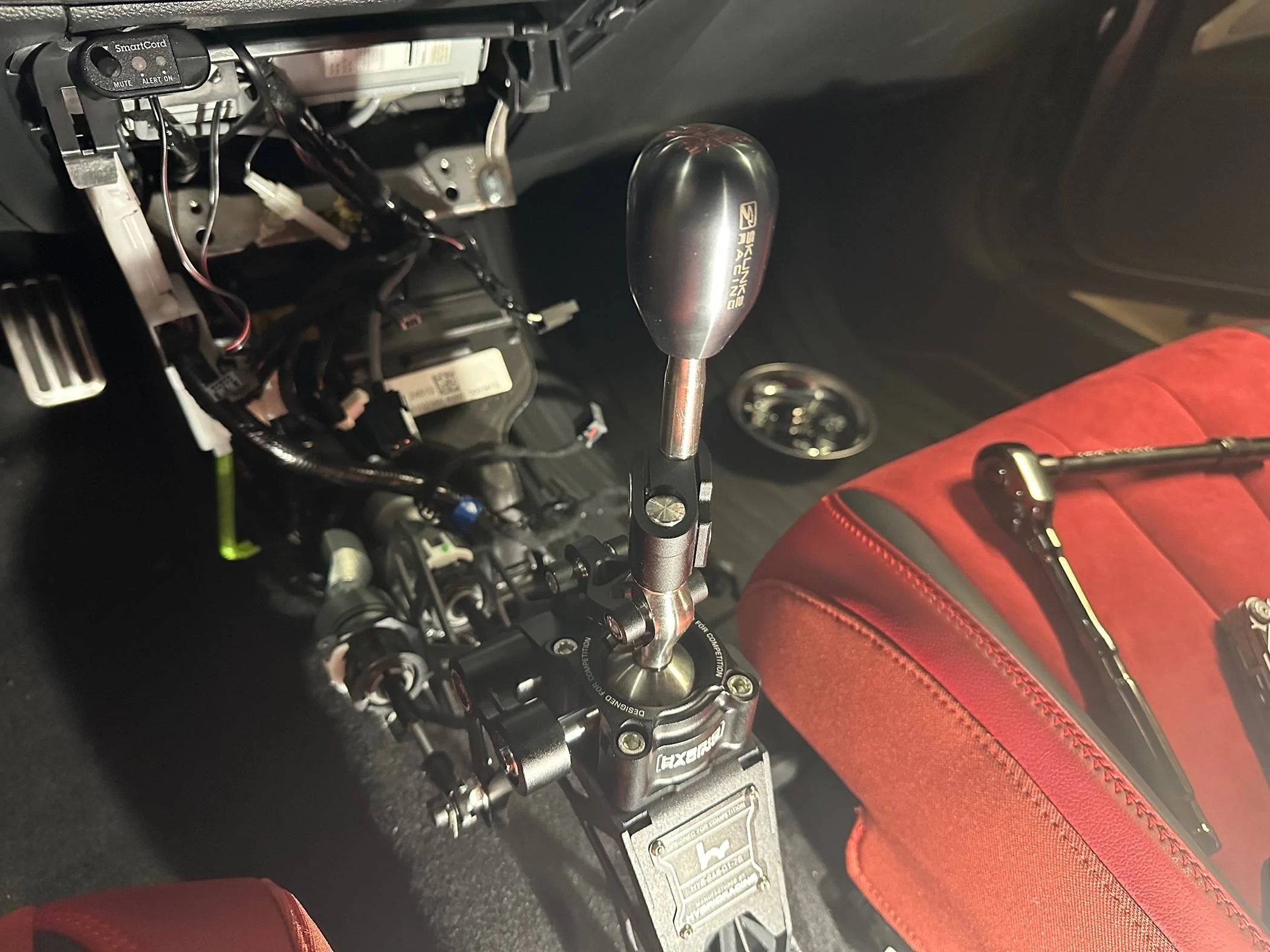

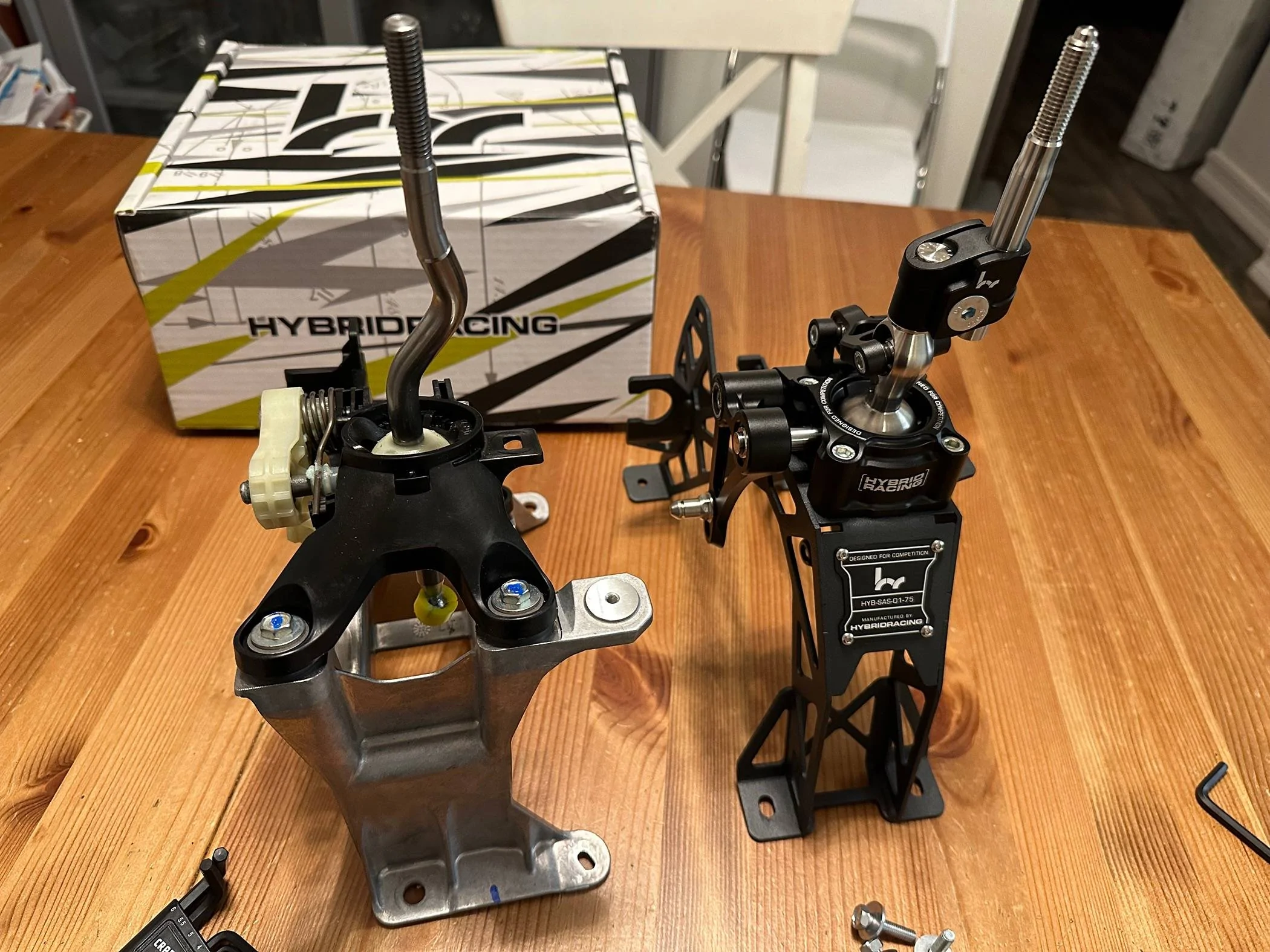

I experienced the issue going into 2nd during stop and go traffic. I installed the hybrid racing short shifter assembly which provided a solid and positive shift into gear over stock. The upgrade is pricey, but the install is straight forward.

I am very close to pull the trigger on Hybrid Racing shifter.
I am waiting for Acuity to release their shifter so I can compare. But Acuity shifter takes forever, and I am losing my patience. I emailed them, and they told me early 2024. They are not providing more details.

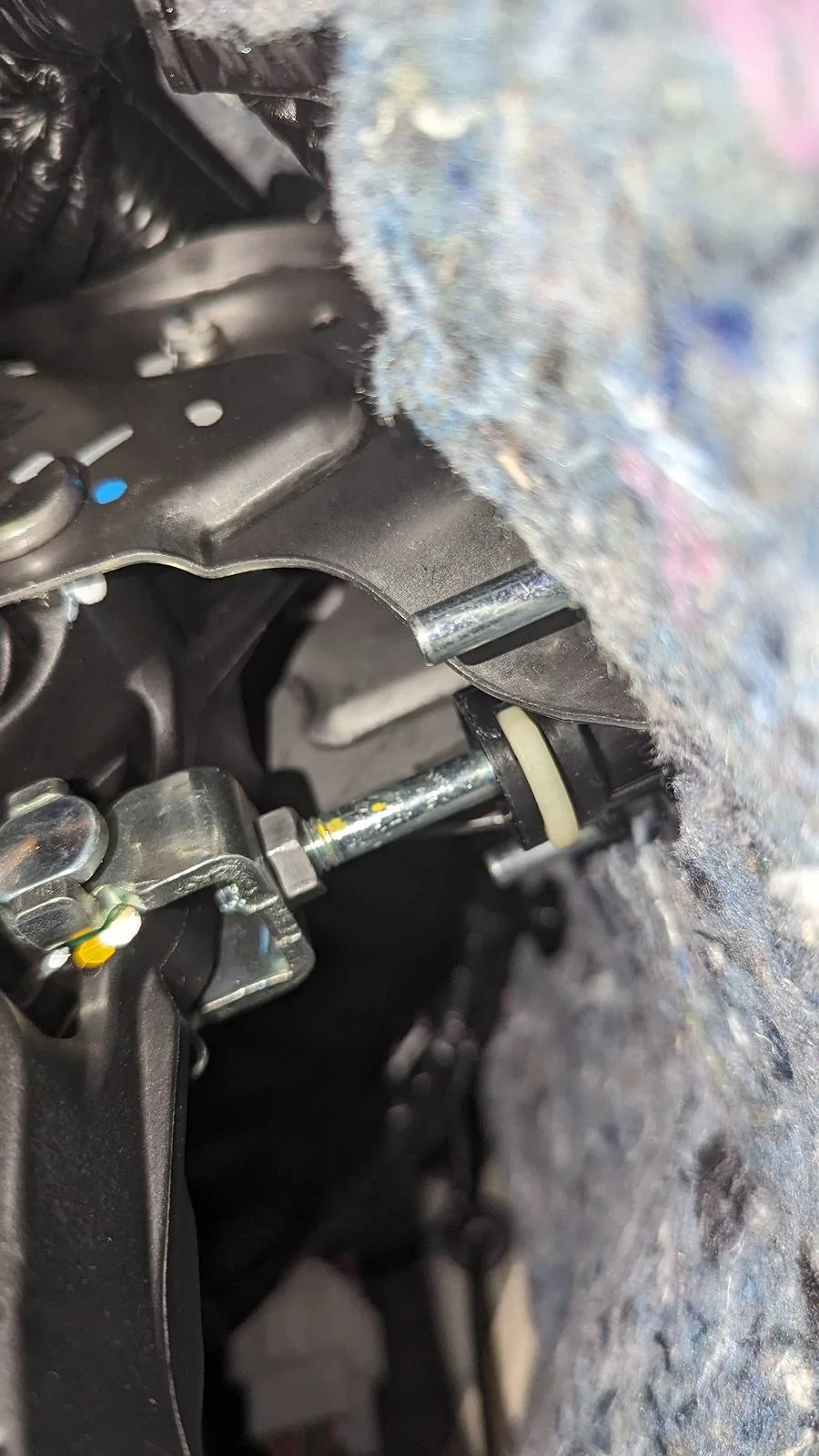

Here ya go. Just losen the nut and turn the shaft it's attached to. Depress clutch with hand back and forth just a little bit and you can feel slop. Adjust accordingly
It's a 12mm wrench if that helps anyone. The pedal adjustment on the front side is 17mm. I had to use a pair of pliers (wrapped in a little tape) to turn my CMC plunger. Others seem to be able to spin it with their hand.

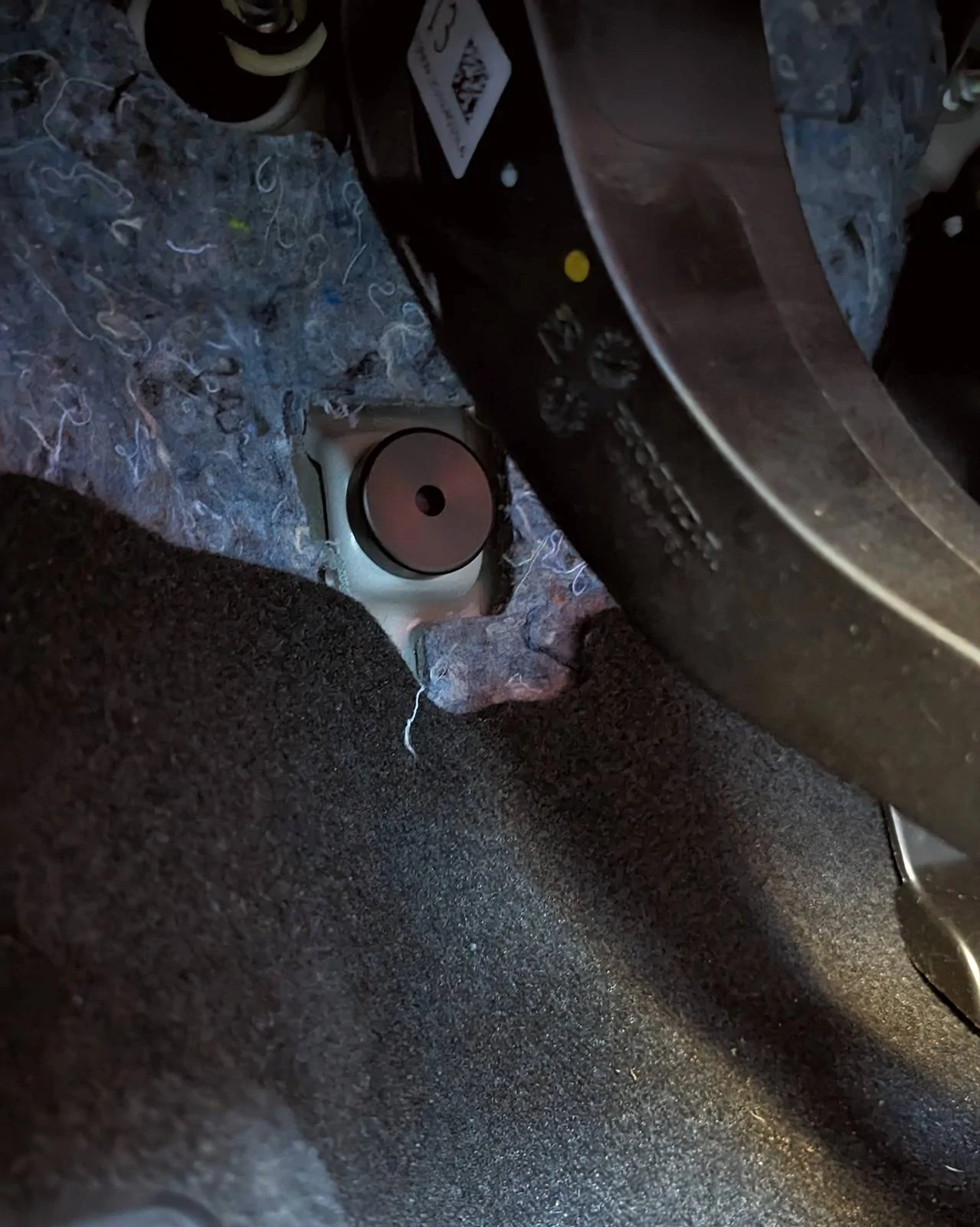

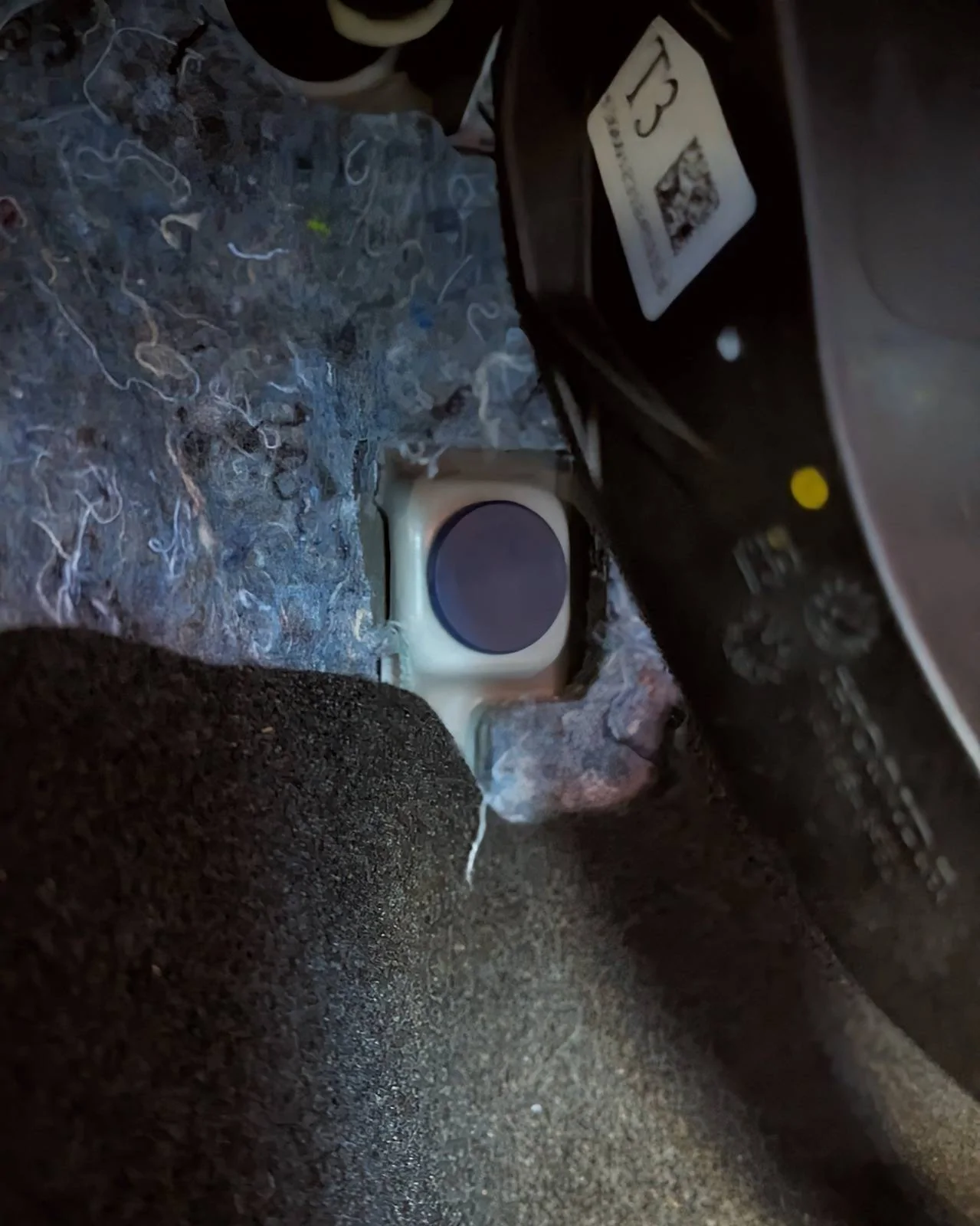

The source of this issue is the CDV in the slave cylinder. That piece of plastic slows the fluid through the slave cylinder to help protect to the clutch system. you spirited drivers (speeders) are probably shifting faster/harder than the cdv can handle. That will cause lockouts/grinding
Removing the CDV in the slave will noticeably help fix the issue. Leave the MC alone.

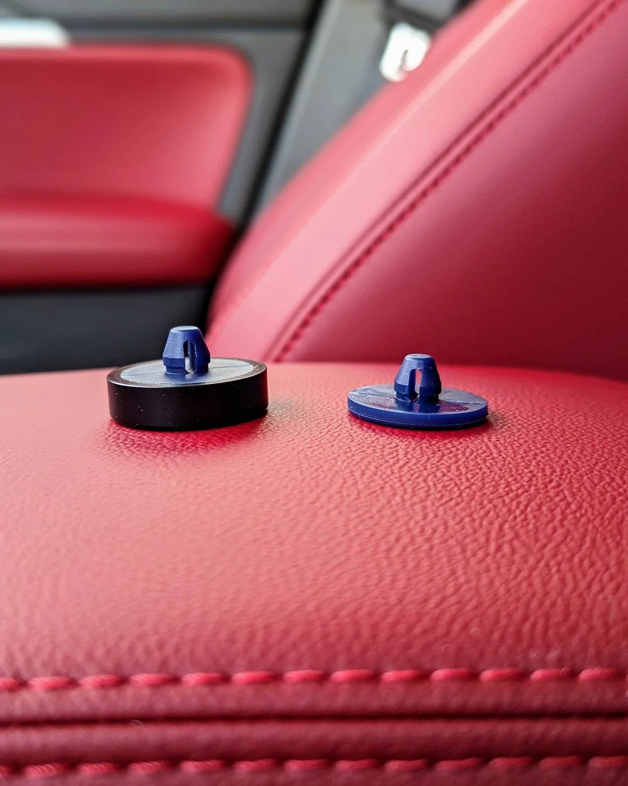

Recently installed a raised rigid stopper, which kinda does the same thing in addition to shortening the clutch throw.
I like this approach also! Lol where did you find this?

The grinding for me is not under hard acceleration. Adjusting the CMC plunger has seemed to help.
