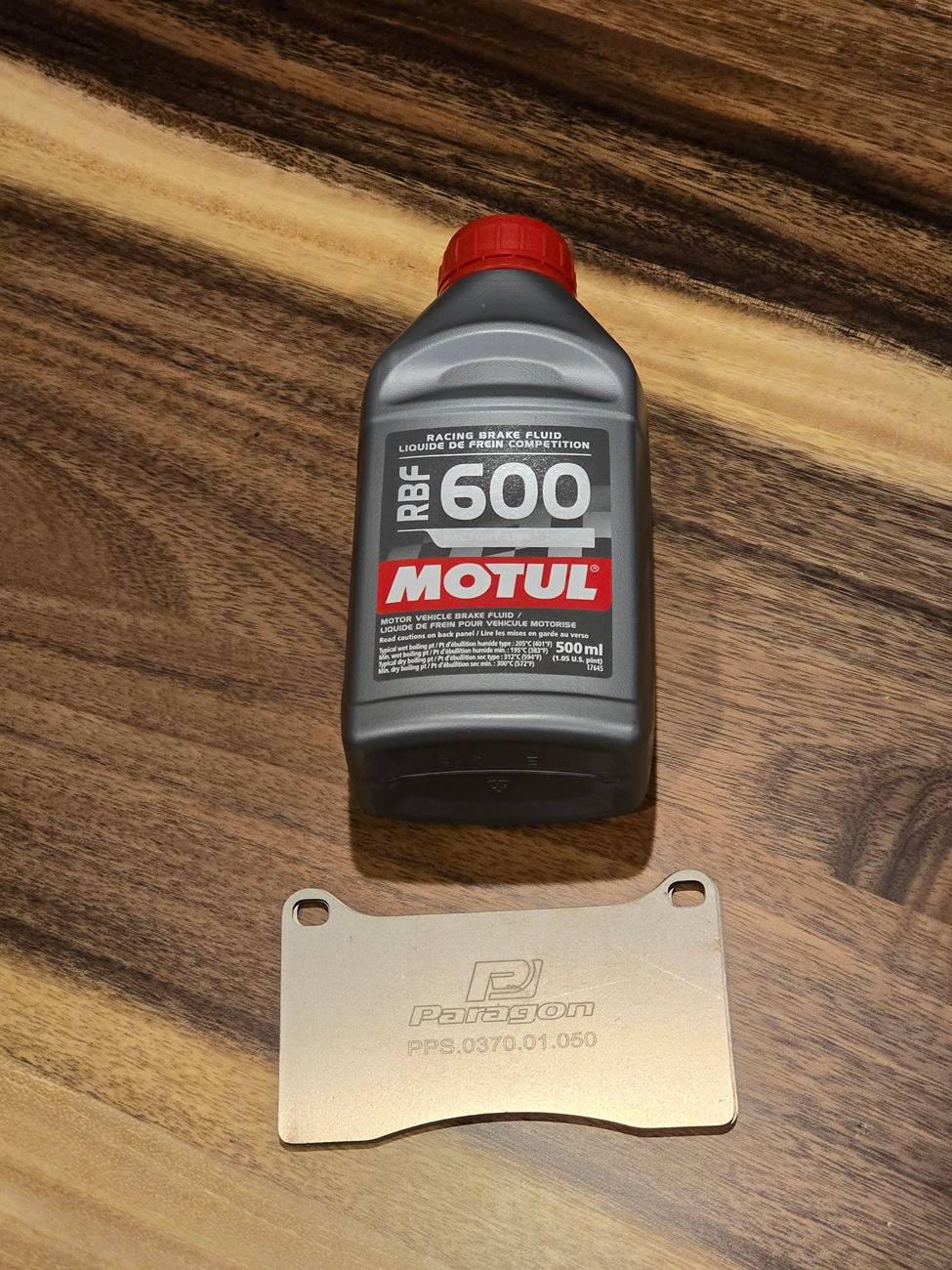

Also got some ti shims and brake fluid for the upcoming testing day. The paragon shims are nice, but their texture is pretty rough and they're pretty scratched up. It's not a visible part so it is what it is, but I expected at least just a smooth flat finish. I typically bought yperion brand shims before from a sketchy Russian dude, but that was pre war days. Now those same shims run for far more. They had more options for thicknesses, and these paragon shims are about right in the middle of the yperion options. The fun thing about ti shims is seeing where and how they change color as they get hot!!

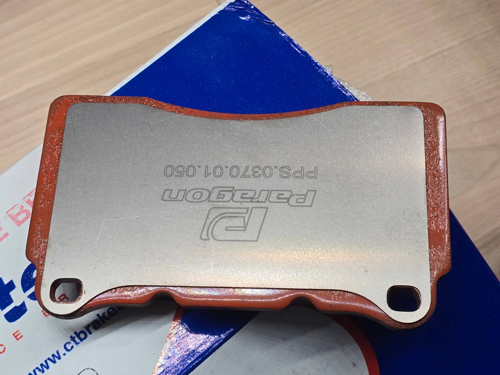

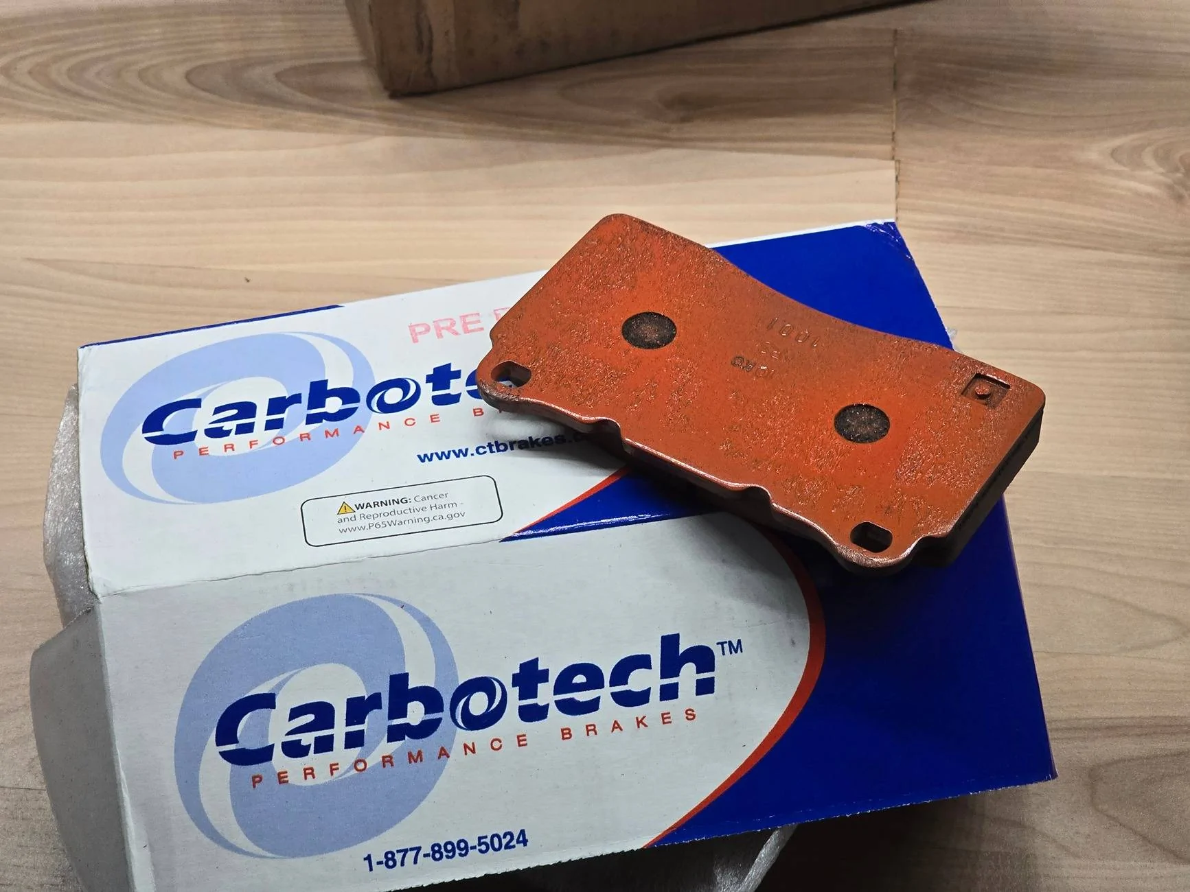

Carbotech xp10s came in! These pads will match up well to a 300tw or 200tw tire. They could tolerate a 100tw semi-slick track day tire, but that'll push the edge with a car as heavy as the its. In that case xp12 would probably be better, and for a true slick like a Hoosier, pirelli, or Michelin, the xp24 or xp12 would be the right move. I've been running carbotechs for years and love them.
I've also got some wheels on the way that should arrive tomorrow!!

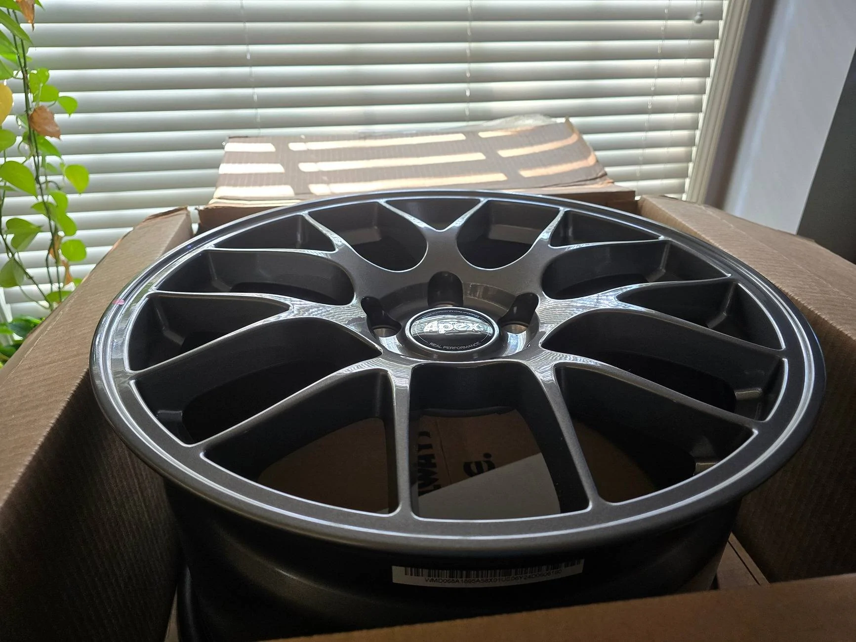

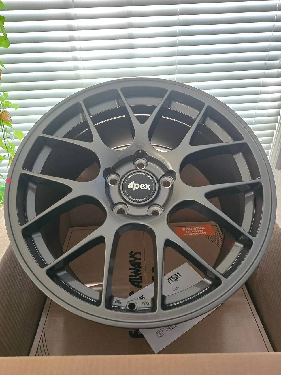

Winter and stock class wheels came in! I haven't decided if I'm going to do any autox. It's been about 4 years since the last event I did. I figured these wheels could cover it if I wanted to do it, but they'll also be awesome for winter.

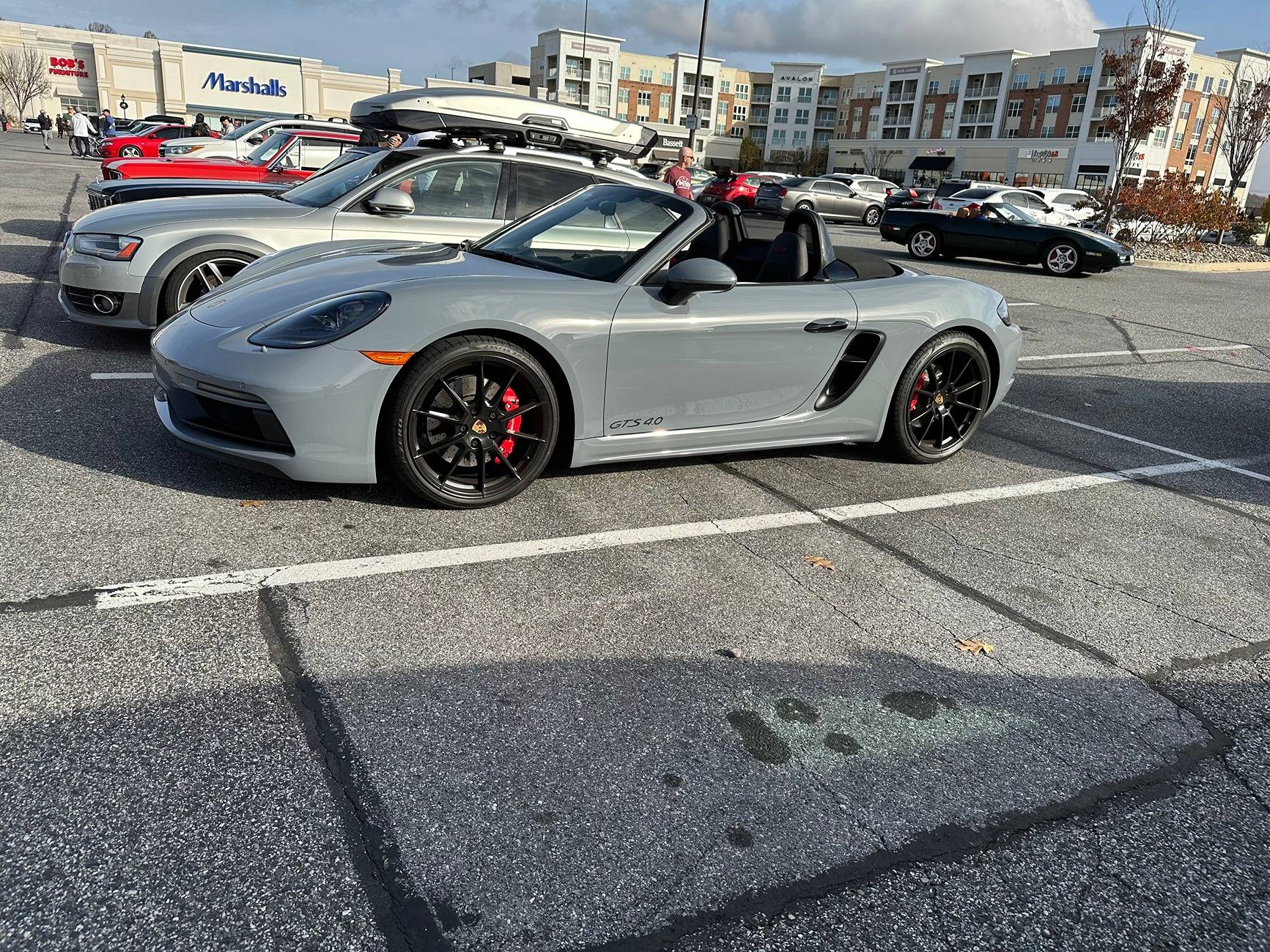

As for paint/hologram issues... again, to my eyes the paint on my car, as well as panel gaps/fitment, etc. has been pretty much perfect. I have zero complaints, so in that sense I appear to be on the lucky side... but the worst paint condition I've ever seen was the rear decklid on my brand spanking new 718 GTS 4.0. I didn't take any pictures of it because frankly, it was embarrassing... but the other side of that is Porsche paint quality is so good that the only way you could see it was literally under flourescent lighting; I didn't notice it until I was filling up at a gas station at night and the lights were reflecting directly over all the awful semi-transparent scratches.
The Arctic Grey colorway had a bit to do with it as well; it wore scratches and dirt pretty well TBH.

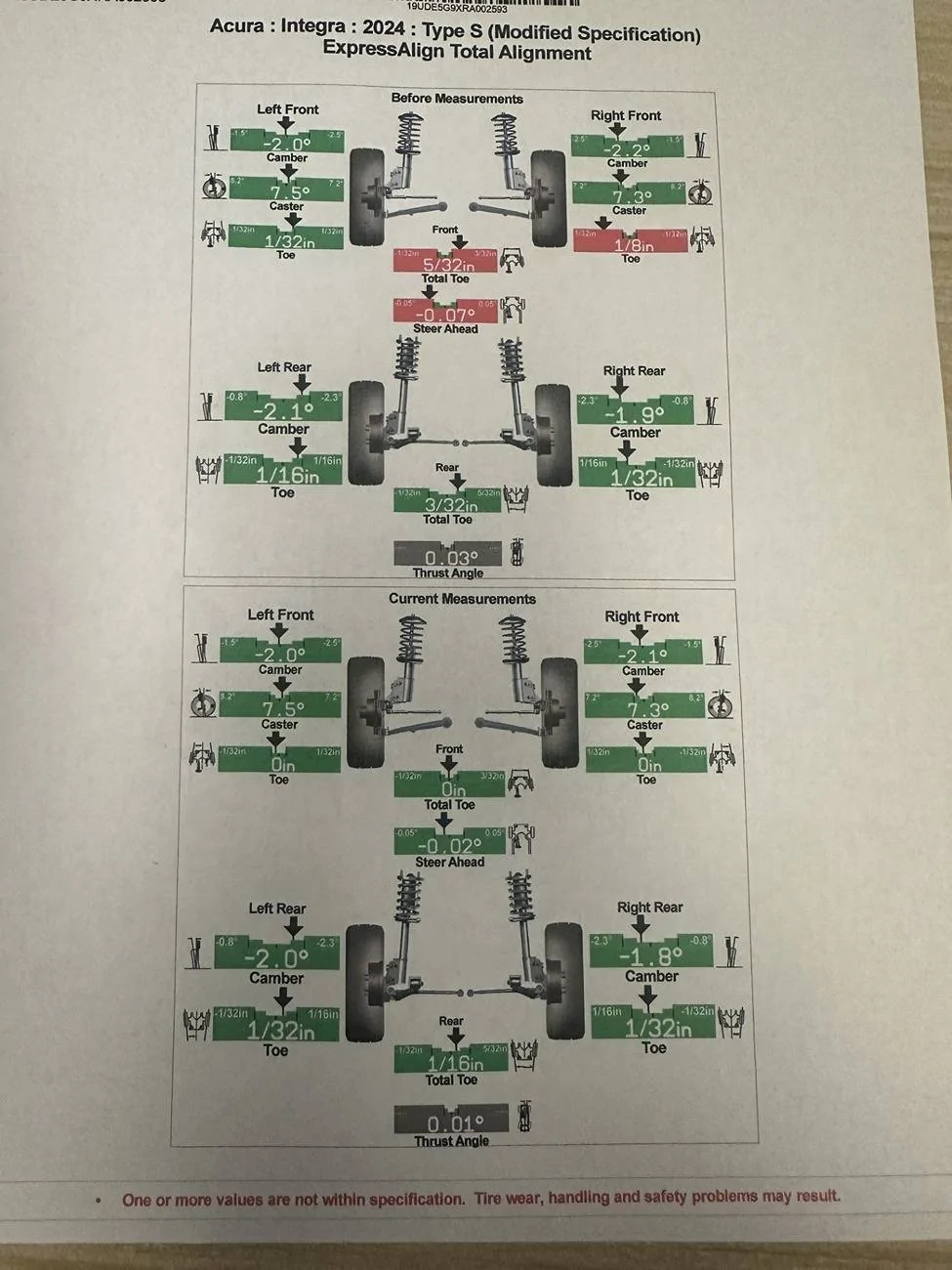

Looks like dealer is keeping the car another day, but they say they've fixed all the rattles! They told me the alignment couldn't be done yesterday for the rear toe, but I told them that's wrong (because I did measure it myself). They corrected today and got a final alignment in pretty close to the spec I wanted!! This is a solid setup for a 2-300tw tire. Car is almost ready for the 23rd! Just need to flush the brake fluid, now! I should probably test if one of my power bleeder caps will fit... Haven't even tried yet...
