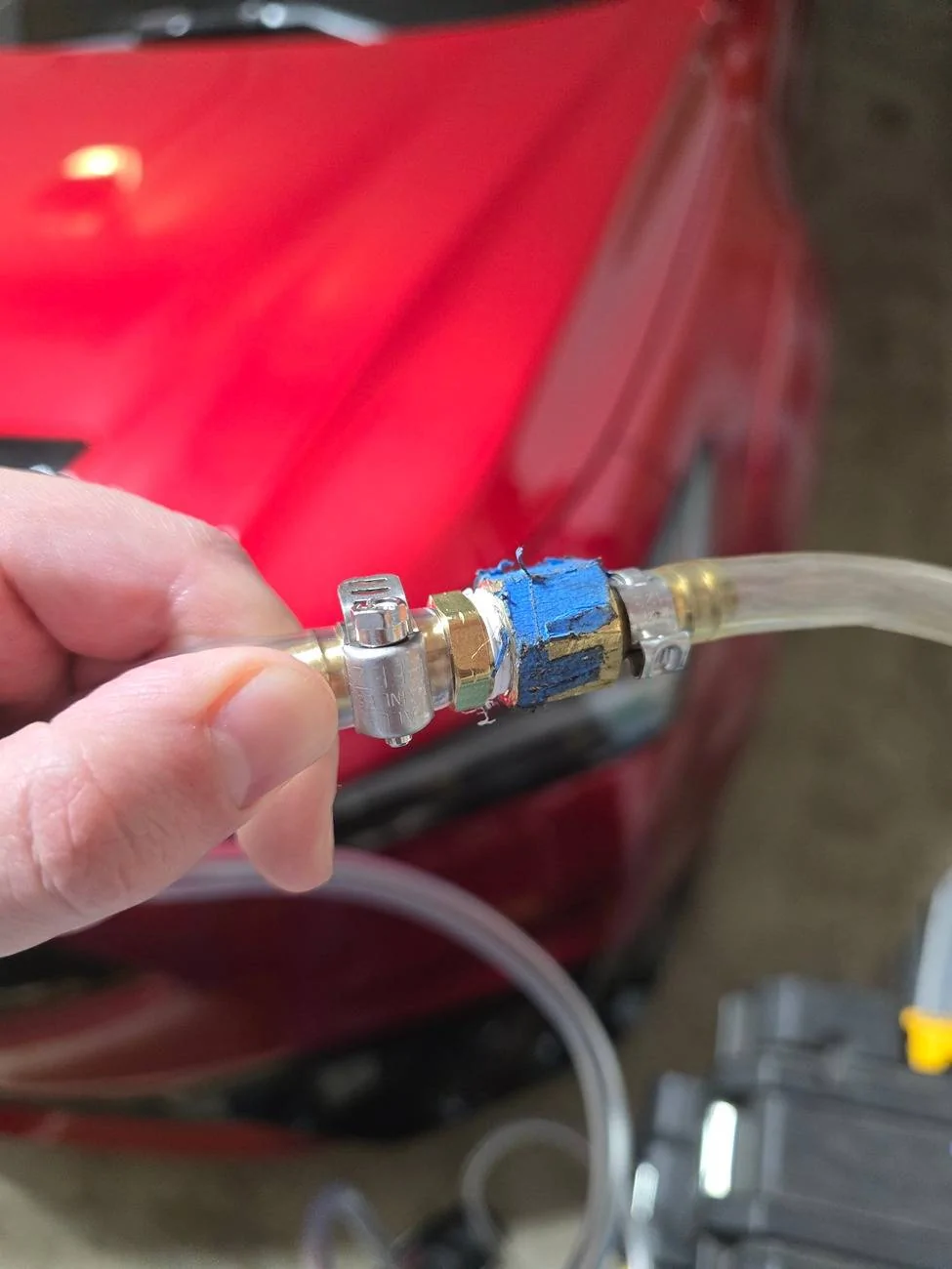

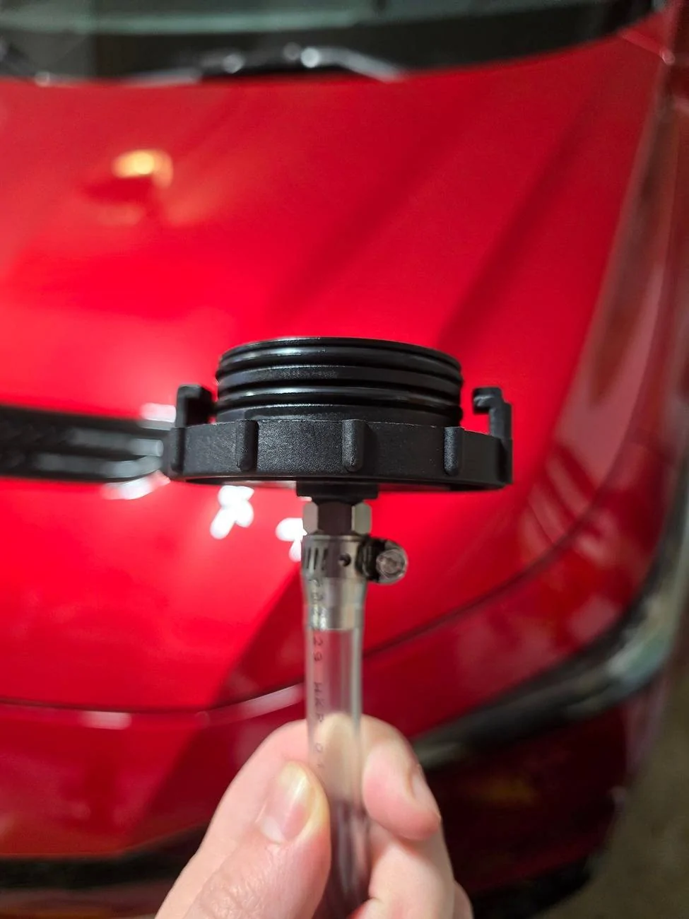

So turns out motive didn't have an acura specific adapter for their power bleeder. Instead I bought a top off Amazon, then some tubing and a barb to threaded fitting at the home depot racing. This will work just fine, but sadly the tubing is only vinyl and that is not great for passing brake fluid through. I only used my power bleeder for pressure anyway, so not a problem for me.
First time I pumped it up, it didn't seat properly and it blew off, throwing fluid everywhere. Yuck! Second time I tightened it up a bit more and it held 15psi fine. Should do the trick!

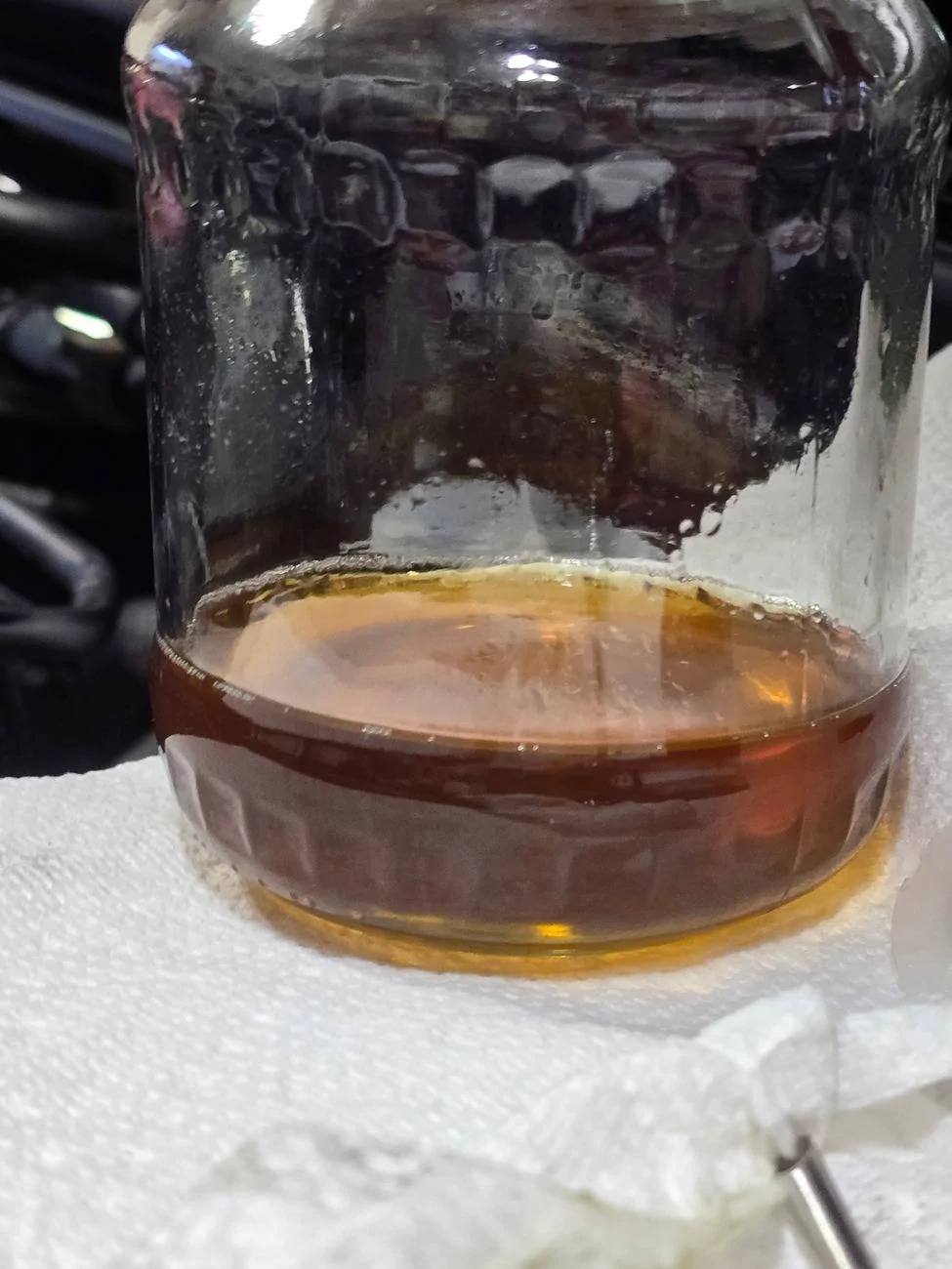

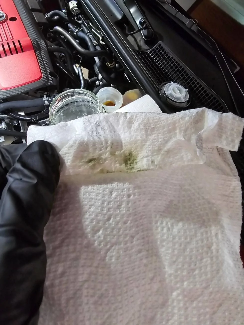

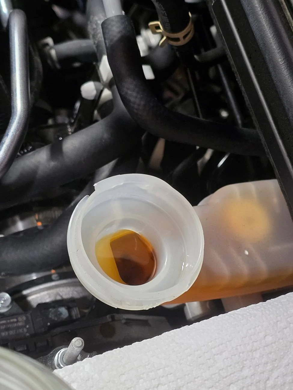

I got the carbotech pads on tonight. Several people want me to drive their cars and ride with them at the track, so not much time to swap pads there, especially for the first time on this car/caliper.
I had a few lessons learned, including the pin can't be easily pulled with needle nose like most other quick swaps I've done. It really needs a pin driver, or in my case a t30 holed torx bit. It was a pain to pull with the spring retention, but not the worst. Bleeding was pretty straight forward, but my factory fill was HORRENDOUS. It had a significant amount of deposit and contamination, color was like 2 year old fluid, and there was a significant amount of bubbles in most calipers, but especially the rear right and front left.
I also learned this clutch DOES NOT like any pressure on the mc to flush. It has to be done the manual way or possibly with a line vac. With pressure it just starts to suck air quickly. Once I got air in, it was a nightmare to get out, but lots of manual pumping with someone in the driver seat and it was done. Now that fluid has been changed there's a touch more clutch feel and the clutch action has moved slightly. It's certainly better than it was, and quick clutch action now grabs faster.
Photos of the factory fill... Yuck

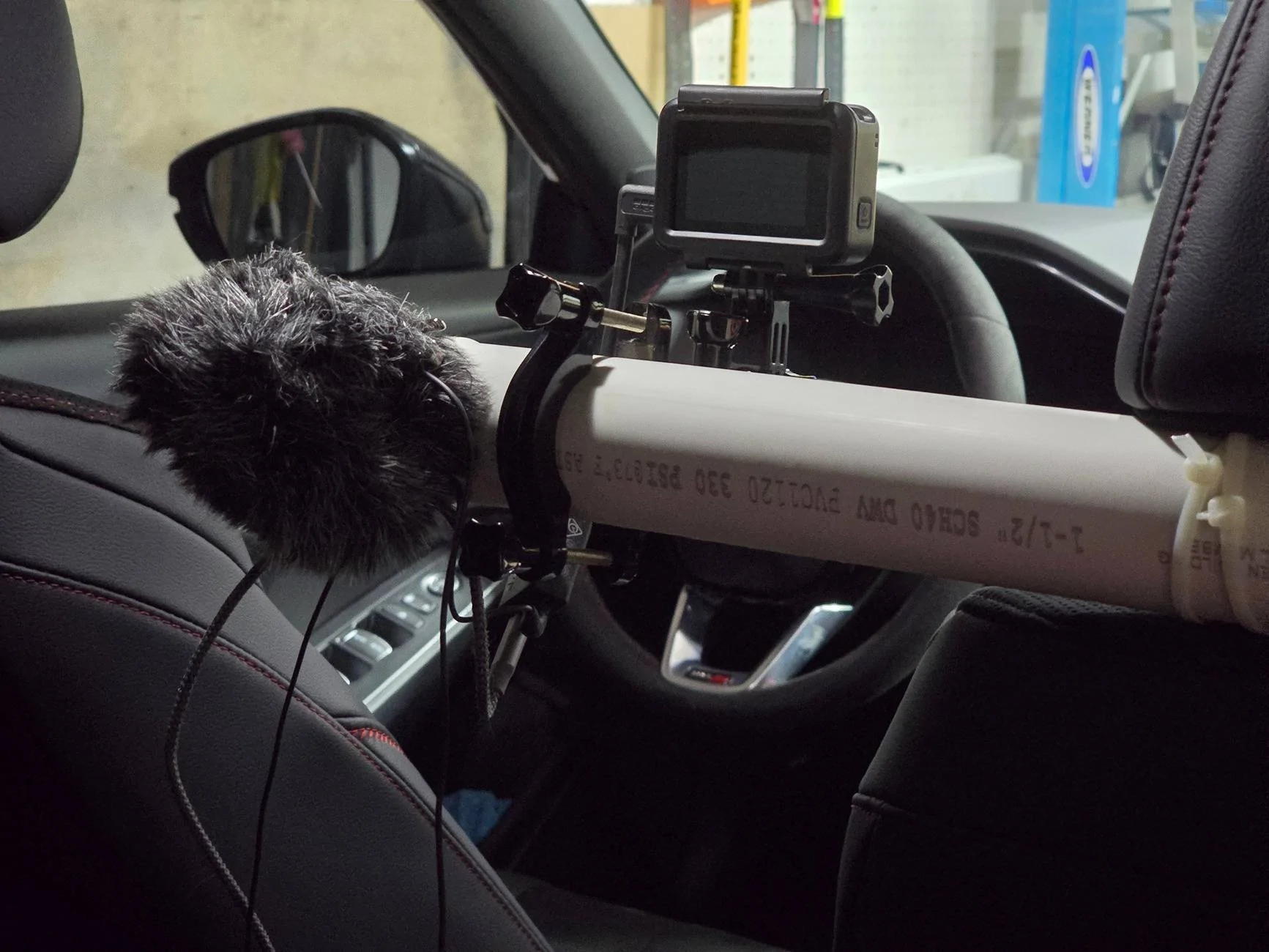

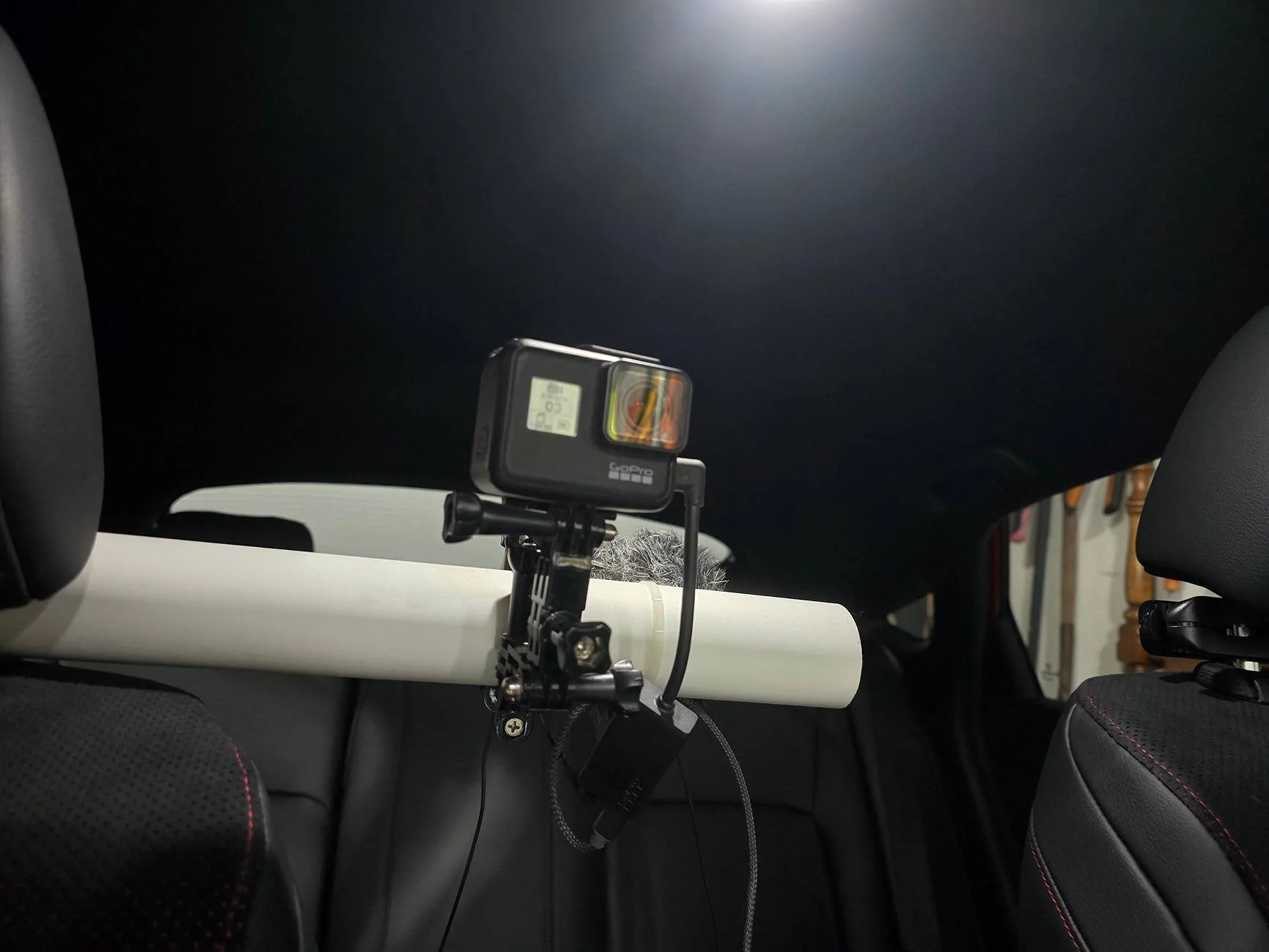

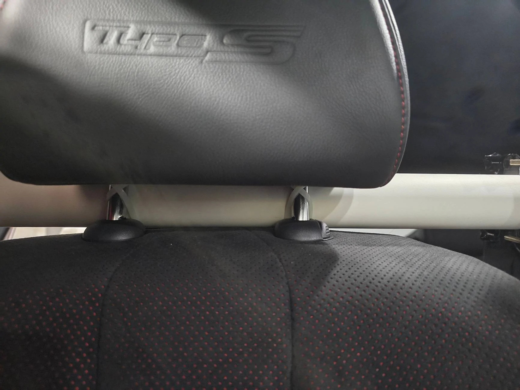

And @optronix , this is how I ended up mounting my gopro. The roll cage in my other car is 1.5" so I went with the same size pvc and zip tied to the passenger headrest. Seems okay right now, so we'll see how it does! I'm going with wide FOV instead of superwide.

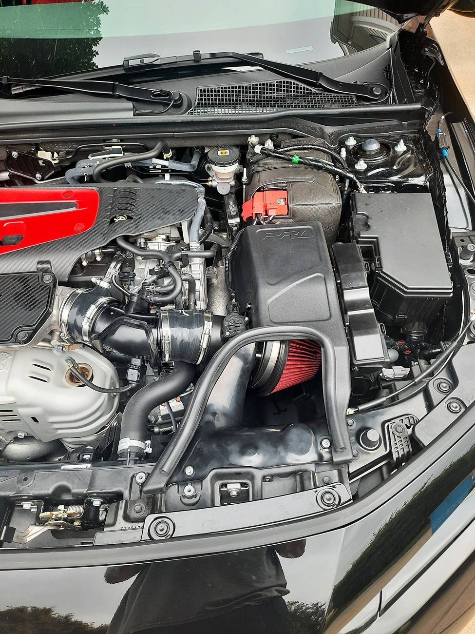

I like the ITS stock exhaust, but I would highly recommend the PRL HVI. Just burned 1/4 tank driving around whooshing and popping and banging 😃 Also you can see even if i had one of the pretty intakes, it would just be covered in pollen and dust like everything else under the hood.
Sounds like another adverse consequence of having the clutch and brakes share fluid. Nothing to be done about it, but is that your read?
Obviously track use is hard on the brakes and the fluid, but in my experience not very hard on the clutch - I think street driving is worse. Of the track cars I've had I've never changed clutch fluid until I had to have the motor out (for various issues) and changed the clutch preventively.
(I've changed clutch fluid on plenty of cars, but that was because they were old and there were symptoms. I'm not against it, I just don't think track driving should make it worse.)
Correct me if I'm thinking about this wrong.
