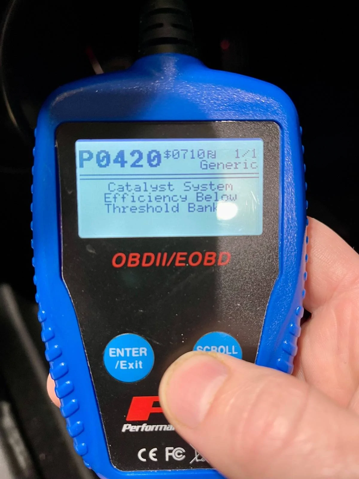

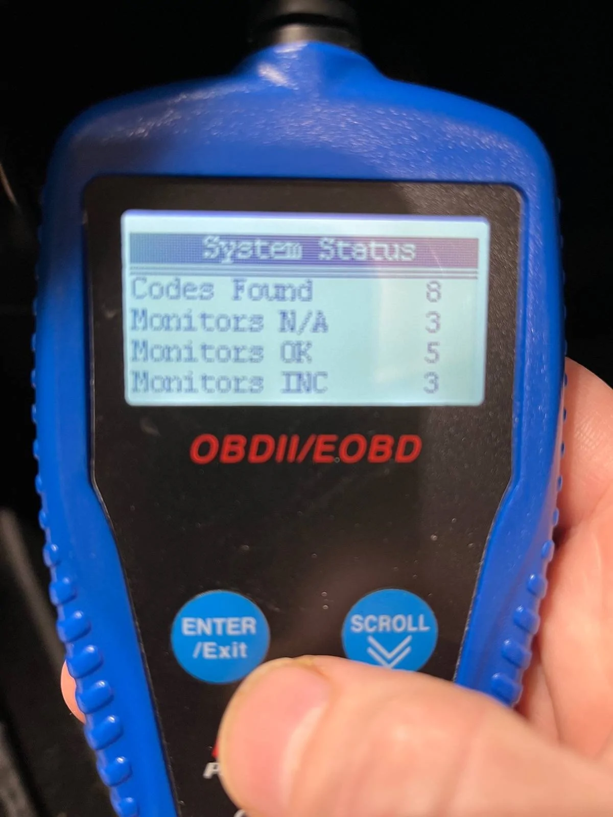

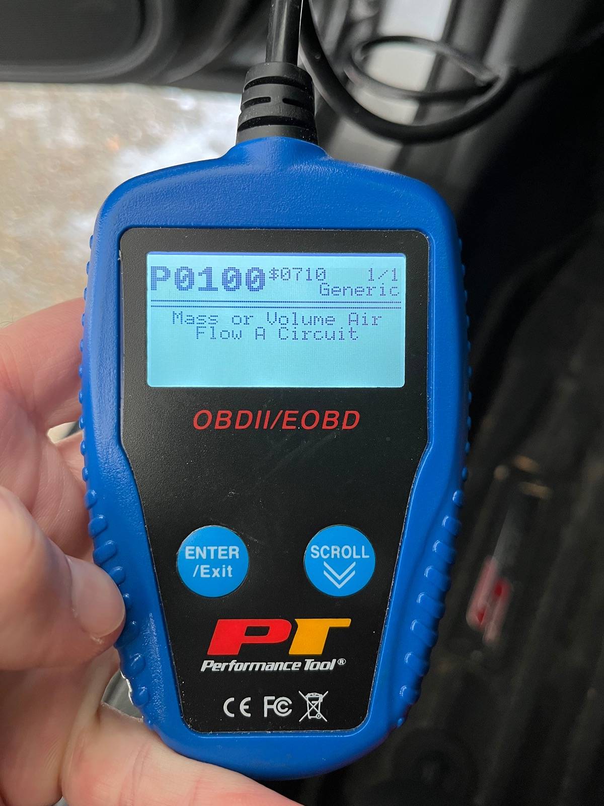

UPDATE!!!!!!
So I installed the PRL HVI this week..
Immediately when I went for my first test drive, I noticed the pops and burbles were gone again.
On the highway I gave it some gas and it bogged a bit (seemly more turbo lag than stock) and the CEL flickered on and off a few times and then disappeared. I noticed the turbo spool was ridiculously slow and the car definitely seemed ill. So, I limped it home and pulled out the reader.
I had 4 pending codes.

This was very strange indeed. I cleared the codes and Pops and burbles were instantly back.
went for a fun 15 minute drive and could still hear pops and burbles clearly over all the hissing and whooshing from the HVI.. everything seemed good.
Also want to make a note here that now my boost goes to 23 and prior to installing the HVI it maxed at 19 even wide open on the dyno so the MAF readings definitely control what boost the ECU will allow..
Next morning I go to work and pops and burbles are gone.. Car is still running great and no CEL. checked with reader for pending codes and natta. So I disconnected battery and let it sit overnight.
reconnected battery and had system initializing on dash and then it went to normal but the pops and burbles are gone. No code to clear this time and ECU reset made no difference.
Anyone have issues after installing the PRL HVI??
Was on fence about the jailbreak but at this point I am thinking I need it.

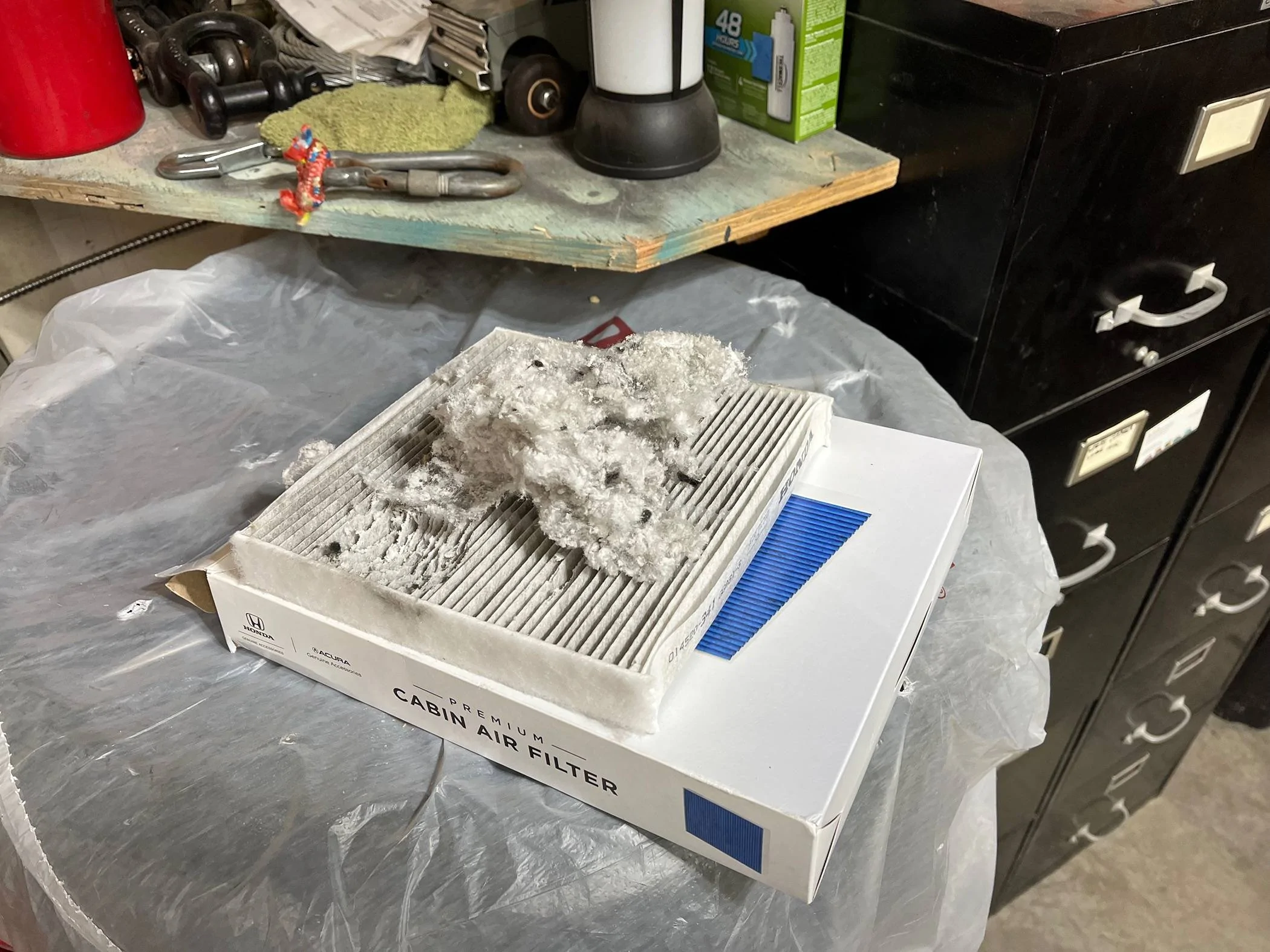

@bpebler Dude! Your last pic of your cabin filter explains it all. You have gremlins!!!
what the heck? ?
is your ECU still stock or jailbroken?
wonder if these mods are fine and no cel alone but once all stacked the ECU detects things are out of normal threshold. I think most people that already have this many mods already have jail broken ECU with tune to handle the higher A/F ratios.

Lol it’s unlocked. For about 9k miles with Derek’s TSP tune. Only thing new is HVI & charge pipes. He mentioned in the chat that the GESI cat in the TSP downpipe is typically clean enough to avoid that. Another in the chat said he’d get that code sometimes with the 27won catted downpipe. He said code wouldn’t always trip for him though. Hopefully the clearing of the code fixes it. So annoying. I’m support be doing Kuro install and new base tune Monday. But now I’m wondering if this needs addressing first.

Hmmm new MAF is $145 from Acura and $97 from alldiscountparts.
Might try cleaning it first. ?
What do you clean it with?

D-Rob did confirm that a dirty MAF would not give me my particular code of p0420.
