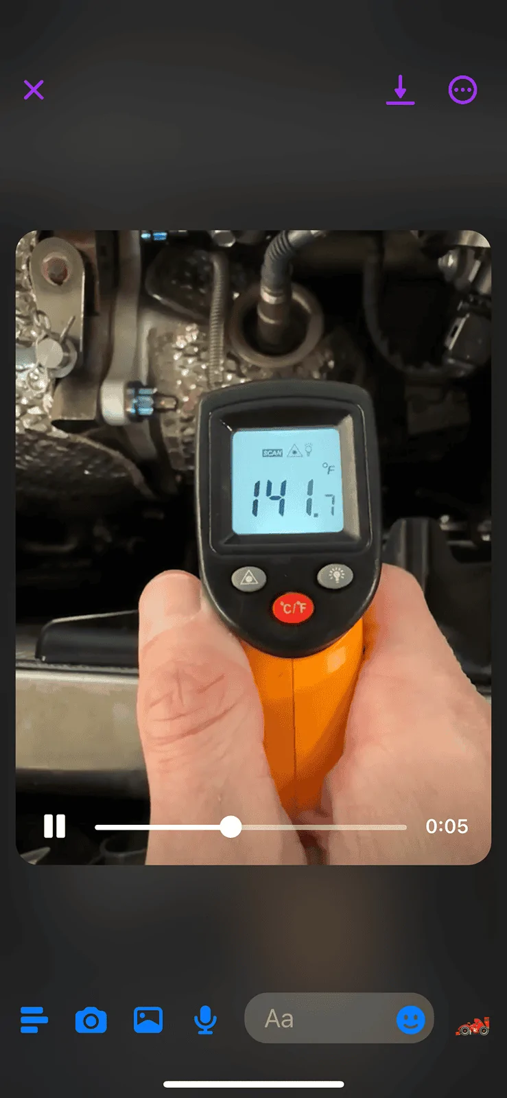

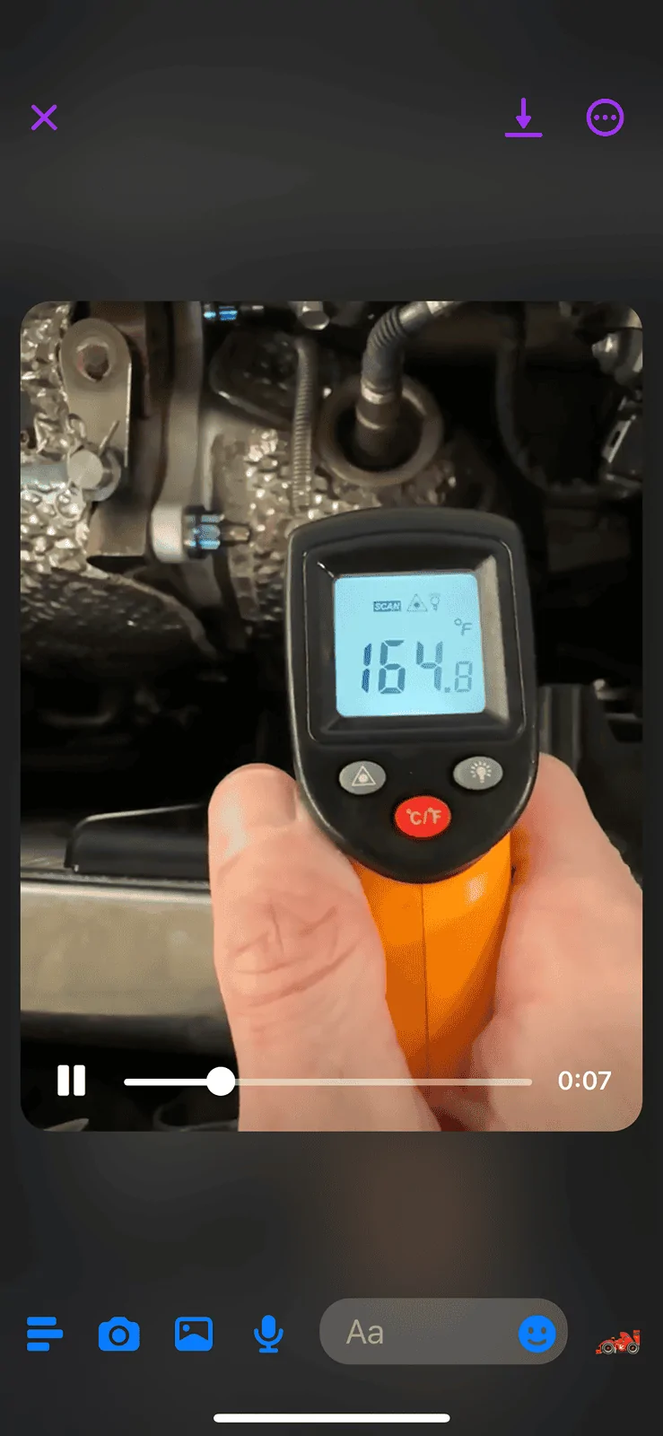

Yes, that’s what the new downpipe blanket will be like! Corey Poole measured some temps and it was over 100° difference to mine. I’ll look it up and post the photo back here when I can find it.
hmmm, that’s a good point. I DID think maybe the intake might’ve had something to do with it but not sure how really at the same time. I did downpipe, front pipe, RMM and it definitely made the car sound better without being annoying too. Lol
My FP should be in sometime this week, which DP did you go with? The RV6 has me clearing codes almost every other day. The supposed fix for my particular issue is to screw the defouler in further, which is why im looking into blankets, cause if I cant turn it while its installed, ive gotta take that bitch out again LOL.
Looks like you did a pretty good systematic job of installing groups of parts that went in together, wish I'd known better LOL.
Found the pics you mentioned in the charge pipes thread, those readings are ridiculous!!

Crazy low temps! I did the TSP downpipe bc I didn’t wanna mess with cel and defouler stuff.
