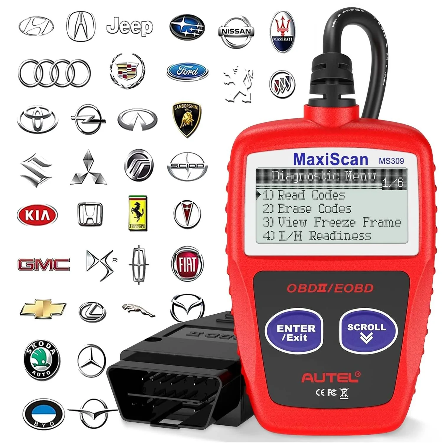

What do you have? I've had a super basic one like this for a long while now. I just use it to read and clear codes and I'm not sure what I'm missing out on vs the nicer, more expensive ones.
Acura Integra Three stages of DTC in regards to Pops and Bangs 7165rMIRi0L
Good call on keeping it in the car though -- I'll stow this in the integra from now on.
Mine is about the same thing! Same size and same looking menu, just blue and "Performance Tool" brand. I need to get a better one to deal with the e brake for changing the rear pads though.
