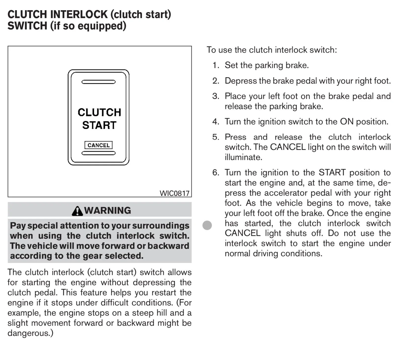

My 2017 Nissan Frontier has a “Clutch Start Cancel” button that allows it to be cranked without putting the clutch on the floor.
To be honest I really don’t understand its purpose. I suppose if the engine was disabled you could use this button and crank it in gear to have the starter try and move the car out of harm’s way. Maybe in a real dicey 4-wheeling situation you could crank it in gear so there is assurance that you won’t roll back (or forward) even a micron.
Edit: It appears it is for wheeling situations:

Yes, for 'wheelin'. You actually use the starter motor to move the vehicle rather than the engine.
