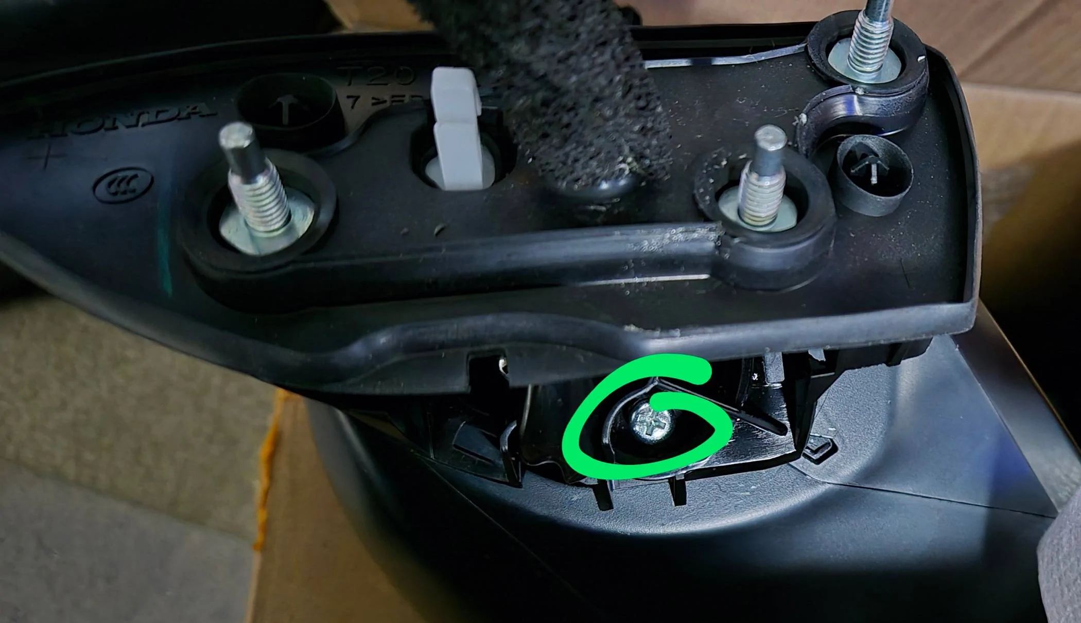

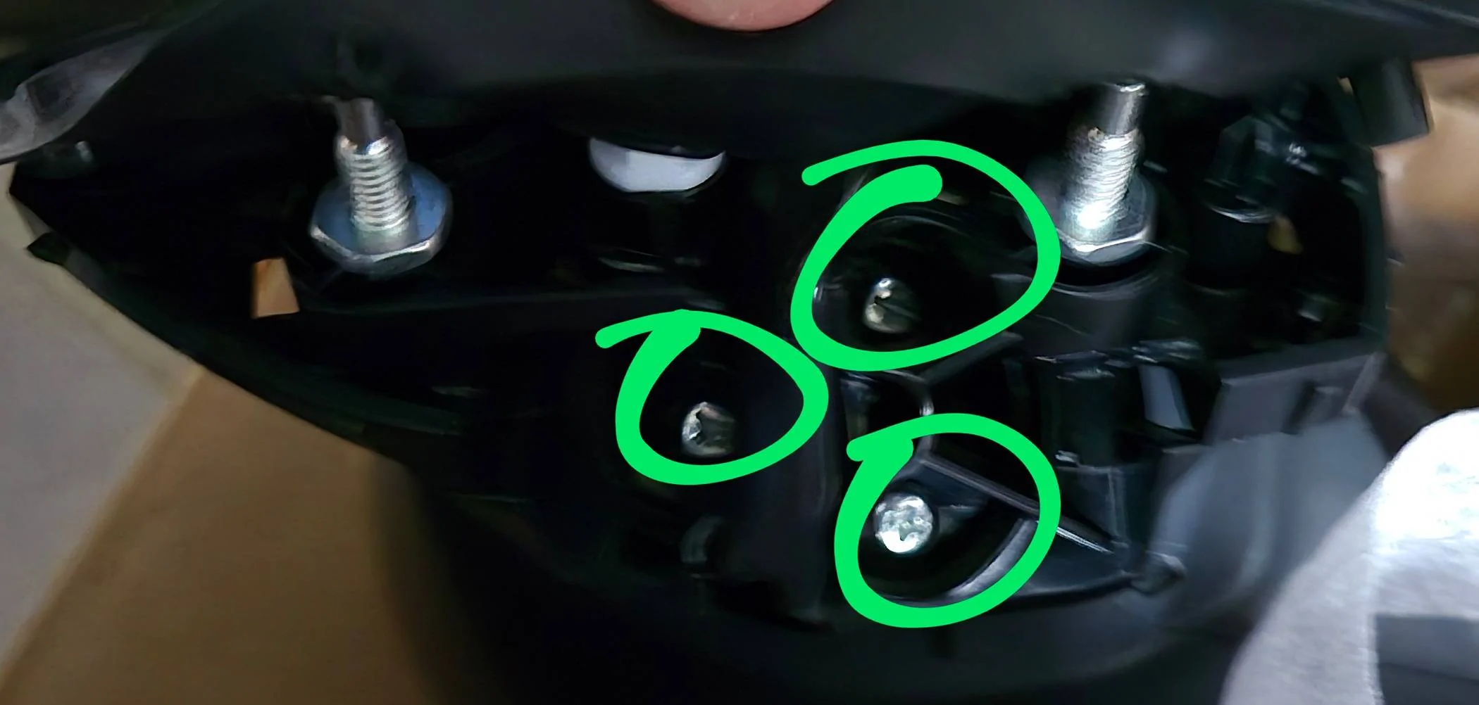

I haven't installed them yet so I can't say for sure how the image is comparatively speaking. I didn't take any pictures, but let me know if there's something in particular you'd like to see. For now it would be pretty easy to get a picture of just about anything related to the black plastic removal.

If you have time, if not no worries. But, I would be grateful to see the part you mention about pulling off the rubber gasket and removing the screws. That is the part I am really having trouble understanding without the kit in front of me. Not sure when it will arrive

Here are a couple pictures of the rubber gasket.
Acura Integra DIY Power Folding Mirrors: a journey 20240418_090041~2
Acura Integra DIY Power Folding Mirrors: a journey 20240418_090054~2
