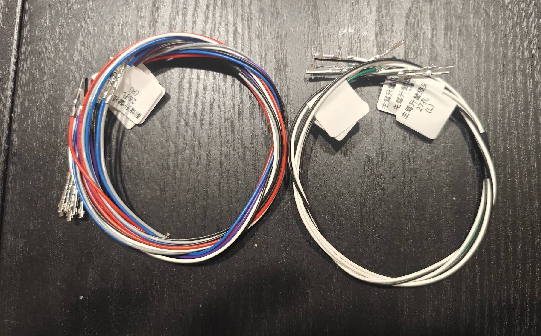

Some things I learned during this install which are specific to the F Kit (and may apply to other kits)
- The green wire has a different connector on either end. Make sure you do not plug the wire in backward because depinning these connectors can be a PITA
