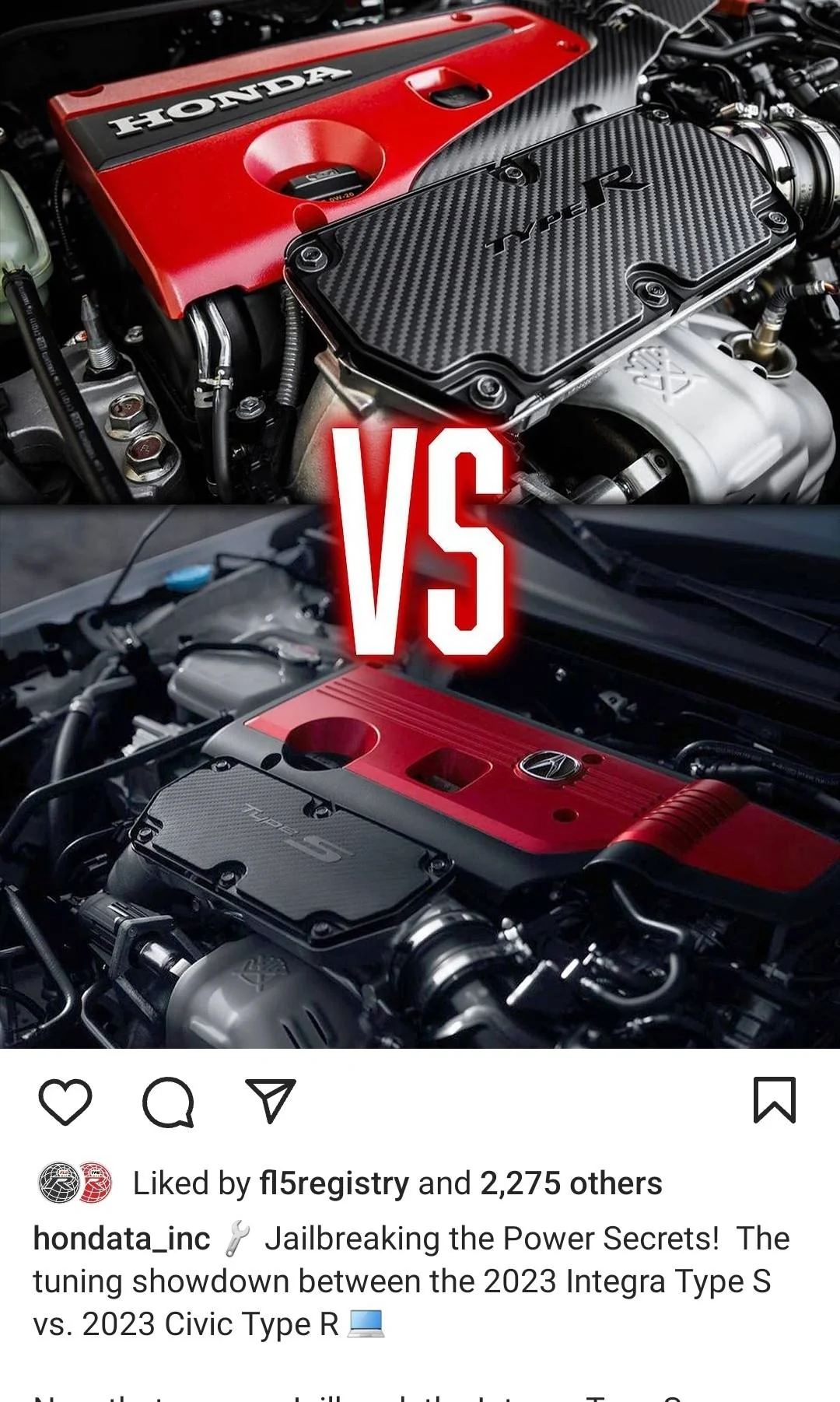

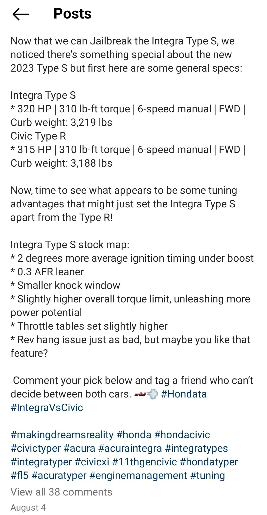

Also interested to understand why the delta of the 91octane tuned FL5 is different than the Type S? Even though they have different engine codes I was under the impression that they were mechanically identical?
As far as I know they are identical. At least from a part number perspective. I posted the below on the other forum in July with respect to my take on why the ITS made more power on the dyno than the FL5 in Savagegeese's test at King Motorsports:
All 38 components of the turbocharger and supporting hardware are identical with the exception of turbo joint pipe resonator which is the black oblong shaped part stamped Type S/Type R. The usual power adding suspects are identical: camshafts, cylinder head, pistons, connecting rods, and fuel system. I'm inclined to believe the power difference is largely from tuning and NOT hardware. I realize the exhaust is also different but I believe that to be immaterial from a performance standpoint. The ECU calibration on the ITS is likely running more ignition timing than the CTR which is why it appears to make more power on less boost. I'm certain we'll learn more as time goes on.
Hondata confirmed as much and more weeks later on IG (see below). I get the dyno results for the DE5 and FL5 were not performed for the purposes of internal validity (i.e., controlled test), but once tuned the numbers should be quite similar and they're not.
Acura Integra Hondata releases Flashpro for Integra Type S tuning Screenshot_20231002_204505_Instagram
Acura Integra Hondata releases Flashpro for Integra Type S tuning Screenshot_20231002_204530_Instagram

Great info! Interesting to see that stuff. :thumbsup:
I wonder if this means some of the Type S variables (leaner AFR, timing, torque limits) aren't being carried over to the FL5 custom tunes? Or perhaps the exhaust difference in the Type S is actually more impactful than initially thought?
