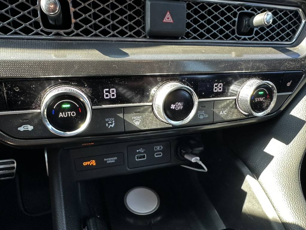

Anyways, The HVAC controls in my '24 Type-S have only showed the driver's and passenger's temp settings while auto is enabled. It does not show how air is flowed.

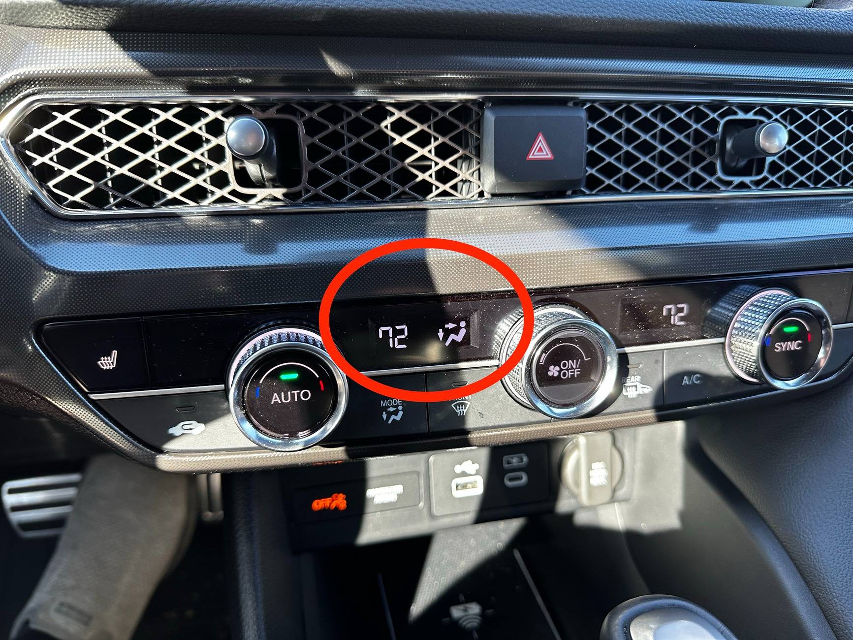

Yet the '25 A-Spec actually shows where air is being directed while in Auto.

So have I found another issue, this time a little less than 2yrs after delivery, or is it normal Type-S behavior?

Hey all, long time no talk. I've been wondering about this for a while but didn't decide to query the hive mind until I got an A-Spec loaner from the dealer last week so they could exorcise some of the continued rattles from mine.
Anyways, The HVAC controls in my Type-S have only showed the driver's and passenger's temp settings while auto is enabled. It does not show how air is flowed.
Type-S HVAC controls do not show air flow when set to Auto
Yet the A-Spec actually shows where air is being directed while in Auto.
A-Spec HVAC controls do show air flow when set to Auto

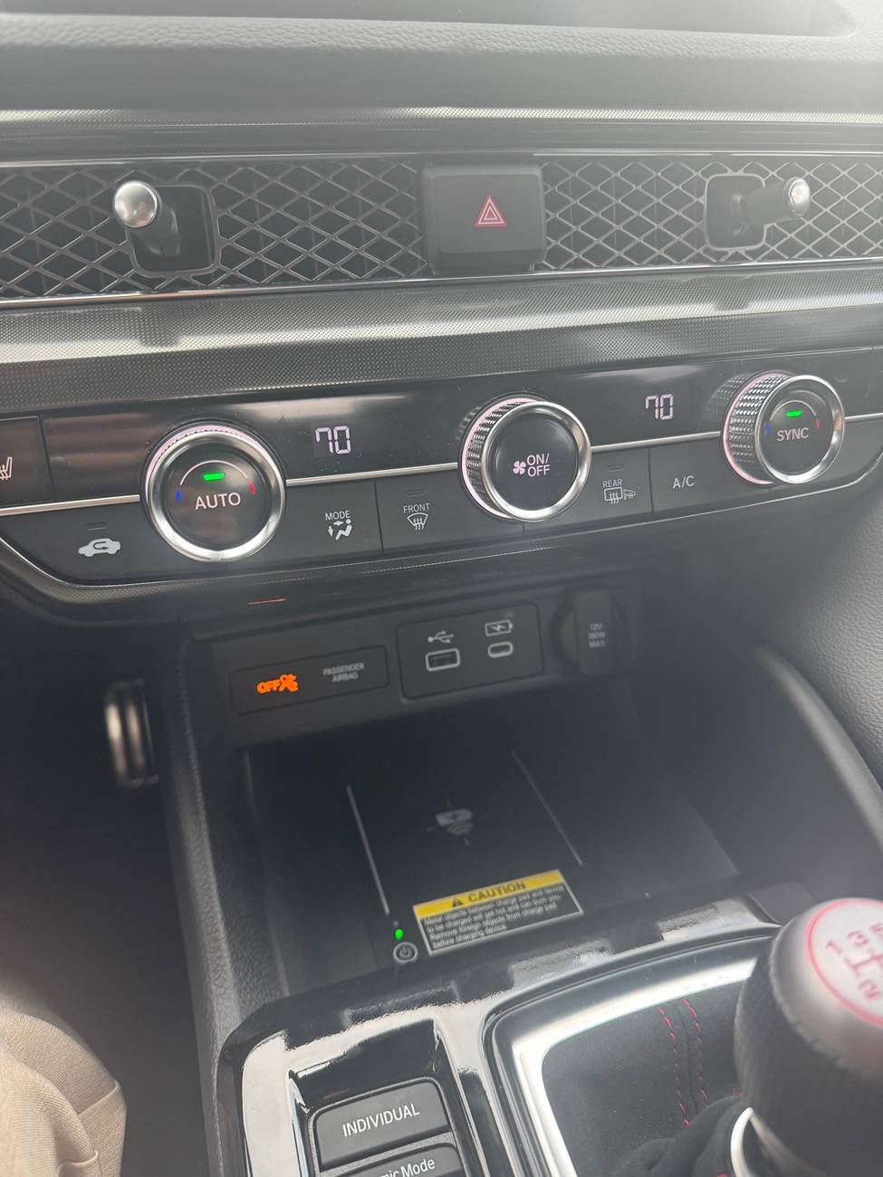

Also confirming that my climate control reading only shows the temp unless I switch to manual. Looks like the A Spec shows the fan speed while in auto mode as well. Since we're hyperfocusing a bit here, I think I prefer the more simplified readout of the Type S. Set the temp and the car makes it so, no need to tell me how that's being achieved.
