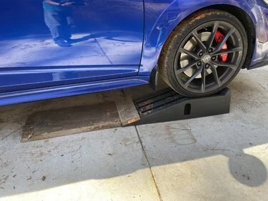

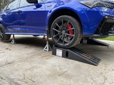

This is just my experience so please anyone chime in. I looked at ramps from Amazon but none were wide enough and had the low clearance for the ITS. The only one that would work is Race Ramps and also using their extenders since I lowered the ITS. While they are more expensive, I thought the quality is excellent. But they are bulky so need space to store them. I am also very cautious when using them and never got the car to the highest point.

So I used their online calculators and bought the RR-XT-2 67". But I did not take into account the plastic ledge on the front of the car (you cannot see it unless you look down). So the ramps did not work unless I bought the extenders, which is the RR-EX-14. So I spent more money than I needed. I would use the calculators but make sure you account for that ledge.
Also, the ramps I bought can fit up to 12" wide tires, while the 72" only up to 10" wide. I choose the 12" wide so that the tires don't hang on the ramps. Maybe investigate the 80" option since it can also accomodate up to 12" wide tires.

Like @ckone2030 mentioned. The front end lower lip will drag on factory suspension. You will need the extenders with the 67" set. I have the first gen where it's a single piece. It does make oil changes a breeze.

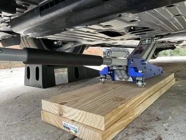

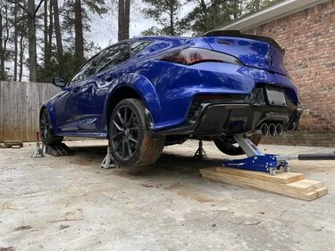

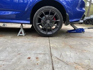

I know there was some discussion about jack points on the car so just listing what I did in 5 minutes to get the car high enough to do the downpipe, front pipe and RRM..
1st. up on ramps. (I use some old boards to clear the bottom of bumper)
2nd. jack rear and put on jack stands near lowest setting.
3rd. I use some cut 2x12's and give that jack the lift it needs. this will bring the rear above the front on the ramps.
4th. I use the same 2x12's and now lift the front.
5th. Take out the ramps, Prop it on the front jack stands and then put the ramps back but backwards.
now you have plenty of clearance
