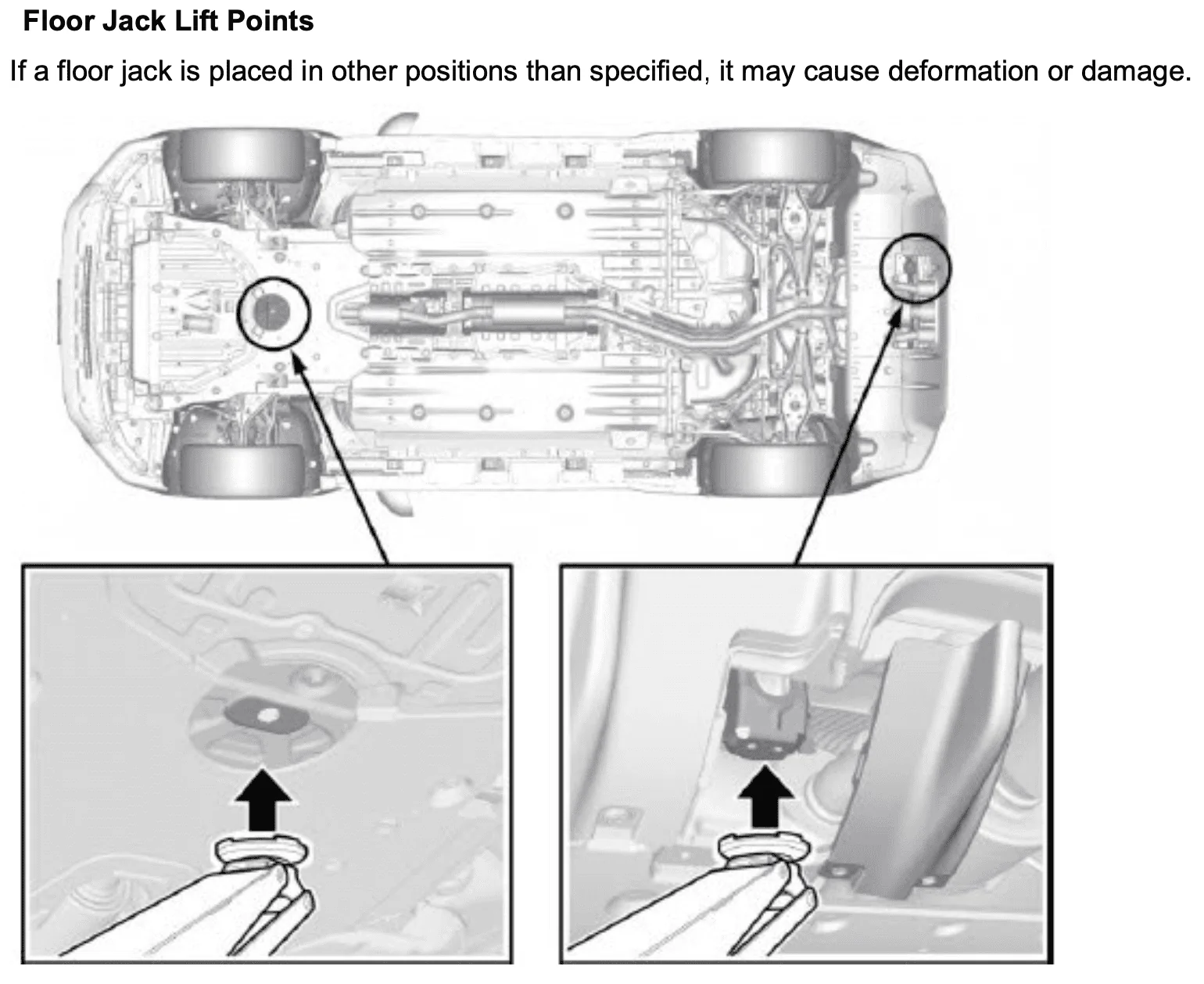

The front floor jack point is so far back that it’s pretty difficult to get to even with a low profile jack. If the car is lowered, then even harder.
I came across this exact scenario that OP is addressing for the Po people when I was planning to install my front pipe and RMM and found out I wasn’t going to be able to get to that front floor jack point.
Acura Integra Jack points and stands.  for us Po' people 1712290486964-n9
