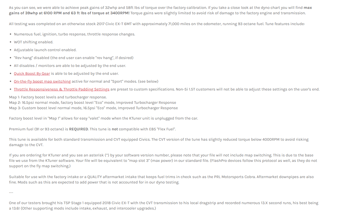

Sweet. Did the tune change anything CVT related (“shift points”, etc) or did it just change the engine tune?
Also how do tunes work these days with different drive modes? Is the tune just in normal mode and sport and comfort are the factory versions? Or does it eliminate having different modes and no matter which you’re in it’s all the same tune that overrides them all?
To me doesn't feel like it changed the fake shifts. Could be wrong, but overall you can definitely feel the increase in whp and torque.
Here is the tune description on their website to get a good idea of it and how it would work. Eco with this tune does change things depending on the map
Acura Integra Official: 2023 Acura Integra Full Pricing & Availability (June 2022) Released! 1653369699442
