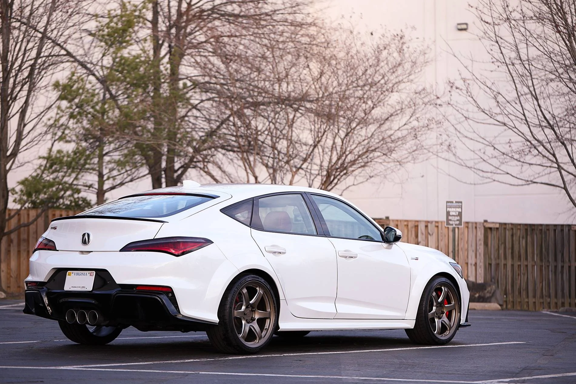

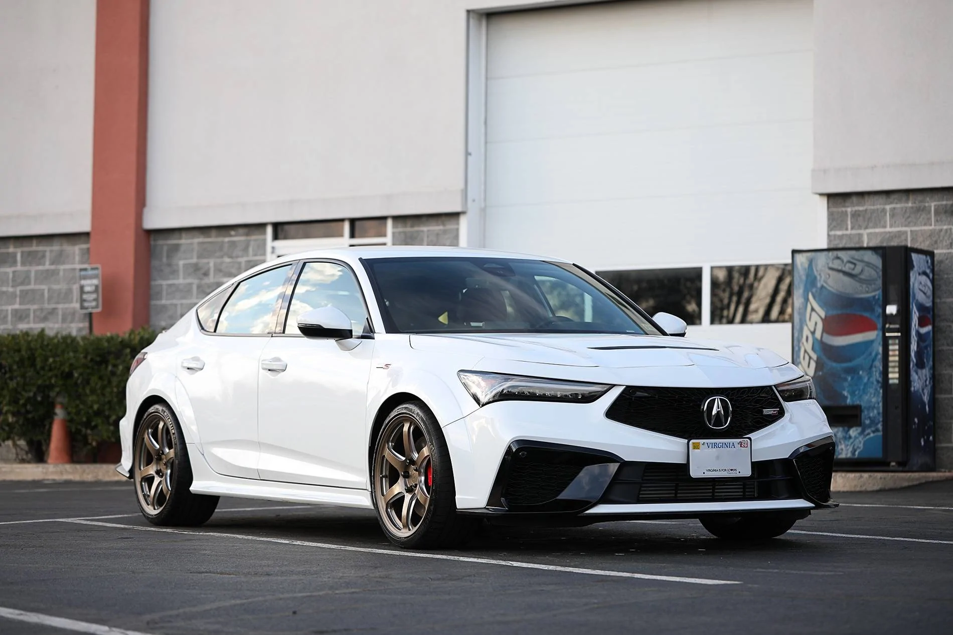

Looks pretty good- and I'll also note that this offset stays within bounds for SCCA street class (+/- 7mm or 1 inch diameter), for anyone interested.
I like this style but I don't know how 19x10.5" ET45 fits. I want to stay at 19s too since I think it looks better than the 18s on the DE5

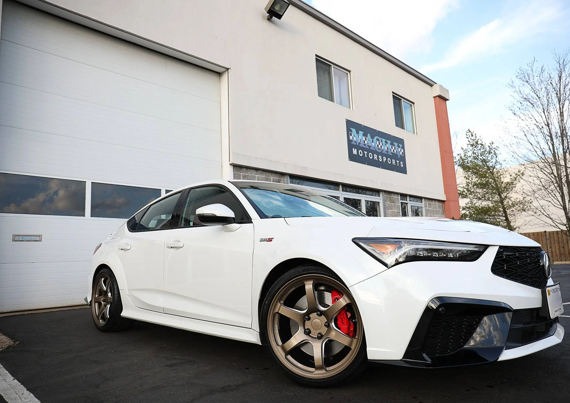

This would fit but with a 30 profile tire only.

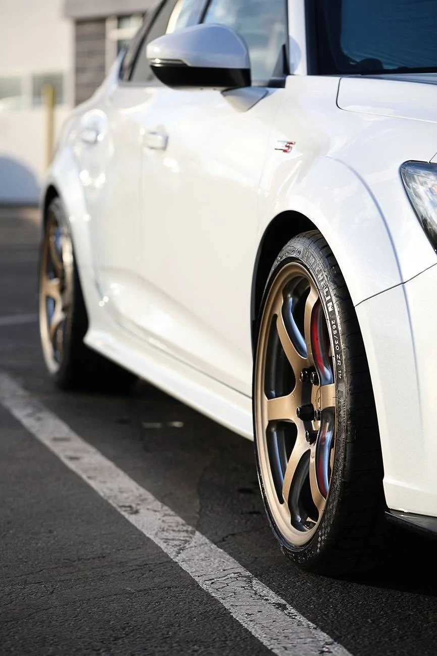

Titan7s
19x10.5 +49
295/30/19 MPSC2s
Eibach Pro-kit
No rub
