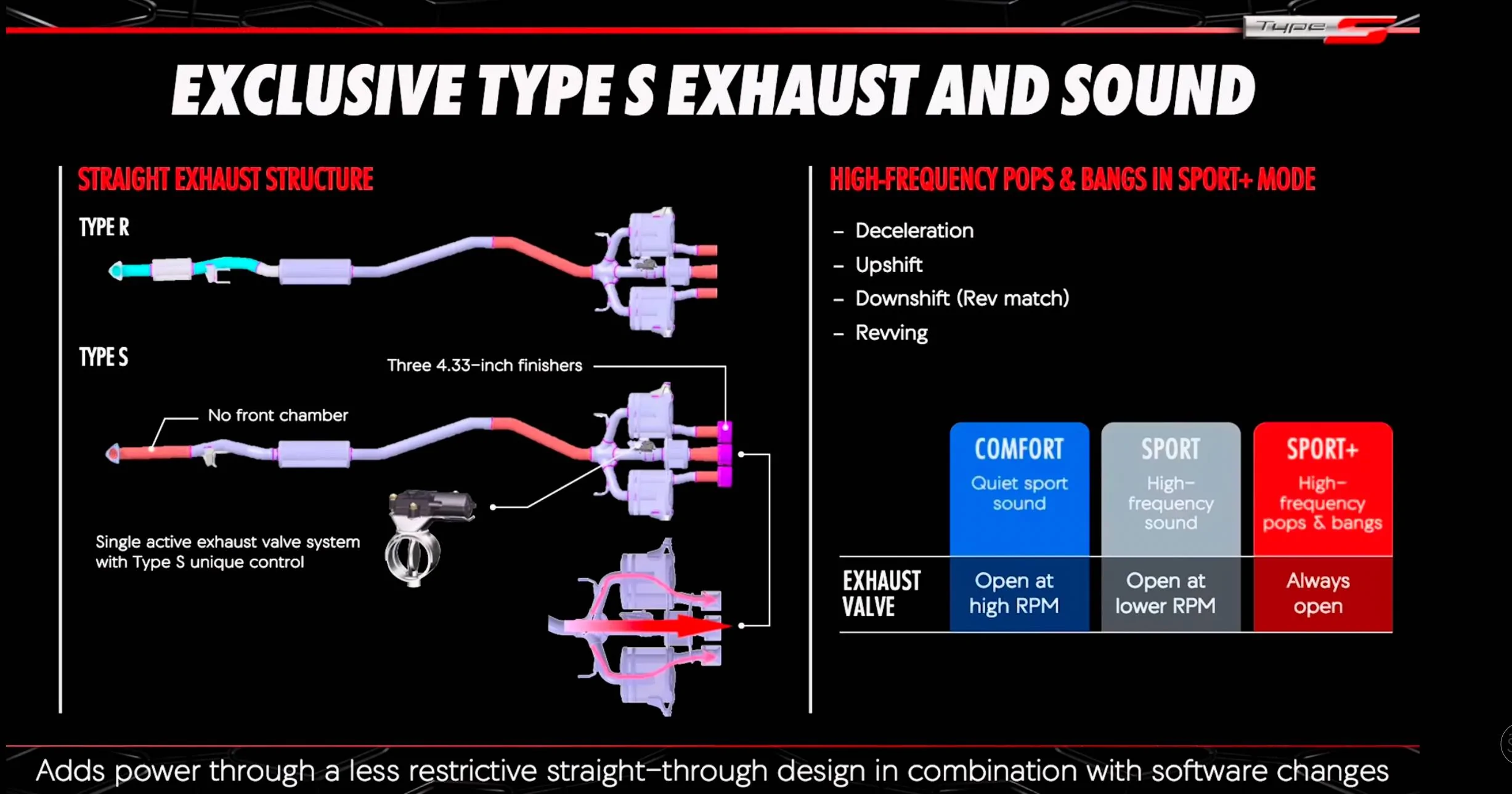

alright - so who is going aftermarket? anyone know if the CTR systems will fit on our cars?
The CTR has a front resonator whereas the ITS does not. To my knowledge there's no other mechanical changes between the two.

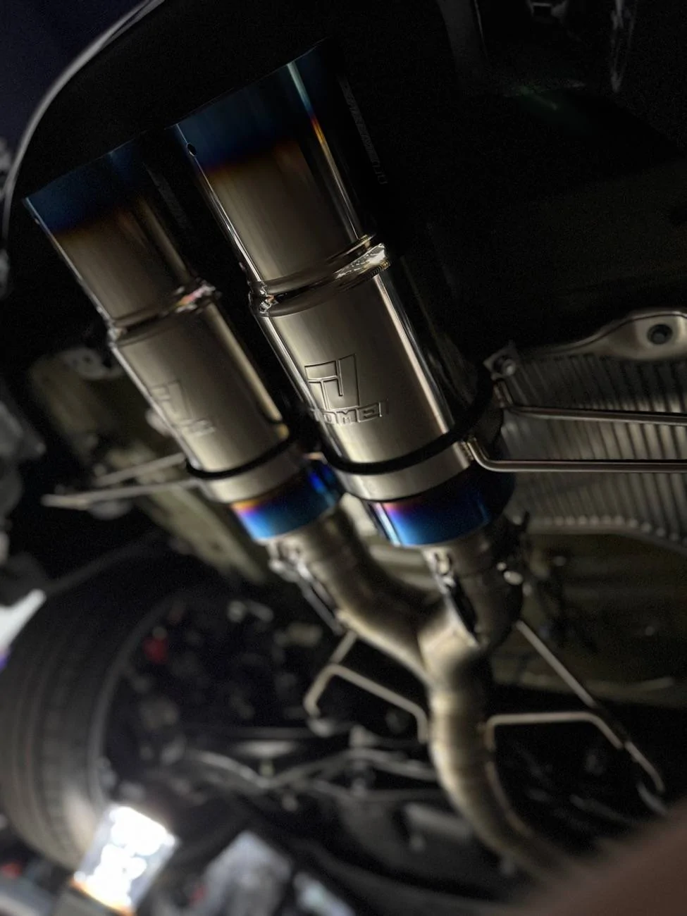

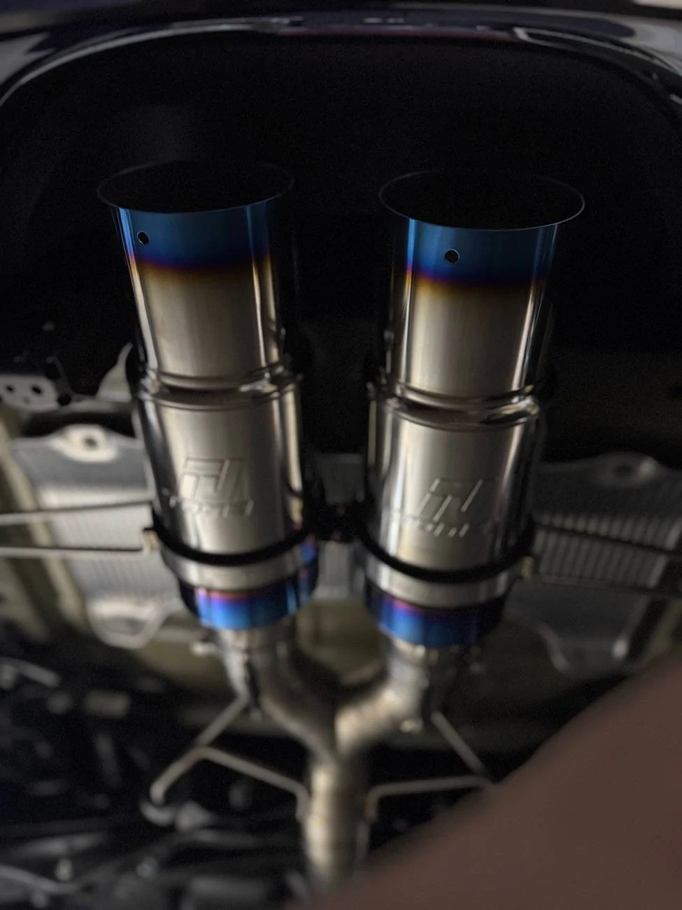

I’ll record a video tomorrow…. Sounds better than what’s out now for the DE5. Shaved weight, all titanium and it’s Tomei what else can I say lol… only downfall is the drone at lower speeds/higher rpm 2-3k. But that’s the usual with Tomei exhausts. It’s loud AF… but sounds amazing. If you want a sound clip go look up FL5 Tomei Type D sound clips on YouTube. It’s the same exact sound due to being the same power plant.
