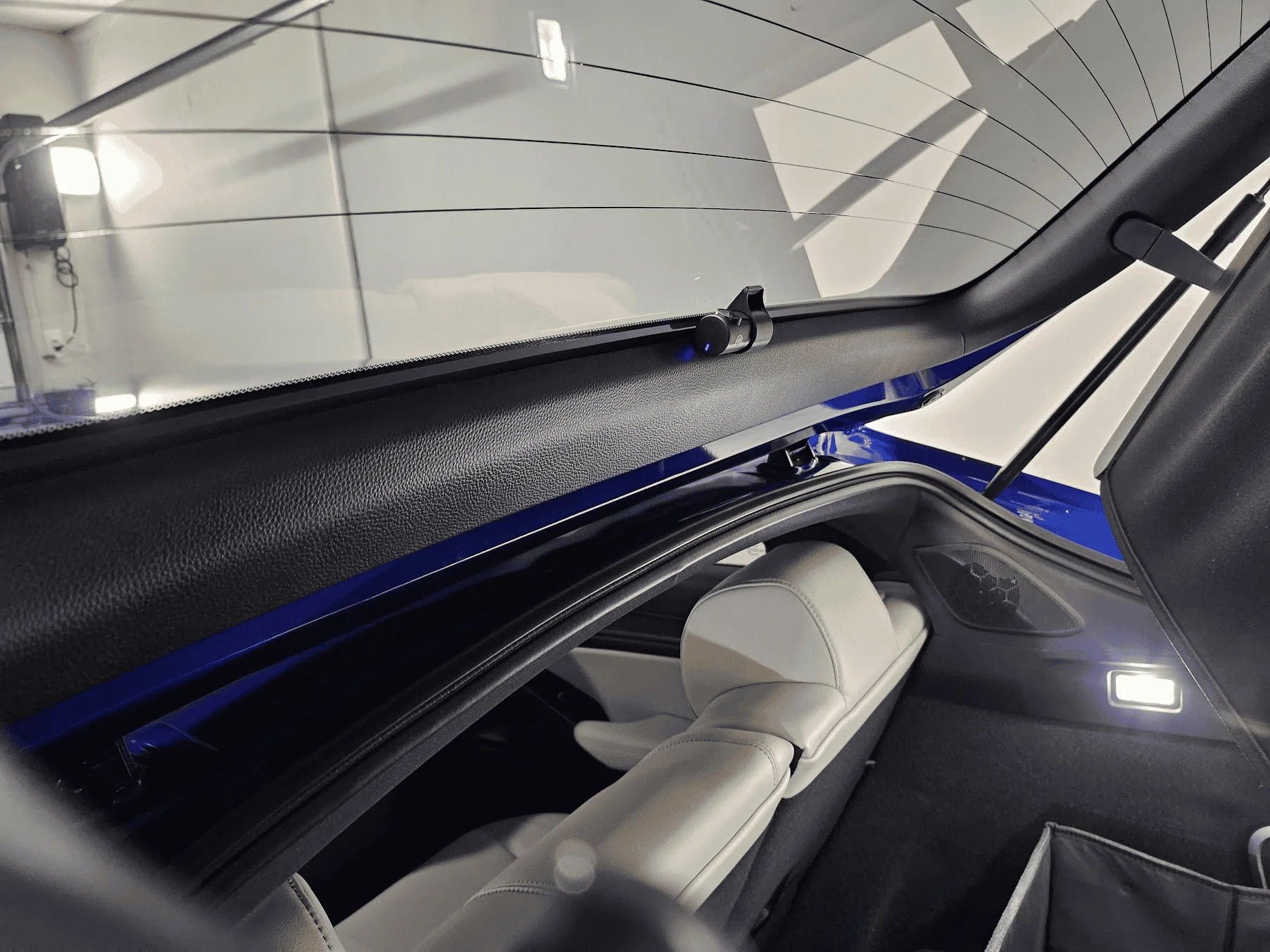

This might be the easiest solution that doesn't involve routing wiring in a way that leaves enough slack for the hatch to open, etc.: https://www.thedashcamstore.com/custom-metal-mounting-bracket-for-adhesive-dashcam-lenses/
A Reddit user says they used this in their 2022 Civic Hatch here:
No pictures of the finished installation with this clip though, unfortunately. The pic in the post is from an attempt to mount the rear camera to the window.

mine is sort of messy because I didnā€™t go and wire through the little cable area, I just went up the weather stripping to the trunk and from there into the window with some slack shown. When the trunk is closed there is a little bit of extra cable just sitting behind the dashcam.

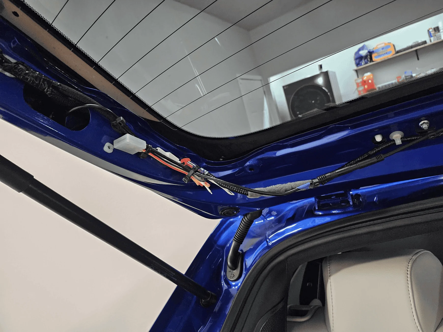

I did my fitcamx front/rear install recently and I also used that grommet. Takes a bit of patience to get it through. I'd recommend applying some silicone grease. I also installed a third light blinker while I was at it.
