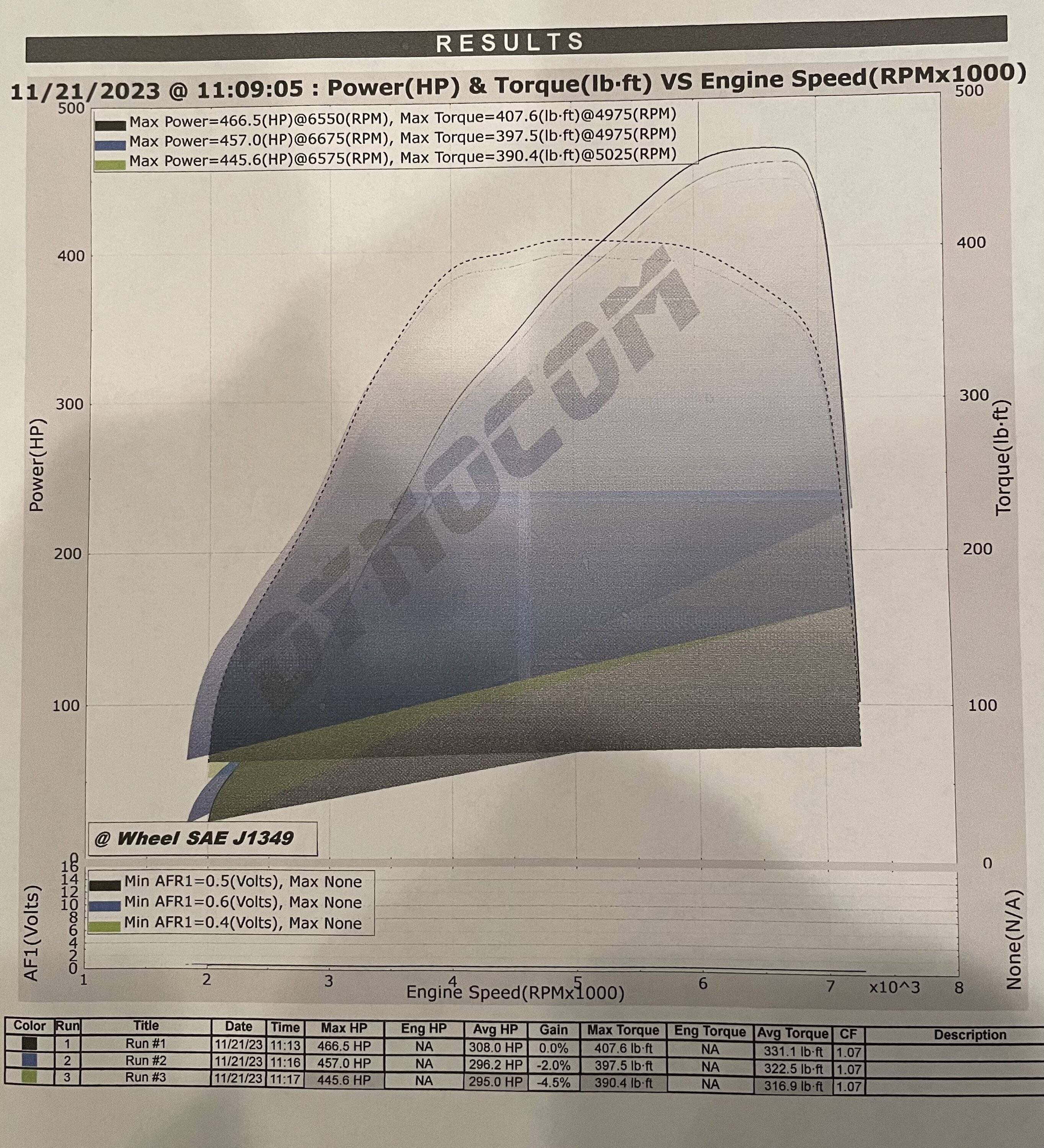

Type S with RV6 R660 466WHP

Hondata HPFP, LPFP AND 1330cc injectors
Was the LPFP necessary? Will you be installing the Hondata Cam? I wonder if that could push you over into 500hp territory?

Hondata recommended both HPFP and LPFP. I wasn’t a big fan of how the LPFP installed but it works well. As soon as I purchased this kit the new fuel kit with bigger injectors and cam was released. Not sure if that would get it over 500 on pump gas or not. I will watch and see what other DE5 and FL5 owners do with the new kit and decide if the juice is worth the squeeze.

I’m sending in my datalogs this weekend for the first round of e30 runs. Once Drob gives me the green light, I’ll get it back on the dyno to see if we can get closer to 500.

Finally was able to dyno my type s. 466whp on pump gas. Drobs e-calibration for e30 is next! 500+?!?
