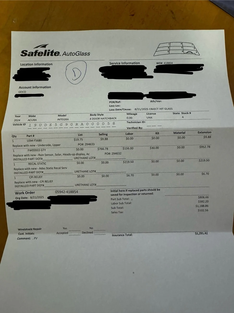

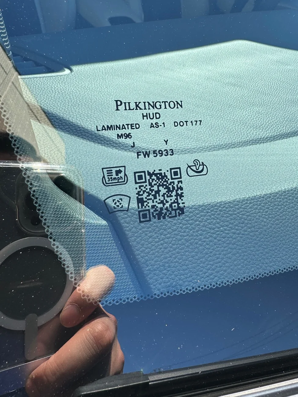

Morning of appointment I go in and ask the manager kid at the front desk what are the chances I’m getting OEM glass. He was really nice and explains Geico won’t approve OEM glass and aftermarket glass was gonna be used. Below is the invoice for, and a picture of the replacement. Done in 70 minutes and I’m not happy with the results.

The HUD was distorted and slightly tilted clockwise. When I pick my head up about six inches, it seems to contort back to looking more normal. There is a terrible vibration in the glass at around 3300 rpm 100% of the time with an audible rattle sound.
I complain to previously mentioned manager kid and he agrees to file a grievance with Geico. He takes pictures and says he’ll escalate and ask for OEM glass. Next day he calls me back and says Geico agrees to provide OEM glass and he makes a new appointment to install new OEM windshield and take back the old aftermarket glass.
Fast forward to today I get my OEM glass installed, it takes double the amount of time and upon return to me I immediately notice the difference. The main complaint the vibration and rattle are gone. Driving with both windshields back to back I can confidently say that the OEM glass has some acoustic/NVH blocking characteristics. Cabin is notably quieter. Also the HUD display seems to be 99% back to normal. I still see a slight tilt but idk if it’s daytime sun hiding imperfection in display or I’m imagining it.

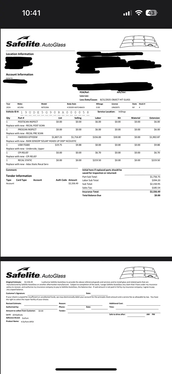

overall very happy with my experience with this specific location and staff. They got the results I wanted. I shall monitor the next few days and report back. Here’s a pic of the new invoice; according to the paperwork parts and labor is more than double the price of the aftermarket glass.

I got the Pilkington glass and my HUD is slightly tilted now too. I thought it was my imagination at first. It is also ever so slightly blurry. Honestly it doesn't bother me enough to complain and have it redone. I prefer to leave well enough alone. I haven't noticed any more noise or rattling though. Although I don't drive the car daily. Also, I'm going to continue tracking the car so I figure it will get broken again.
