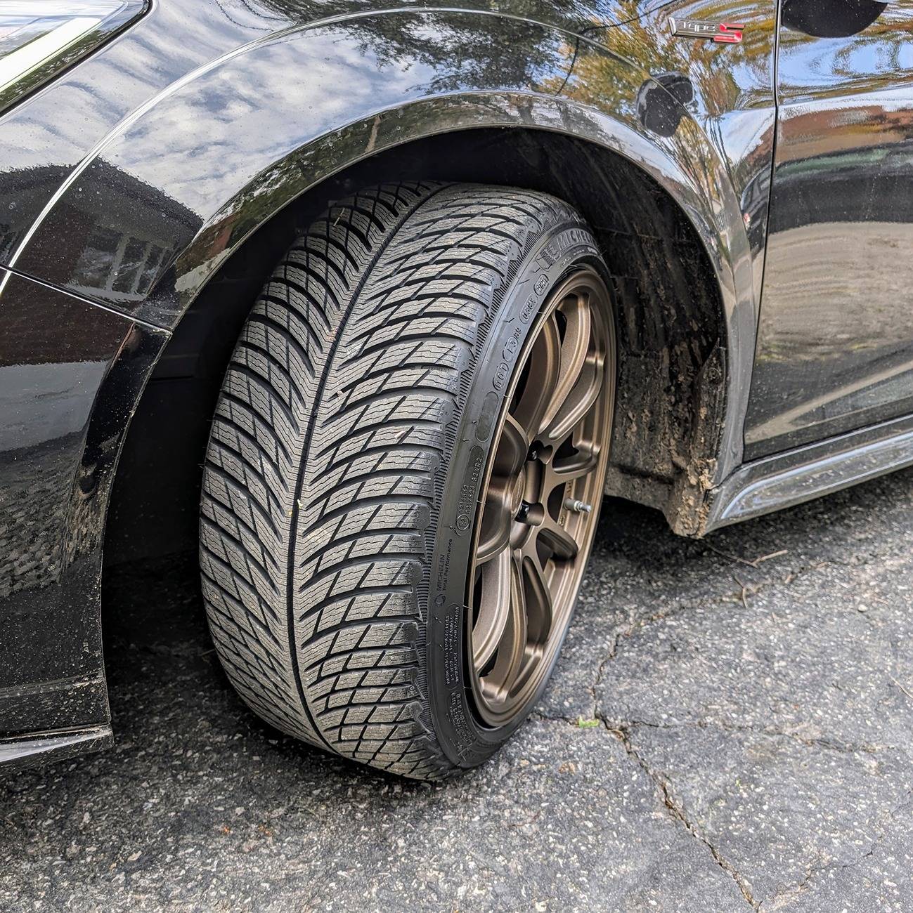

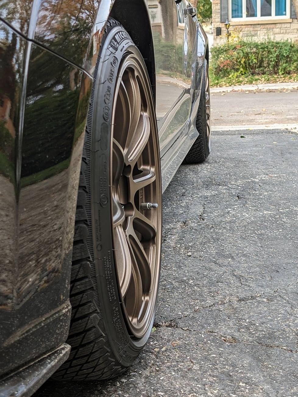

I'm running 235/40R18 on 9.5"
Michelin alpin 5
Yeah; the alpin 5 was the other tire I was thinking of but it only came in 235/40-18 and I was worried it wouldn’t work on a 9.5 rim even though the tire rack chart says it’s ok.
378
213
Holy stretch batman. Good thing that tire has very generous lip protection. I still wouldn't breath near potholes 😅.
How do you like the alpin 5?
