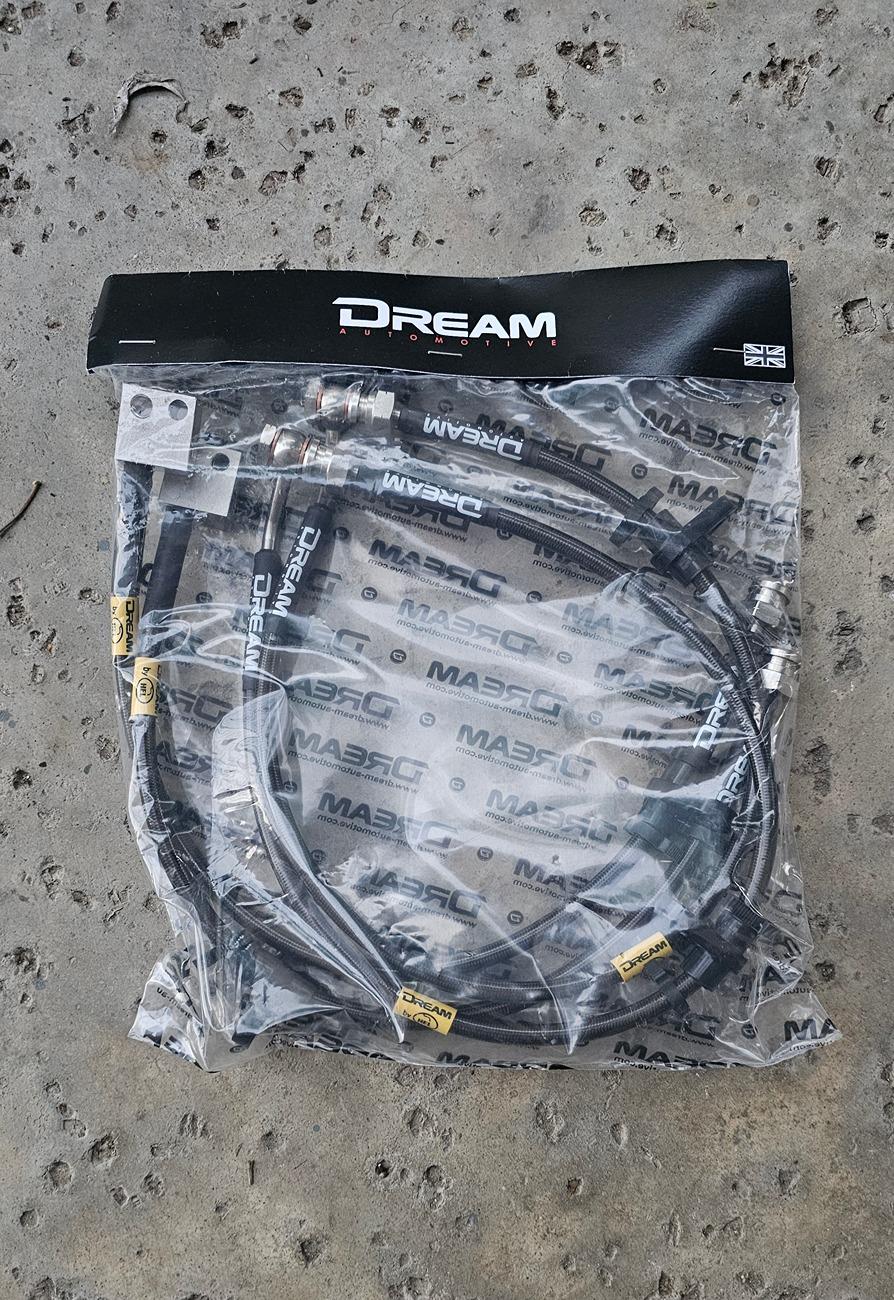

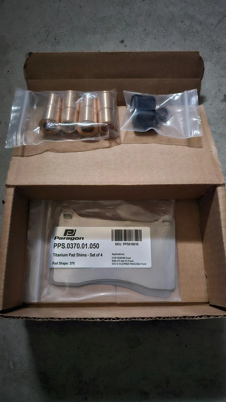

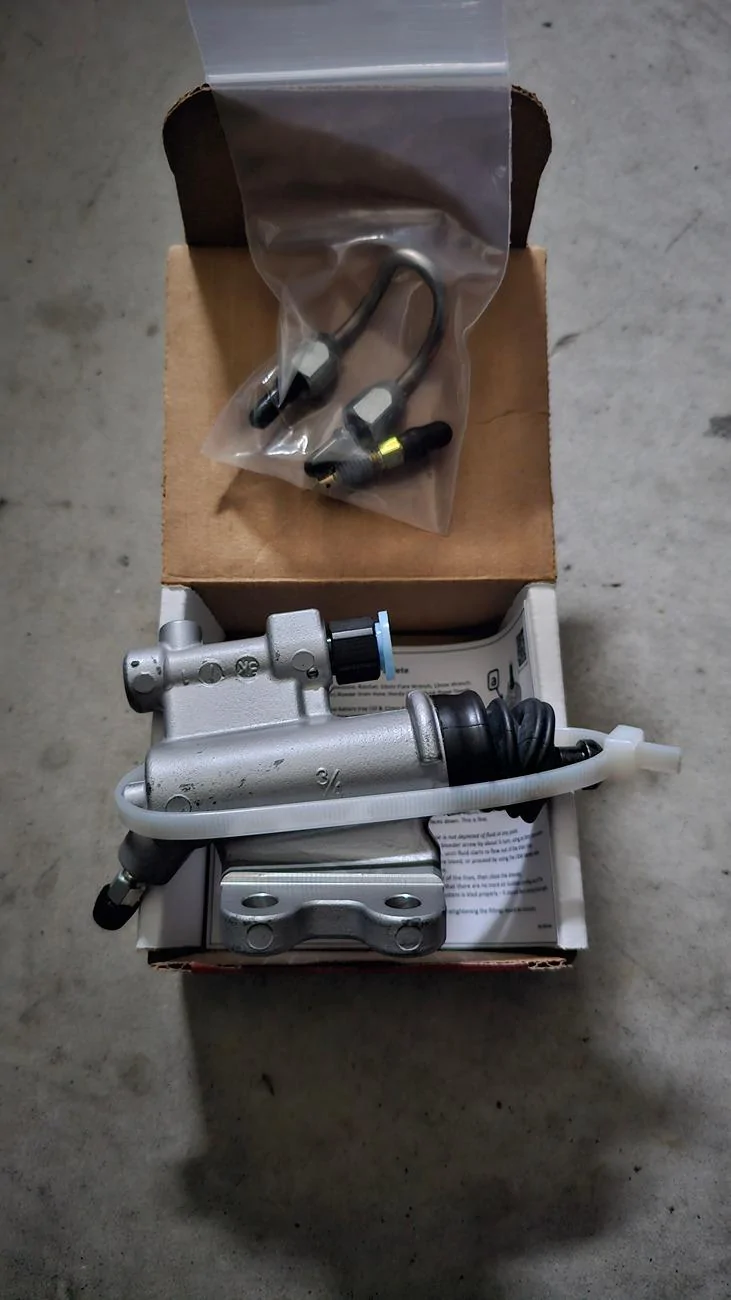

I have the same setup waiting to be installed. Bought a FL5 slave cylinder and did the delay valve delete and just got the Sirimoto damper delete yesterday. Waiting on a Spoon clutch line to do everything together. Will do the clutch along with HEL/Dream stainless brake lines, Dixcel brake pads, Wunderladen rear brass bushings all at the same time using Project Mu G-four fluid. You'll probably be able to give feedback first as I'm told my Spoon clutch line is another month to two before shipping.
