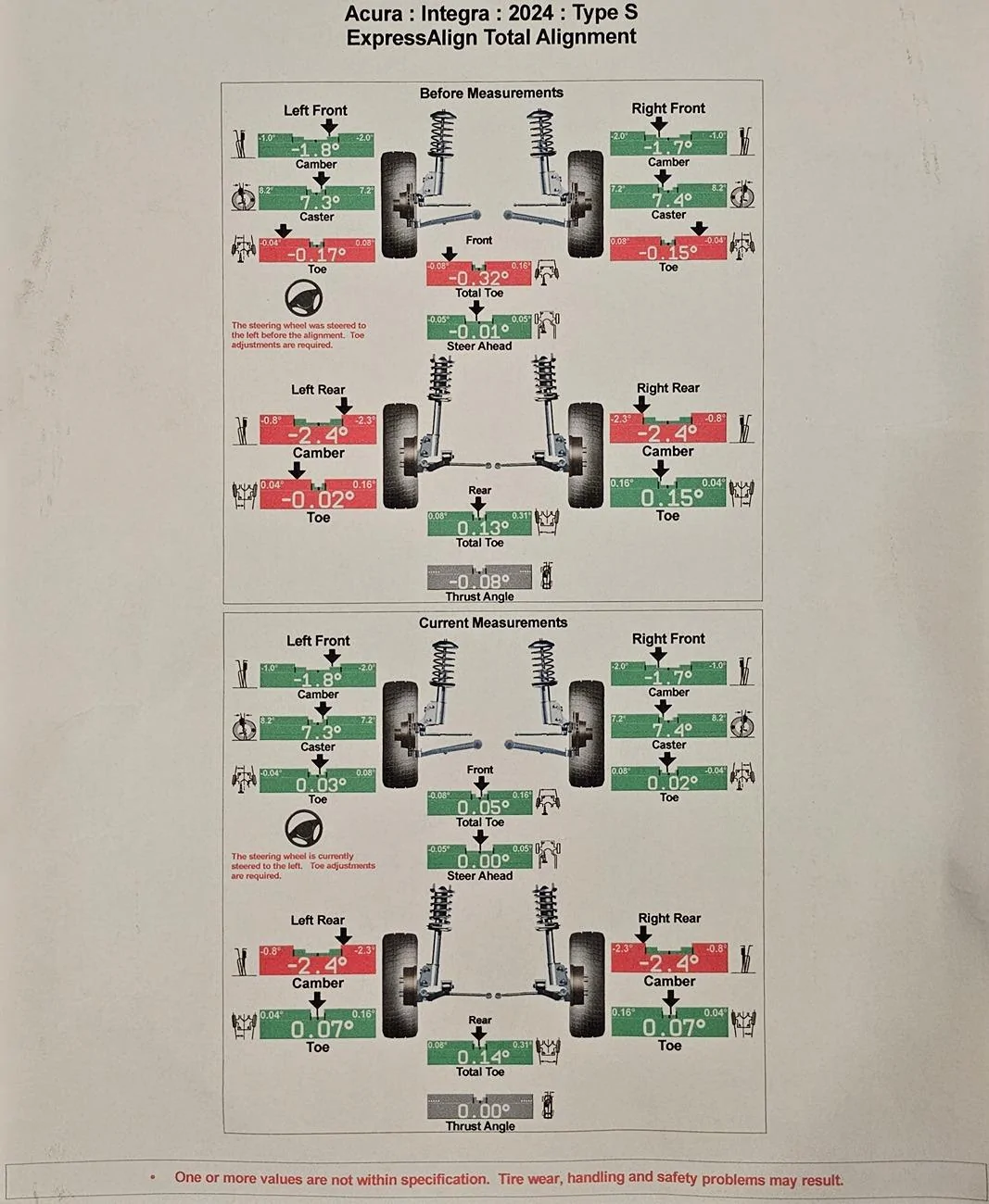

Anyone care to share some alignment specs after lowering? Mine are below; best effort by the dealership.
