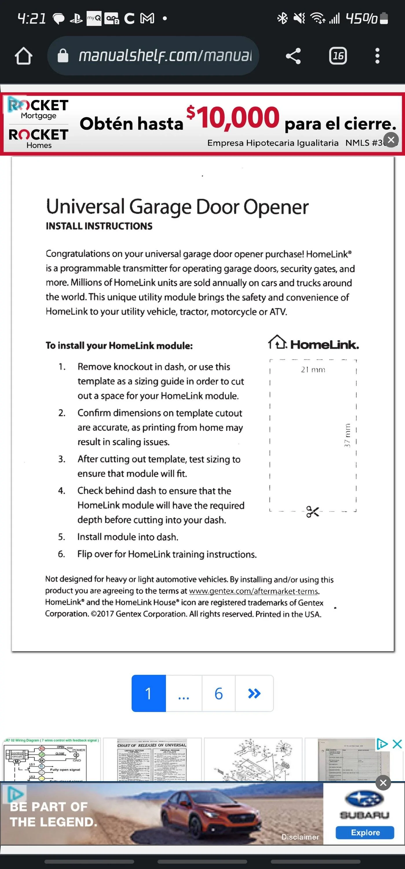

The homelink module is 21mm x 37mm, or at least the portion it slides into needs to be. Because it's self contained it could be cut into the knee bolster and pushed into that for a hidden look lol.
Here's the Manual for it.
Acura Integra Homelink Alternatives Screenshot_20230901_162113_Chrom
