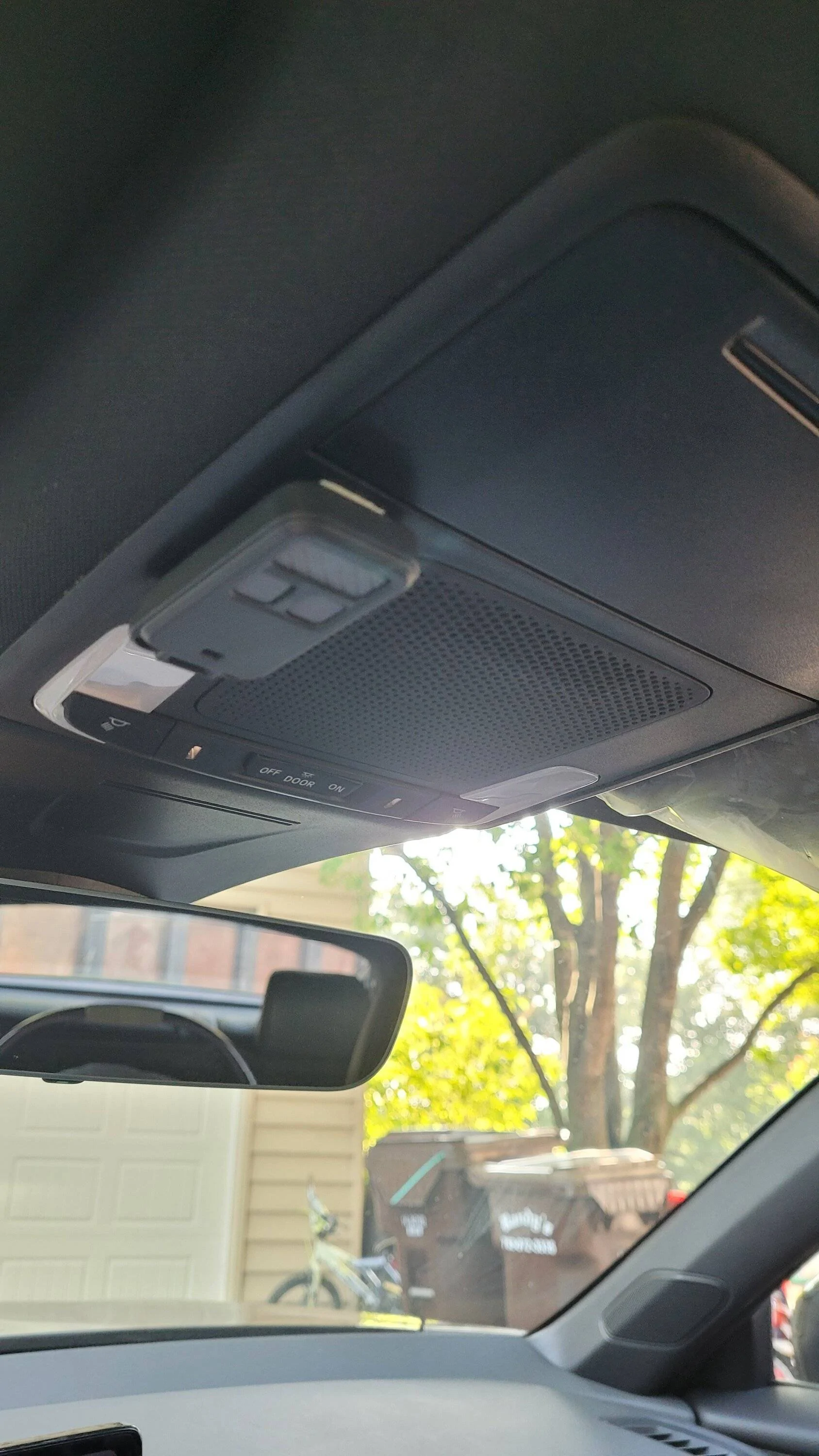

Here is how I am doing it in my ITS. I used double sided tape to attach the small remote on the top edge of where the phone charger is. It is somewhat discreet but still very accessible. I programmed my garage door to be the first and largest button so it's easy to push to open and close. Hope this is helpful.
I just used a Command strip to hold a keychain opener next to the sunglasses bin. I will probably wait and get the TLX or accord frameless homelink rear view mirror as they become available in junkyards.
