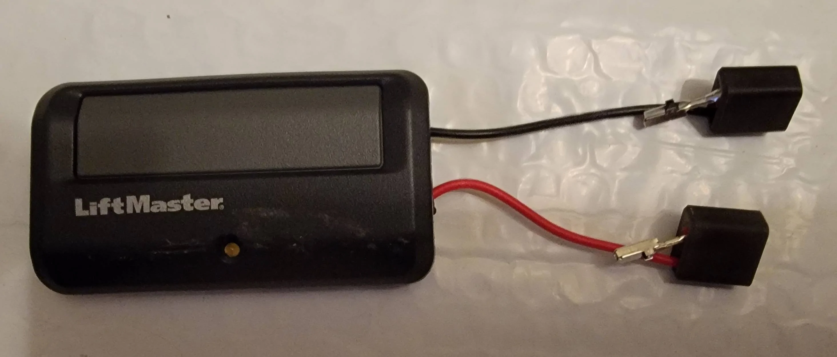

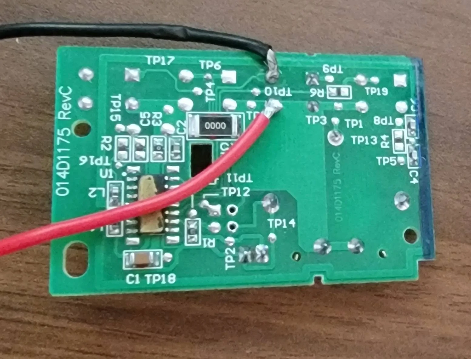

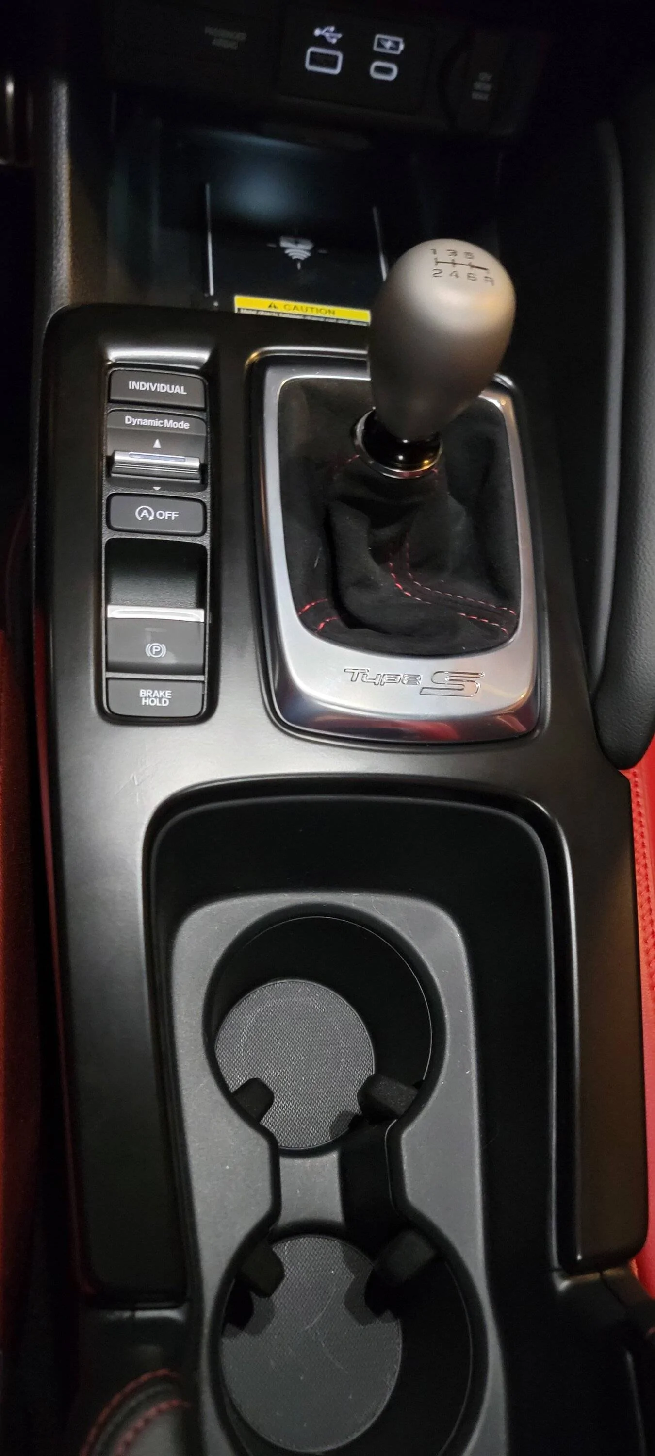

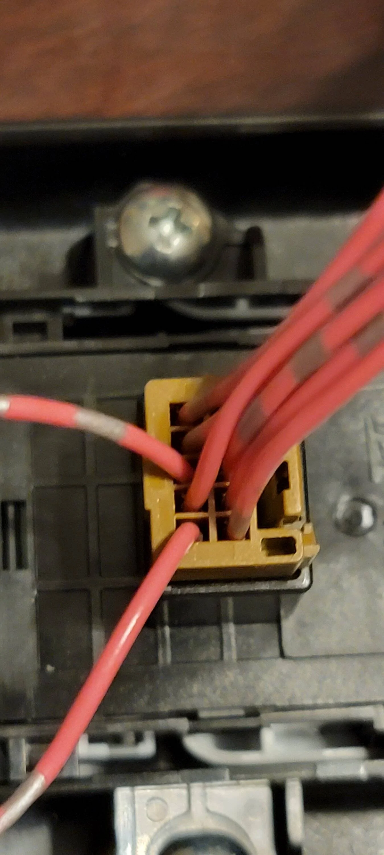

I got it working! The good news is you don't need the MLK harness, you just need the Aspec switch for $35 then tap into these two wires (pulled to the left). Make sure it's a tap, you need the cables connected or the parking brake will stop working for some reason.... Ignore the cable colors, that's just the MLK harness.

Can't quite tell what I'm looking at here. You mapped it to the A Off button? What is the circuit board looking thing?

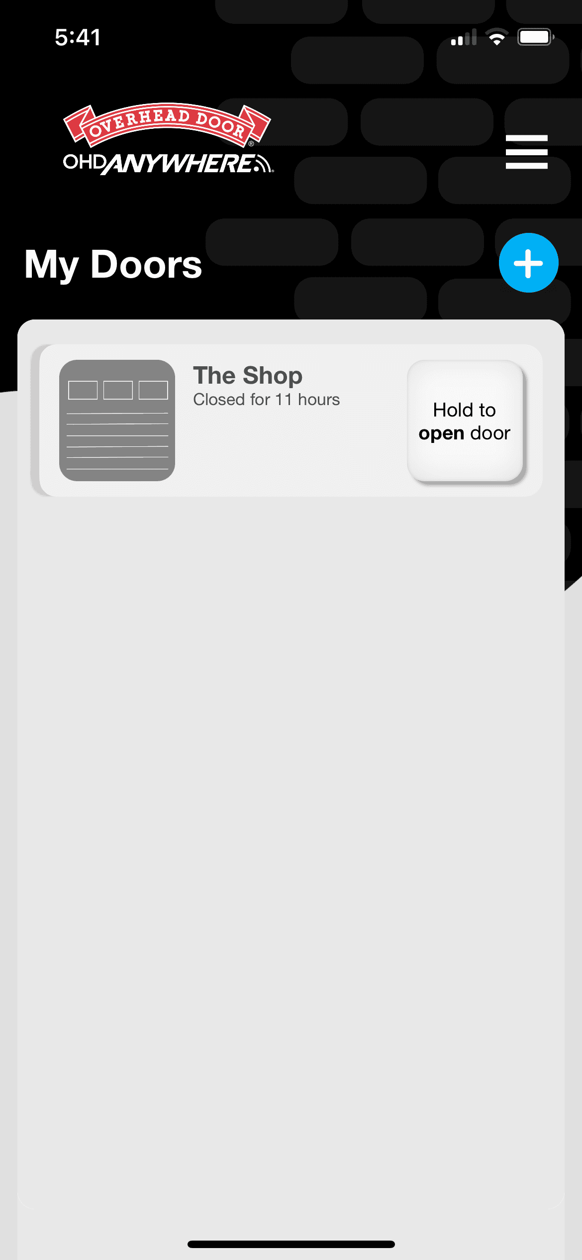

I unfortunately can’t have a garage door opener in my car because I’m keeping it outside. If a thief were to force entry to the car, they would then have access to my garage and ultimately my home. Sucks. But luckily when I had my new garage door installed last year it came with a WiFi enabled operator. So I linked that to my network and use the app to open/close the door. It also works with Siri and Alexa.
Awesome job. Curious on the taping and not removing those two wires. Isn't there an existing voltage?
The two wires being used are from the Start Stop which isn't in use. So shouldn't be any voltage on them, but I didn't verify. The MLK harness works the same way, it taps into these 2 cables to trigger the auto start stop, it also connects to a third cable which I assume is for power, which I didn't need to use. So far no issues, but will see, as the cables are clearly monitored since it will error out if you cut them.
Yes, I swapped in the Aspec switch assembly and used the Auto Stop Start button to trigger a remote garage door opener I slid into the center console. The circuit board is the garage door opener, just open it up, test for what points need to be connected to complete the circuit, solder to those and remove the existing switch just in case.
