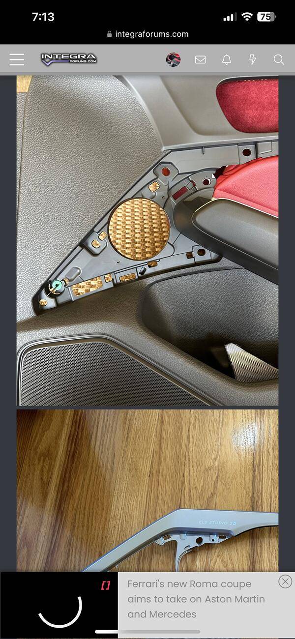

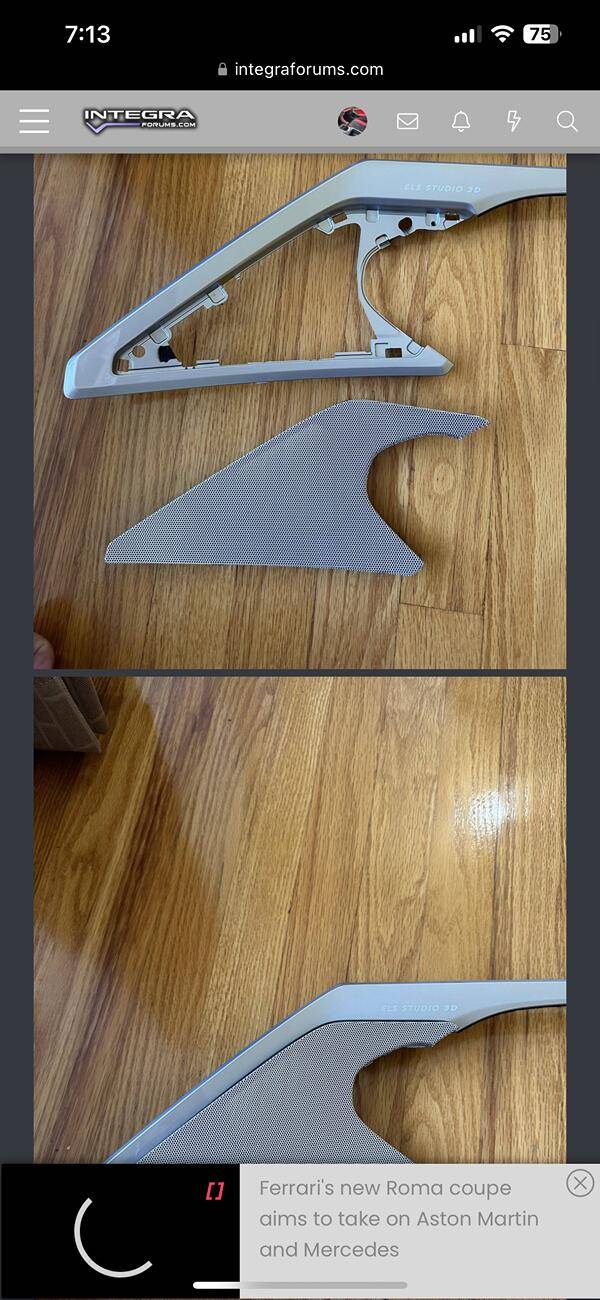

Are you referring to the metal els speaker grill ? If so I am going to try to take that apart and check do you know how by any chance ? I found these images online , I’m hoping it’s my issue . Raising the speaker volume doesn’t make any rattle noises for me , it’s only when heavy on throttle .

This whole part here is loose so if I press on it (can visibly see a gap that closes when I press on it, so mine might be total garbage), it moves in and out and can rattle against the trim piece. I'm able to get it to rattle like crazy with music/sine sweeps, and I can touch it while it's doing it and it dampens it significantly. If yours doesn't do that, then it's probably different, and maybe there will be something behind the door panel, as Victor mentioned. Once I fix that grill, I will have to check if there are more things to tackle behind the door panel as well, but the grill is the first priority for me on that front.
I do feel it’s looser on passenger side as the drivers side doesn’t move but the passenger does a drop so I’d rather be safe and inspect it and reinforce it once I take the door card off again . Do you know how to remove it all ?
do you know how to remove this part ?
Take door card off.
From back side look for the silver screws with built in flat washer, undo them.
When the els surround pops off squeeze the grill through the slots gently, ensuring not to bend them.
Once they're off, felt tape the grill tabs and insert back in.
Once back in, slightly bend the tabs to ensure they form a snug fit.
