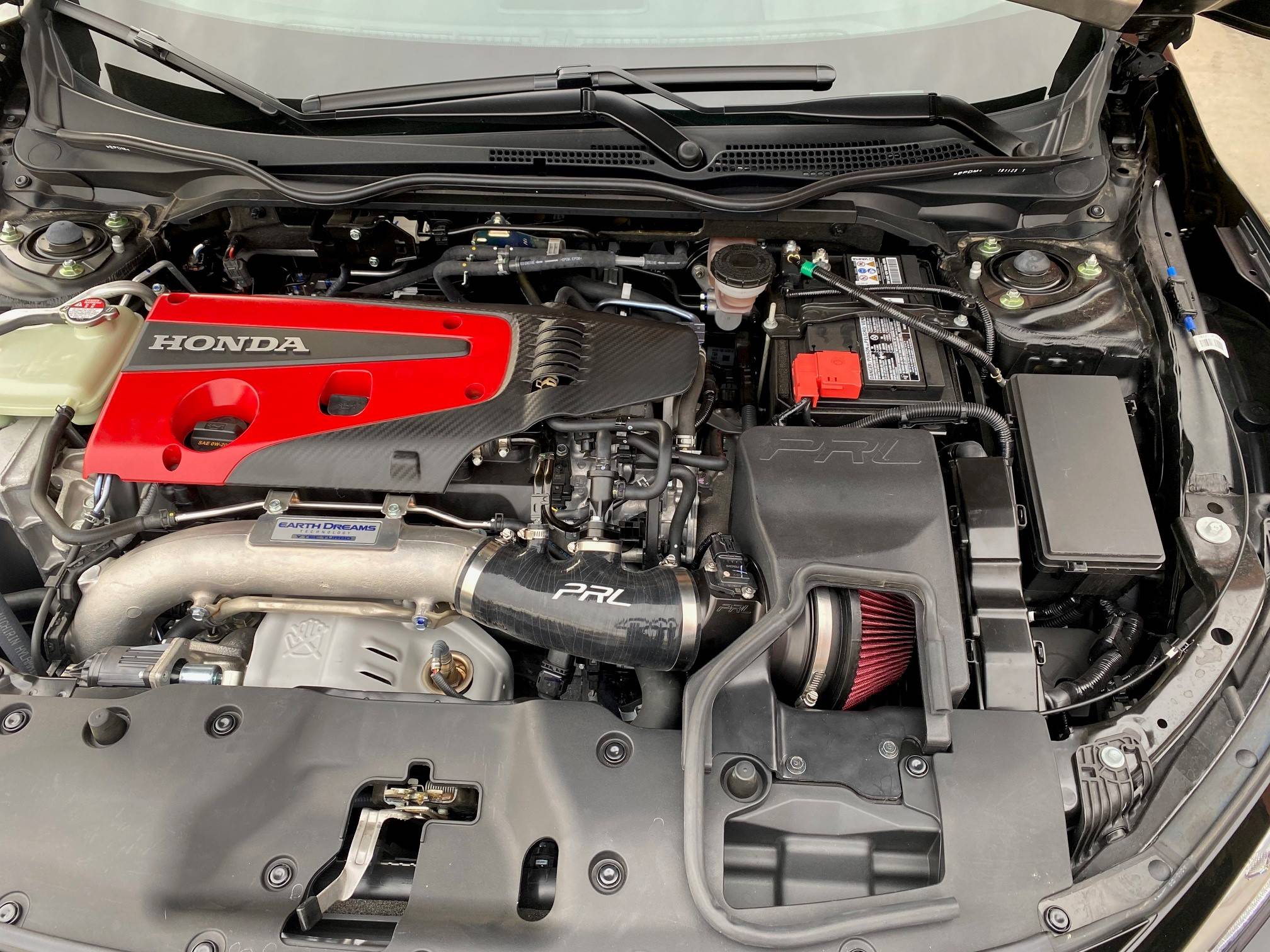

I have the PRL High-Volume Intake on my Integra, and honestly don't notice much of a difference in the sound
Very different engine.
I bought the intake based on sound clips from YT videos on other CTRs, specifically for the noise as it serves no other practical purpose on a stock engine.
It's quite loud, especially at high boost.

I was going to ask if it actually did anything performance wise. I saw a bunch of different dyno graphs but to be honest the results didn't make sense to me. Like it seemed to have a larger power differential on the stock map than it did on a Stage 1, I would have assumed it was the opposite. I like loud intakes, but I also like how you can make good power with the K20C while appearing stock thanks to all the heat shields, etc...
Yeah honestly, I'm not really sure if it does much, and that is mostly based on stuff I read a few years ago when I bought it and the Borla catback, that basically indicated that the Bosch? ECU would compensate for most stuff done to them unless it was tuned. No idea how accurate that info is/was, but it doesn't feel any faster.....just sounds 100% better.
The car, apart from some pretty terrible fake noise, was nearly silent when stock, so those two changes made a world of difference to the driving experience.
Fwiw, the FK8 PRL intake is made really well, and I especially like the way it seals to the hood just like the factory airbox so that it's not just sucking in hot engine air since it's right next to the turbo.
