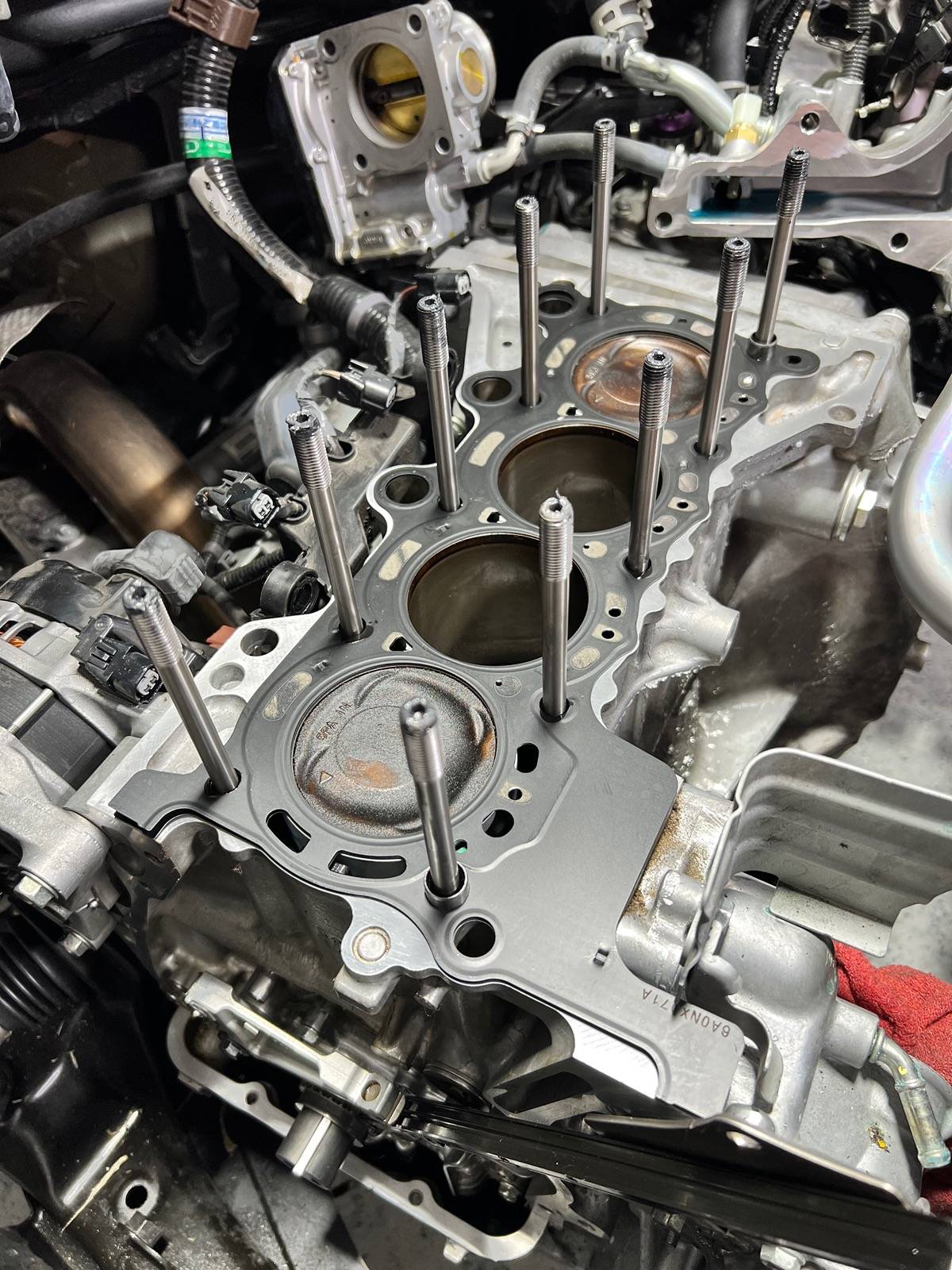

Problems/issues: Head gasket failure - New head gasket and Two-Step/ARP Ti head studs installed. Excessive oil flow to RV6 turbo - RV6 performance warrantied turbo and installed oil reducer.

L15 engines are a famous for having weak head gaskets. If you check out YouTube there are many postings about it. Here’s one where the guy shows you the weakest part.
I had the pleasure of meeting up with Nick Ososik from theFOAT Media and he recommended two things. First was a linear tune (where power goes up linearly with RPM). This is different a “canned” or standard tune from Hondata because the power builds gradually. A lot of tunes (and even with the stock tune) boost builds up very quickly low in the RPM range which can cause issues. In other words, traditional Civic Si/Integra tuning builds up torque/Hp like N2O and very harsh on the engine.
30:20 Data Log Review
2nd recommendation (and it was more of part of the engine rebuild) was using ARP head studs. https://www.twostepperformance.com/...WYdSGpULmvYLXh9g5iIRmj7PRZQQT1CBoCk_sQAvD_BwE
This is more peace of mind. The head studs on the L15 are very weak, with max torque limited to 60 ft/lbs. With titanium parts, 70 ft-lbs can be applied in attempt to keep exhaust leaking into the narrow coolant channels between the gasket.
Acura Integra The Tuned 5th Gen Integra Experience & Reliability Thread 73464644628__F78F82DE-2E27-402F-9A88-FDA5F28E8B03
If you drive your car hard, really keep an eye of your oil levels for your car. I really recommend an oil catch can too so you don’t mix up indications. An oil catch can will keep the section of piping after your PCV recirc dry. Be mindful of unexpected reduction of oil level (we’re talking noticeable reduction with a week), oil in the coolant, etc or otherwise indications of blow by. A compression check will validate anything more severe vs just a failed head gasket.
