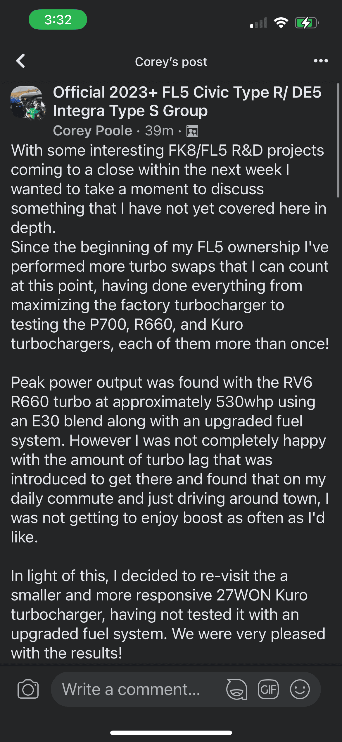

On the topic of turbos, what is the preferred turbo these days for more streetable numbers? I know everyone loves the R660, but I was wondering if it makes more sense to do MHI Stage 2 or Kuro if you aren't looking to make much more than 450whp?

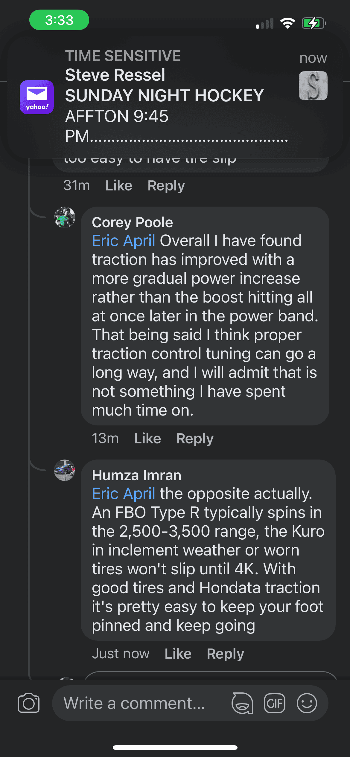

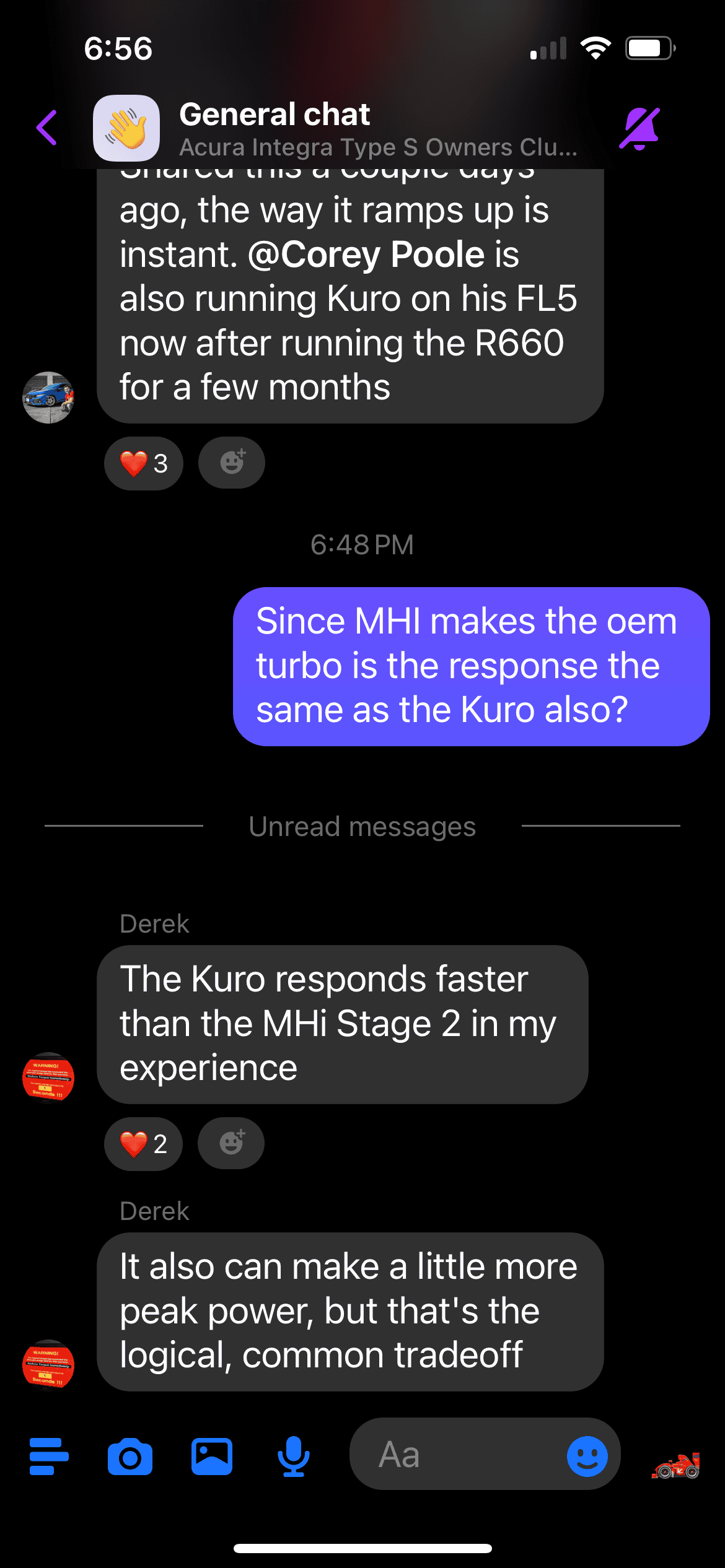

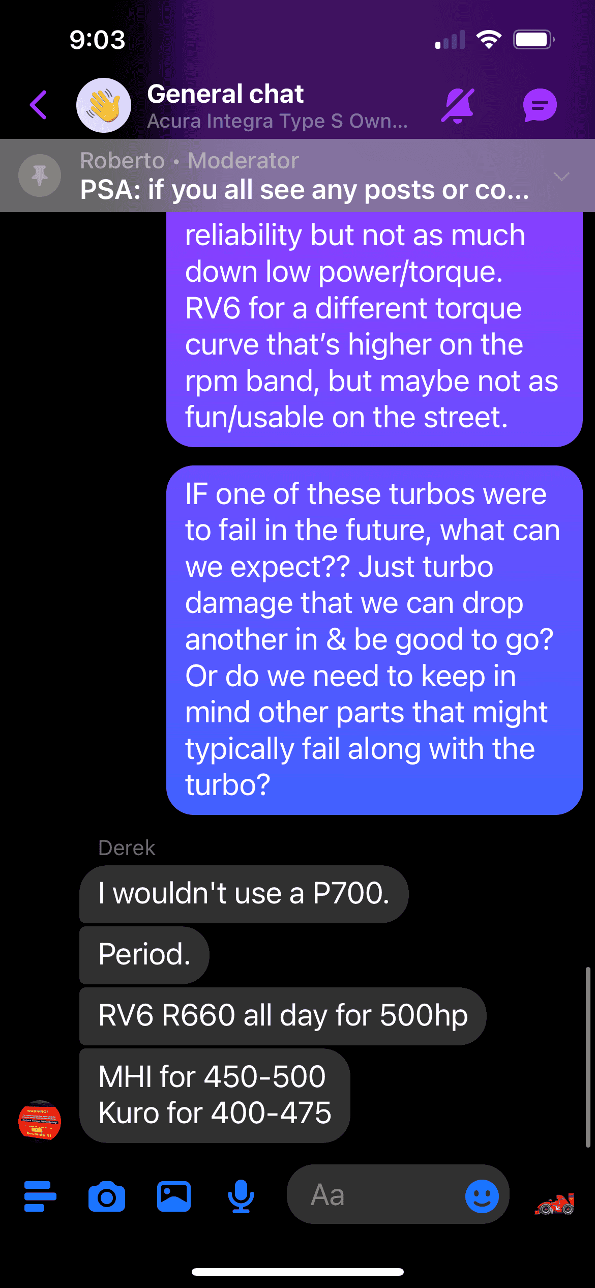

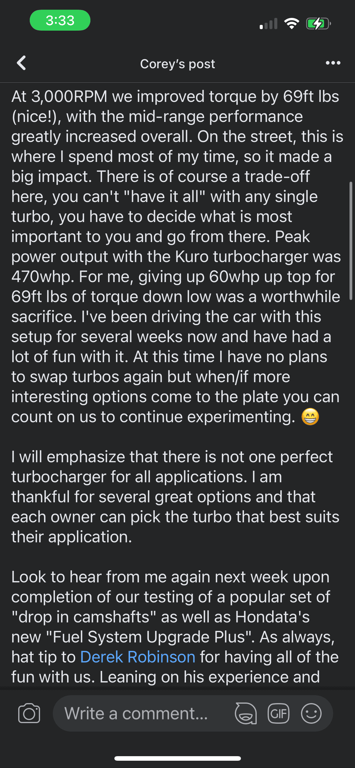

I’ve seen Pepo tune an MHI Stage 2 to 500. As my usual lately, I’ll let the pro’s who have had personal experience with these speak for themselves lol Pardon my non-cropping, this is just in my personal ITS photo vault for future reference & poor memory:

Welp . I'm looking for that 450-500 range.

But your post mentions Kuro in the 400-450 range. Is this correct or are these values swapped with the MHI?

It looks like Corey & Humza were anywhere between 420-460 with their Kuro’s & Derek mentioned 400-475. If I’m looking at the different screenshots right. Probably depends on the different supporting mods I would imagine.

I think all these turbos CAN hit 500whp, it's more where they are most efficient and where they will be placing the power under the curve. More importantly is what kind of fuel or meth do they need to run to hit those numbers. I was laughing at Hondata showing dyno charts on Q16.

Absolutely. Humza & Corey said 430-450ish on the Kuro without any fuel upgrades can be done. Turbo kicks in at 2k rpm’s & is a gradual increase to prevent breaking traction. Tune by gear compliments that well also. I think I’ll be happy at that level for a while. At least I sure hope so. ? @Integra23 has the fuel upgrade so he should easily get to higher 4’s/500ish no problem. I agree with your Hondata statement - not sure why they’re so conservative. D-Rob seems to be a better tuner & also much more engaged with the drivers of our platform.

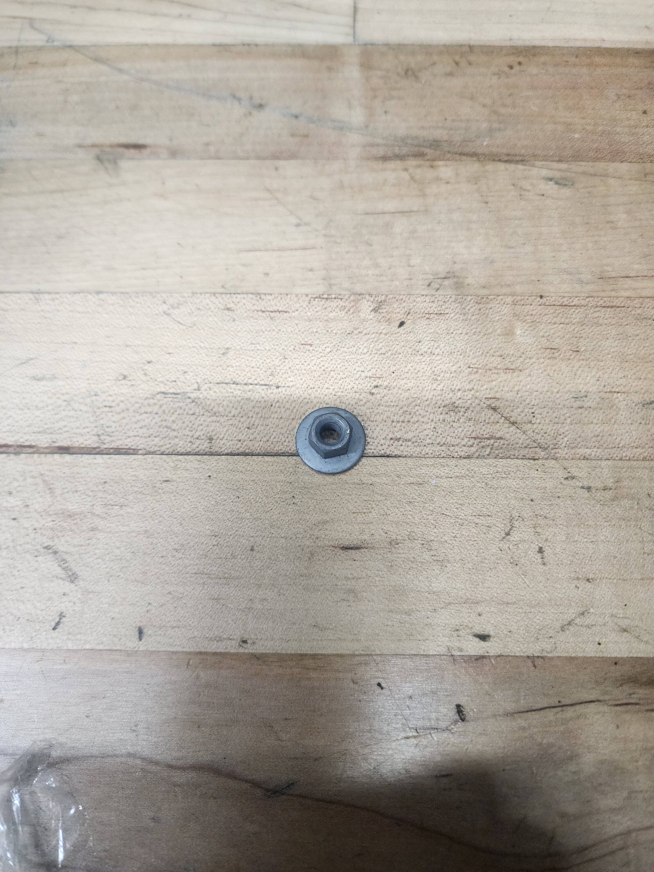

Changed the oil...At 4423 miles still at 70% and oh yeah this fell out..I know someone else also posted about having a nut fall out...wtf is going on Acura...smmfh
Acura Integra What did you do to your Integra Type S today? 🙋🏻‍♂️ bolt1
