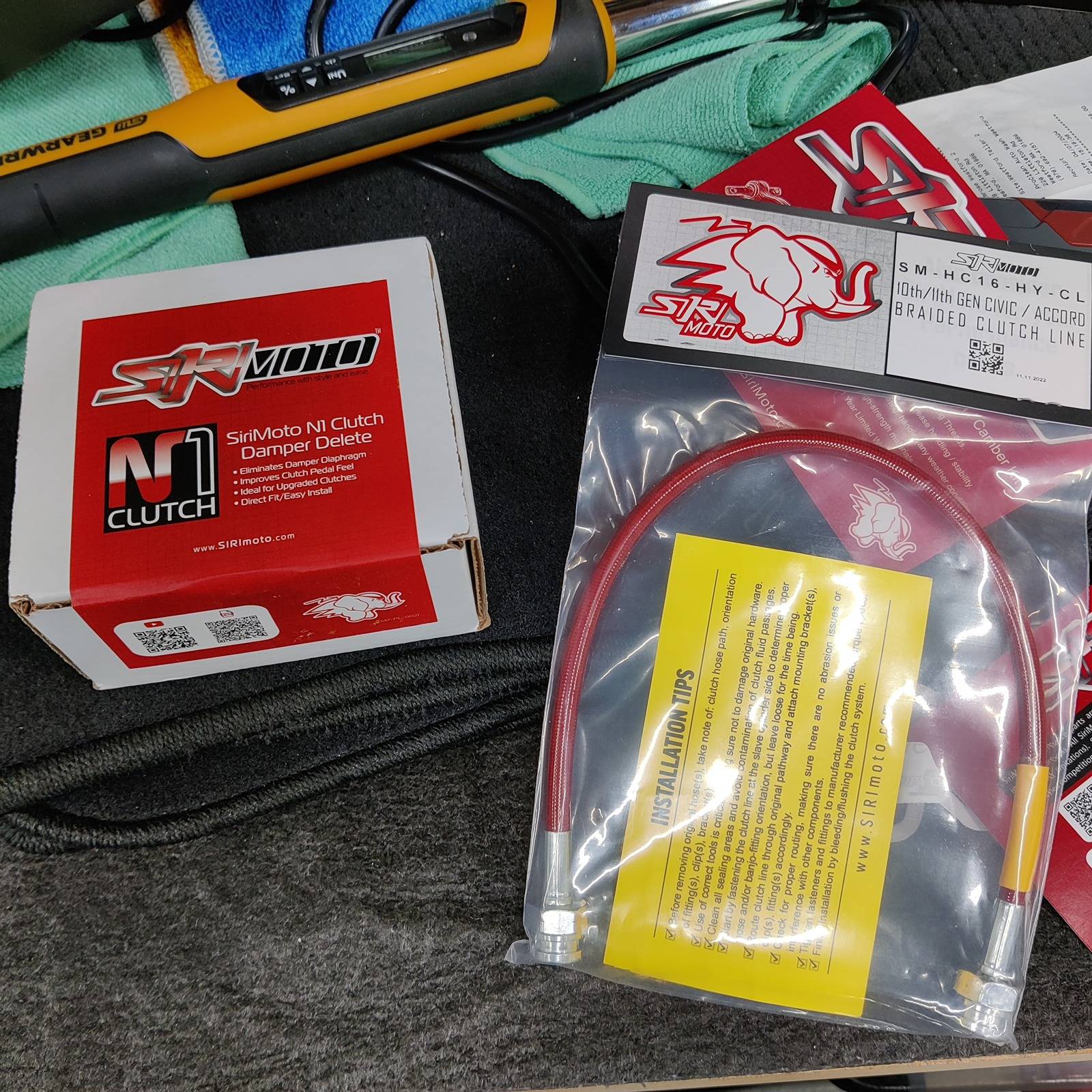

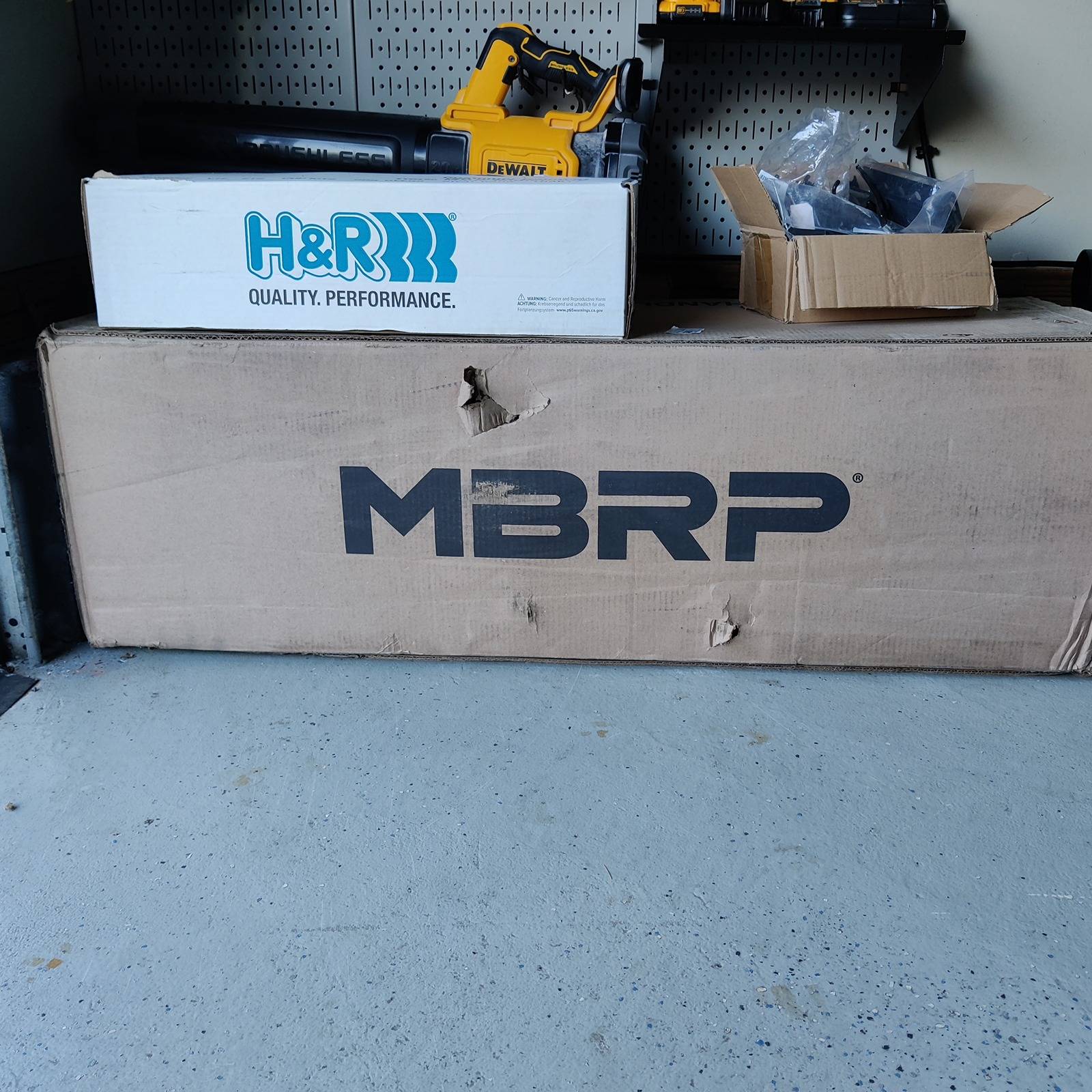

Parts - received ✅

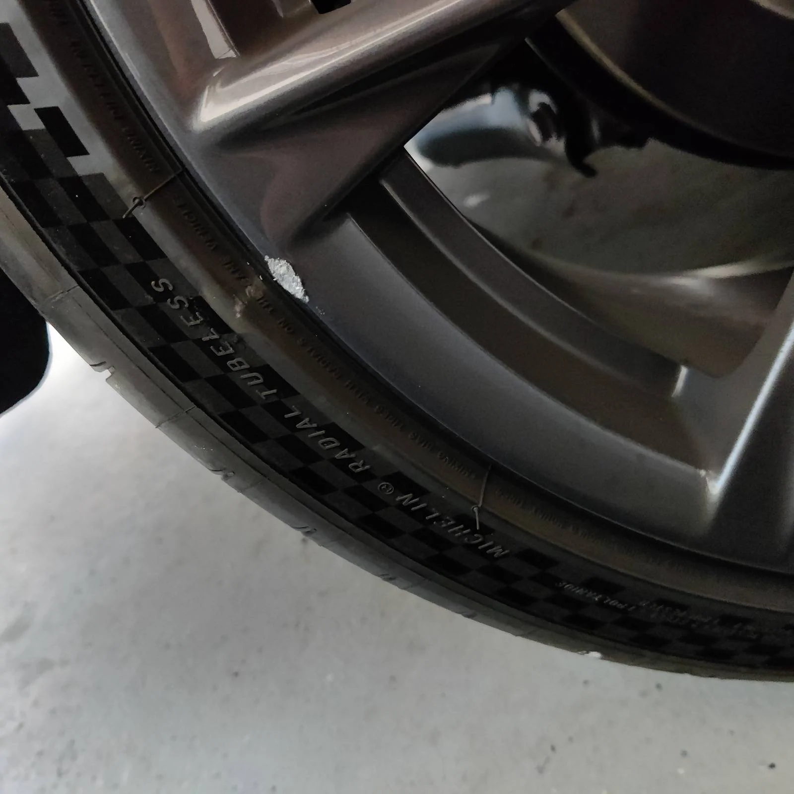

Wheel - curbed 🤬

Would love to hear about the damper and line install as I've been eyeing that same one lately. I've never done clutch related work yet
I'm waiting on my spare slave cylinder to arrive because I plan to modify it and remove the delay valve. Once I have it I'll start the Sirimoto parts at the same time.
I've done these before on my Accord and M2. It's not a very intimidating job but it can get messy.
Will definitely report back once the project is complete!
Awesome, thanks! Sounds almost like brake fluid stuff. Lol I pay to have it done half the time bc I still haven't gotten the brake fluid vacuum tool and I feel lazy about it.
It's funny you say that because the brake and clutch fluid actually share the same reservoir, it's definitely brake fluid stuff 😆. I did brake jobs so often on my previous cars that I invested in a vacuum bleeder some years ago. If I were to do it again I'd get a smaller, more simple bleeder though. Highly recommend and worth the investment either way if you don't have access to a second pair of legs. I still need to pick up a speed bleeder screw because it's going to be a one man job.
This should be a 1-2 hour/beer install and clean up job with immediate results. The question is how much of an effect will it have. I'm hoping it's enough to solve our issues with jumpy starts, slow shifts, and grinding between gears.
I'm on a quest to improve engagement and feel in the car; clutch pedal feel, short shifter, etc. Waiting on Acuity to release their short shifter and Sirimoto (or someone) to release an improved clutch master cylinder. Once the hardware has been resolved, I'm aiming for tuning out the rev hang, adjusting the throttle mapping, and burbles to my liking.
