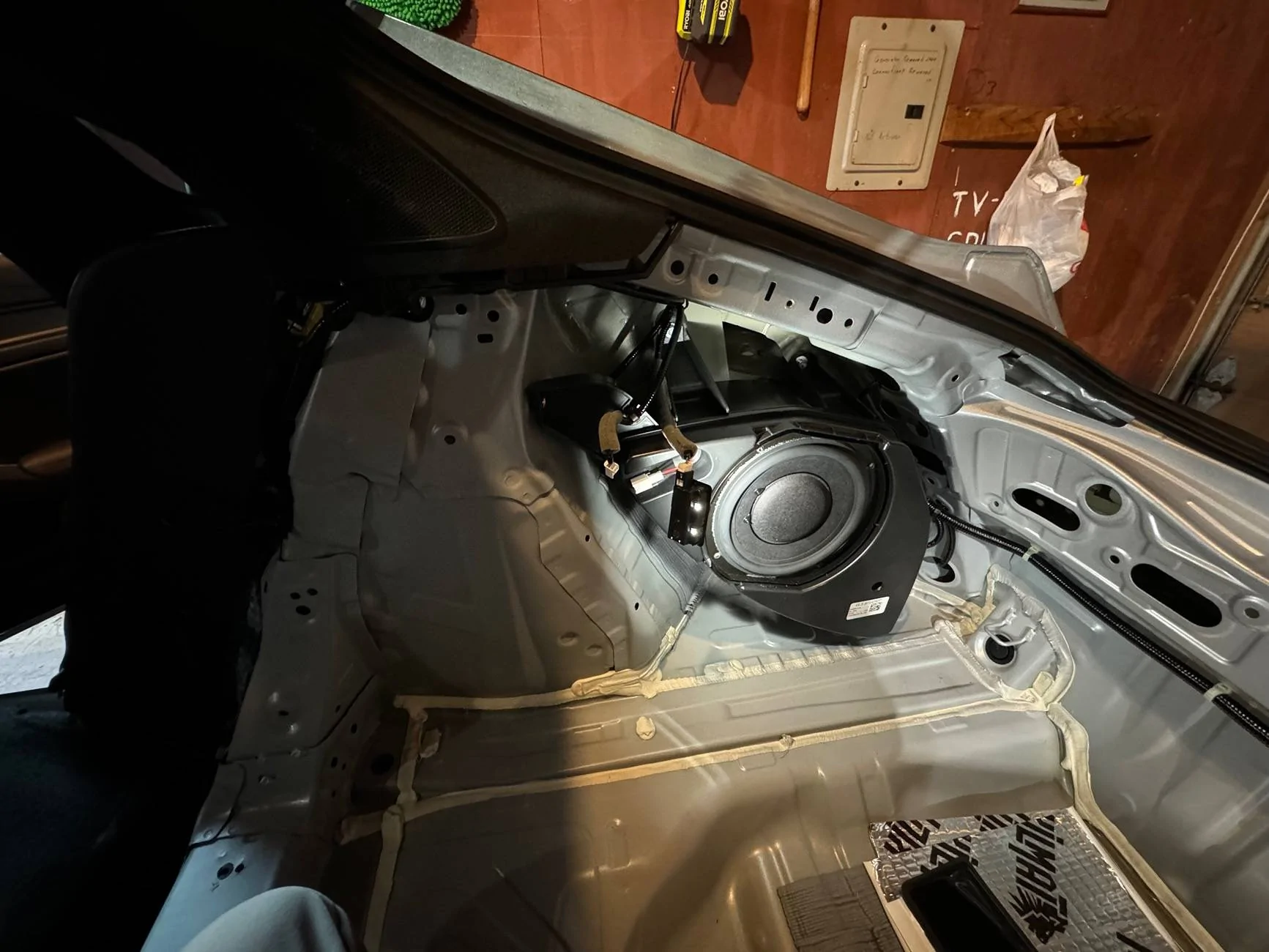

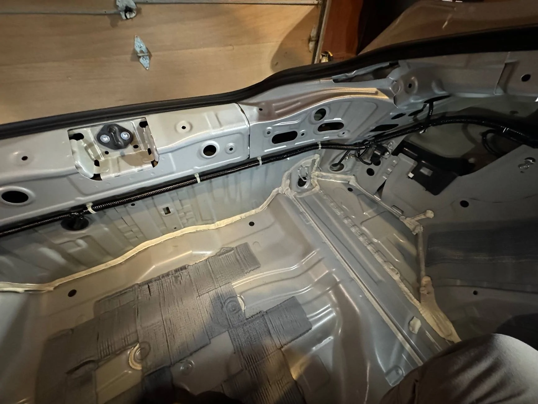

Noticeable improvement?
I haven't taken her out of the garage yet since its been raining here, but tapping around inside the car it seems to have cut down on the hollow sounds :)
Correction post drive. Huge difference. Not as tin can sounding from the exhaust in the rear….added picture where I stopped and placed everything at 4 am

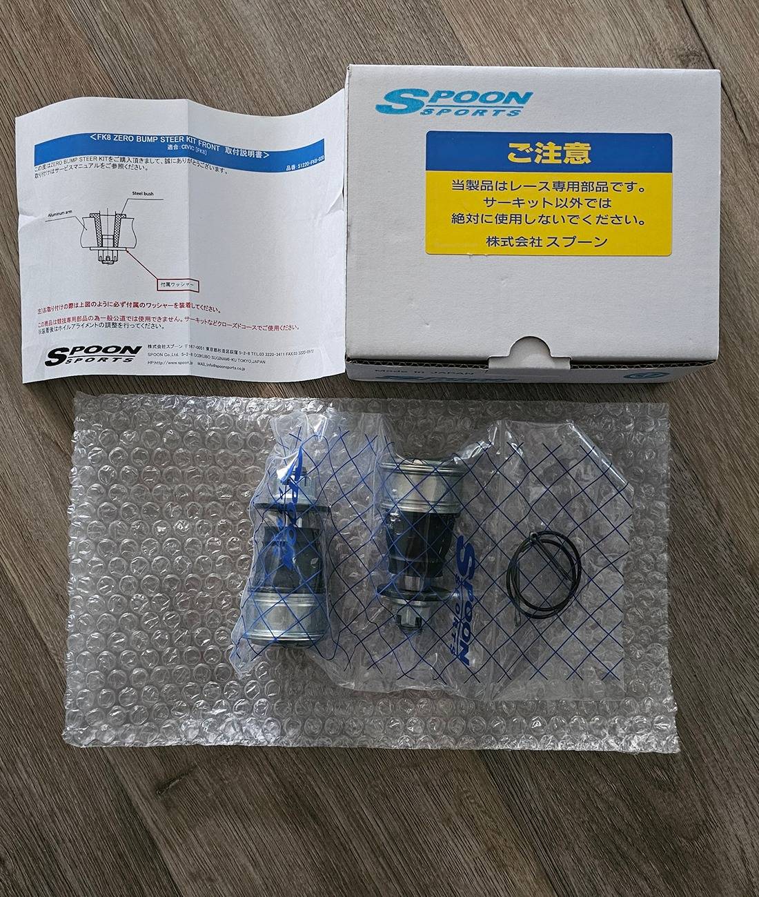

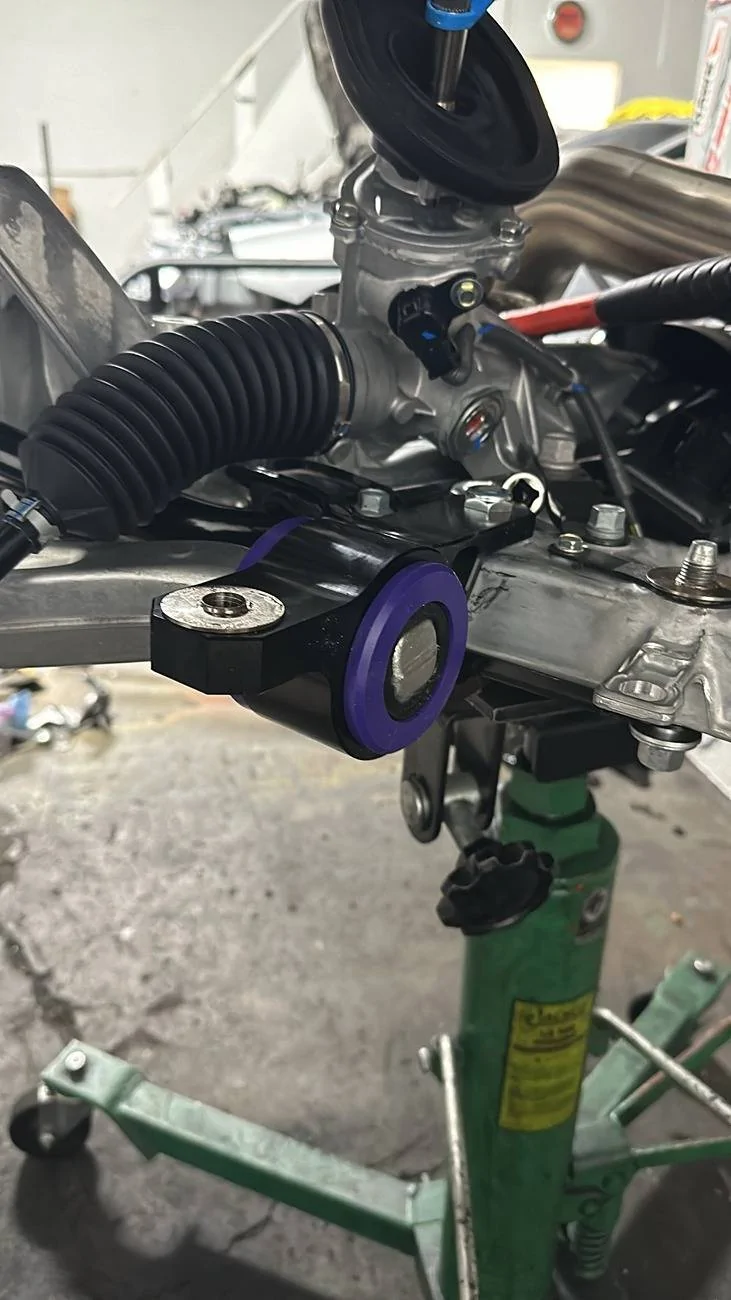

First post on this thread so I'll post a bunch of stuff done in the past month+, just put the Spoon Bump Steer (roll center adjusters) and rear A/C vents in the car. Previously had the PowerFlex Antilift Kit installed and wasn't able to find anyone that's installed an Antilift Kit on the FL5 or DE5 so far. Things changed from the FK8/10th Gens and the subframe has to be dropped to remove the lower control arm to install the ALK.

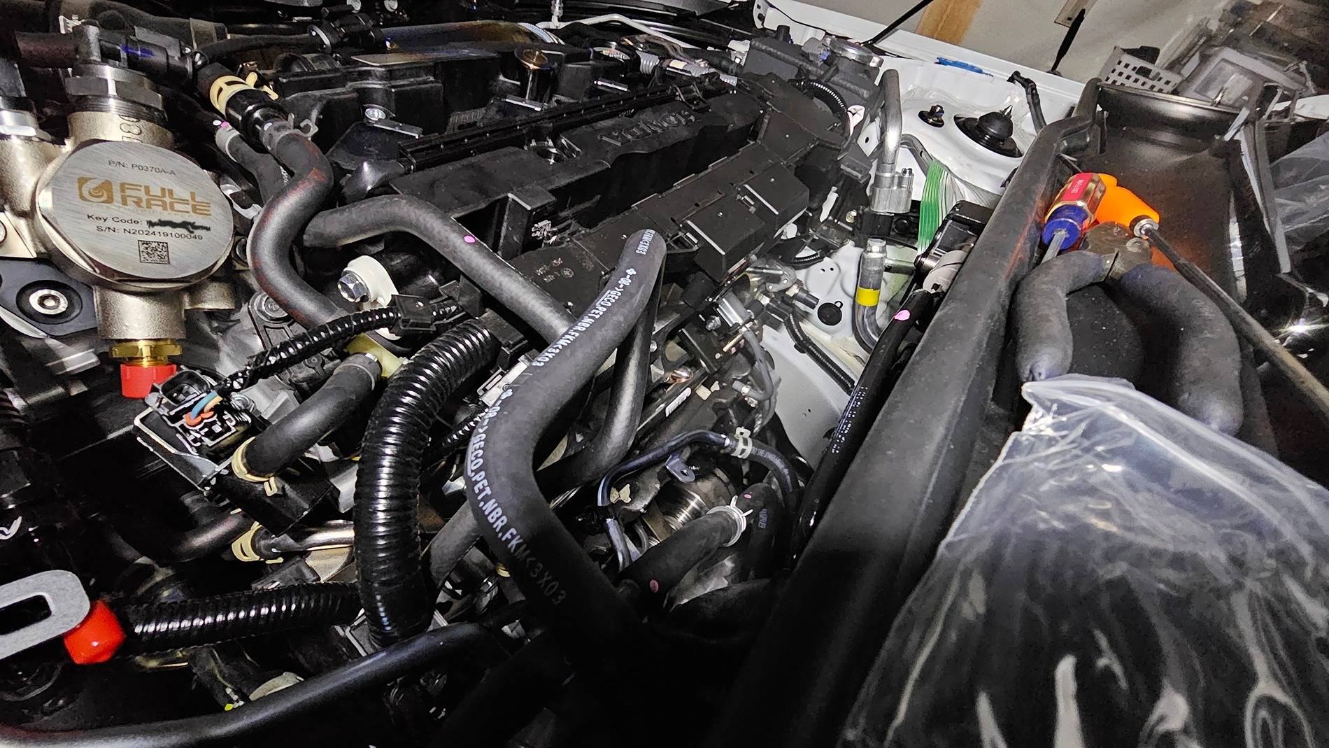

Also, just finished up installing the Full-Race HPFP, Hondata 1530cc Injectors, CANFlex, PTFE Lines, Radium Fuel Filter and pressure gauge, JSR ported Intake Manifold, ported throttle body, ported turbo outlet pipe, and finished with a custom Jester Tune.
