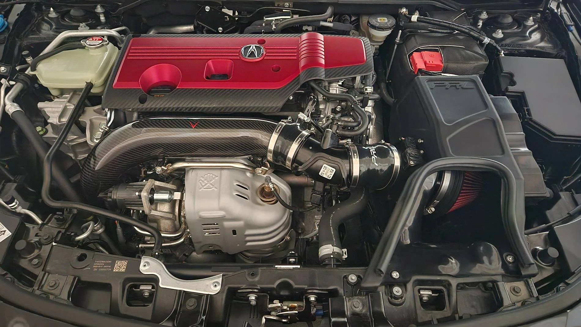

Does anyone know if the PRL HVI will connect up with the Eventuri Carbon Fiber Inlet pipe? Are they compatible with each other and is it advised to mix and match brands like this?
They'll mate up just fine as long as you have the HVI that comes with the silicone fitting for the PRL titanium inlet, im not sure if it'll work the the standard silicone fitting. If you intend on tuning the only real difference you'll see with hybrid setups is in your wallet.
I just bought the basic PRL HVI, so hopefully the silicone fitting works with the Eventuri. When I messaged TSP to ask if the the PRL HVI and Eventuri Inlet pipe were compatible they said they were, so hopefully they got that right. I'm gonna install them early next month when I have time and my tools available.
Honestly I think it'll fit fine, there are a few guys that have installed the PRL inlet and HVI with the standard silicone coupler. In fact the box for my HVI doesnt even specify which coupler it came with, I just mentioned it in my previous post to be 100% safe lol.
