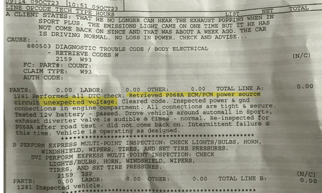

Just got the car back, glad to report all pops and crackles are back. As stated below, they pulled the P068A code and it was cleared. Once again there are no engine mods to this car, this only came up during the removal of the battery following my Alcantara Steering wheel install. Not sure why this is the case to why the pops and cracks go away but its definitely something to be aware of for the DE5 and hope this helps those going forward
Acura Integra CEL under @ 900 Miles 2023-10-09_12-26-29
