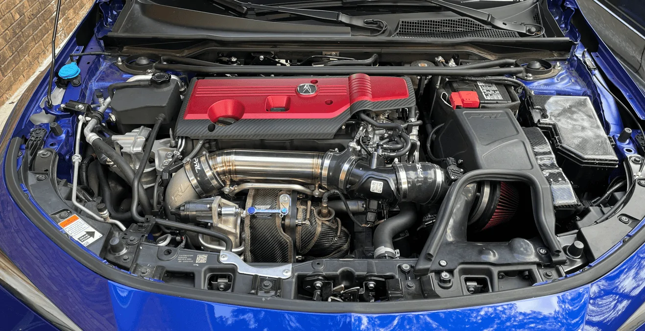

installed Mishimoto expansion tank today

Was interested in this due to issues others have had already but the welds looked kinda sloppy to me. Yours looks ok though - have they gotten better? Do you have a close-up shot?

This is the one to have once the factory part goes. All the other designs are 2 piece which, to me, is just as bad as the factory unit.

Yeah I have had min installed for a few months and it's been solid. I did lightly sand the opening of the fill port since it had powder coat over spray. I was worried about it sealing properly.

Can it be done without special tools for the hose clamps ? Walk me through it
10mm socket, pliers and any kind of vacuum pump to empty the reservoir is all that is needed.
I did use a hose clamp from my carbon fiber infusion kit on the upper hose but it is not required.
you can empty the tank before removing the upper hose and it wont leak.
Posting the install video on my channel this weekend.. https://www.youtube.com/koaticus
What others issues? I have seen any posts about issues with this one other than complaints about the fill windows being harder to see than other aftermarket tanks. it seemed pretty solid to me.

Yeah I got one and installed myself a few months ago too . Pretty easy even for a new like me lol . I got the red one and was like damn a smitch off in red from the valve cover but oh well it is what it is . Should have went black but to late now

I think he means reported issues with other brands of overflow tanks.

The Radium offering is a 2 piece design and the rubber gasket that mates the two halves together is know to fail.
The mishimoto is a single piece fully welded aluminum design. Not gonna leak.

Did you happen to come accross any sources siting Radium tank failure?
Im curious as I've heard this too but wasnt able to find any actual sources.
I prefer the look and sight glass of the Radium over most but dollar for dollar if its going to fail it obviously isnt worth the trouble. Its also a more involved install which may cause headache reversing if necessary, the mishimoto looks pretty straight forward.

I have seen posts with images of that seal leaking. AHC garage did an install using it but applied Honda sealant on the rubber seal.

Good to know!
Def sounds like it isnt worth the trouble, I appreciate the feedback!
Wonder if it would be possible to weld the halves together LOL.
