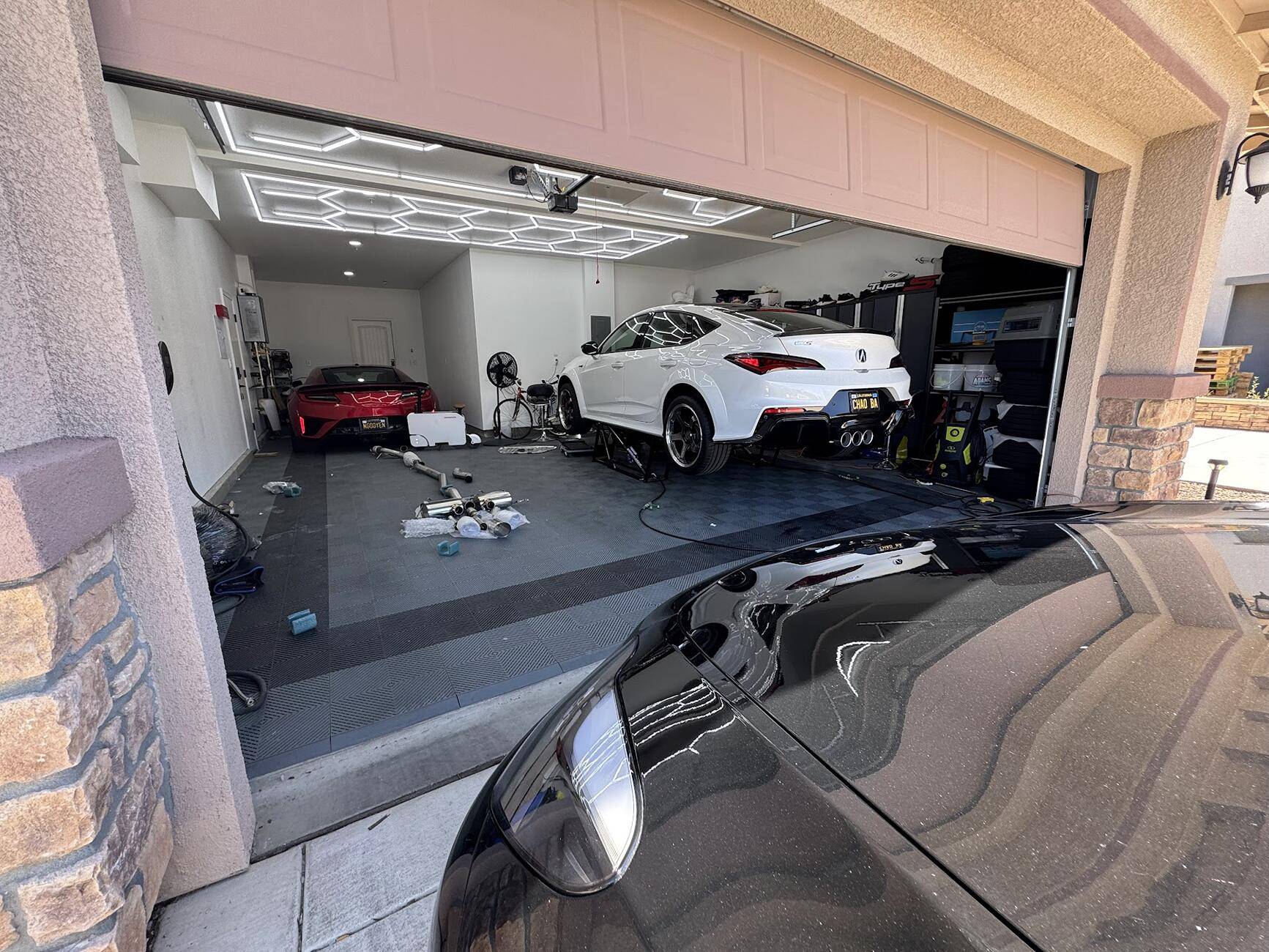

I had them for a bit and they worked well, but never really loved them. Felt like more work than a simple floorjack and jackstands tbh. It's cool raising and lowering the car with a button, but they're pretty annoying to position EVERY time. Plus they restrict side access for stuff like exhaust or drivetrain work on rwd cars. Also very heavy, awkward and bulky to move around. Not to mention the cost. It just didn't feel like it was solving a problem. The only thing it helped with was string alignments being able to lower the car to load up the suspension quickly, measure, and then raise it again to make adjustments.
I eventually went back to my floorjack/jackstands and haven't regretted it. So much cheaper and easier. Someday I'd like to get something that can be driven over and just sit in one spot like the bendpak scissor lifts.
