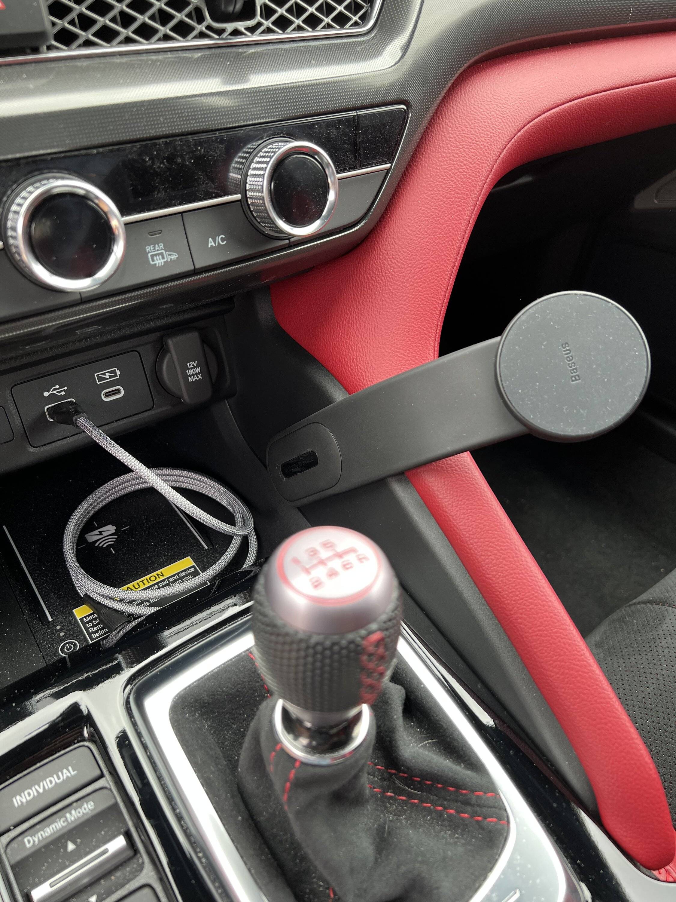

Here's my phone holder solution. I got this magnetic phone holder from Temu for like $7 but shipping took about two weeks. Amazon sells a slightly nicer quality one made by BaseUS for around $20. I like it because it's minimal and also bendable. If you're an iPhone user, the magnets are strong. I'm using a Pro Max in the photo for reference.
For the charging cable, I got the ones from MagTame (also on Amazon). They coil up magnetically so they don't dangle unnecessarily everywhere. It also eliminates the need for a cable organizer. Cable quality is really nice too.
I got mine man! My first mod on the ITS. Nothing fancy, but it definitively looks better than putting the phone in the drink holder. Thank you so much for showing us yours.
To anyone who wants to get the same thing, I got the “Baseus”phone holder and “Magtame” charger cable in Amazon. Delivery was fast AF. Got it in less than 24 hours! (I guess delivery time depends on where you live).
I still have to test it with some spirited runs in the mountain this weekend if it really holds the phone in place. Other than that, cell phone stays put with daily driving.
After installing:
Acura Integra What did you do to your Integra Type S today? 🙋🏻‍♂️ IMG_3364

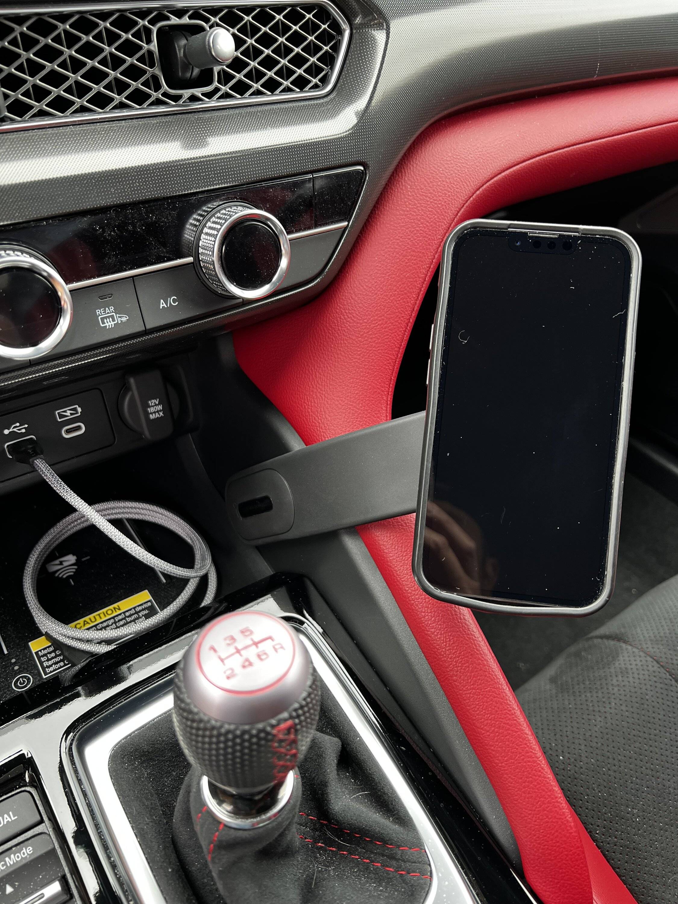

With i-phone attached:
Acura Integra What did you do to your Integra Type S today? 🙋🏻‍♂️ IMG_7788

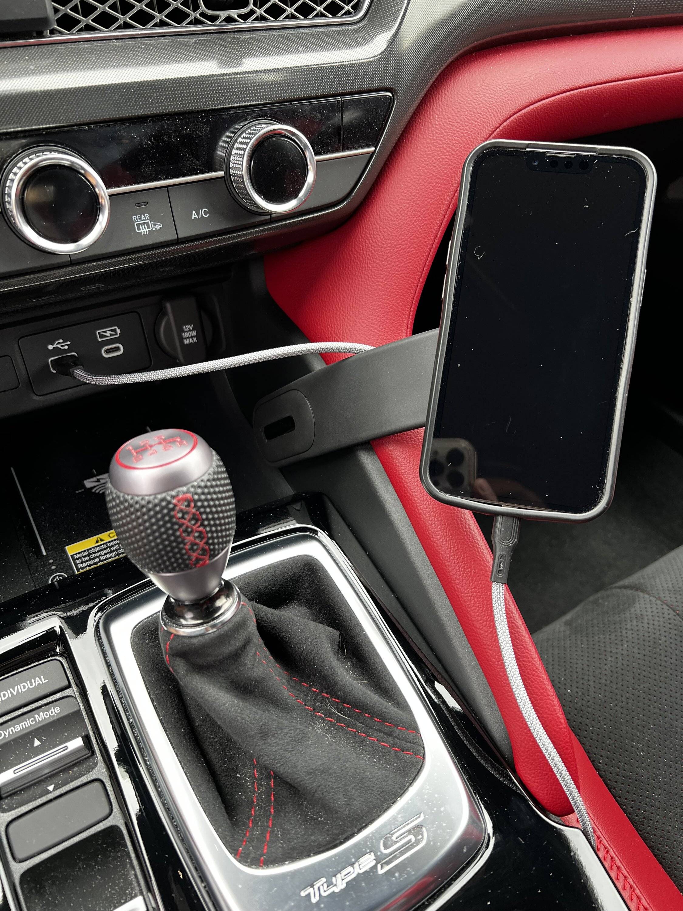

With the MagTame charger cable attached:
Acura Integra What did you do to your Integra Type S today? 🙋🏻‍♂️ IMG_7789
