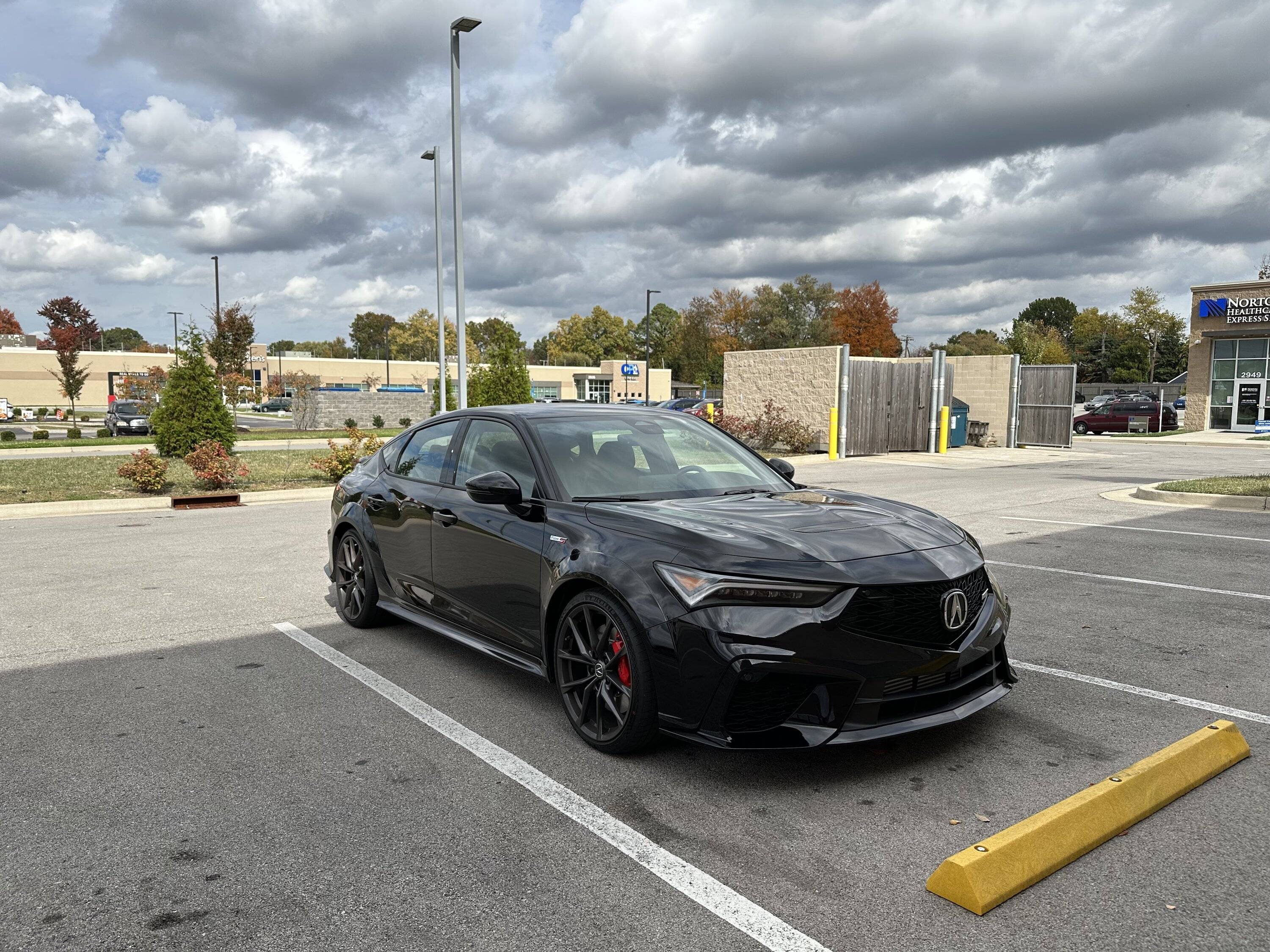

Finally got my plates on Friday. The cloud reflections were crazy and look like dirt smears but promise it's clean!
Love it. Some black caps for your license plate bolts would really set it off though.

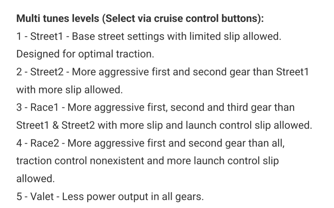

Flashed Phearable Stage 2 tune, needed off-road. I'll let you know how it does compared to the 93 hondata tune. I did find out that Hondata's traction control only works with the cars cruise disabled, gauges touching each other. Wonder if this would have improved the 93 tune feel.
Congrats! I finally got mine jailbroken and have the Hondata 91 loaded. Looking into Phearable or IMW, I have the TSP DP so I can leave the secondary 02 enabled. Does the Phearable tune support Multitune or will it shortly?
Yes it supports multi-tune.

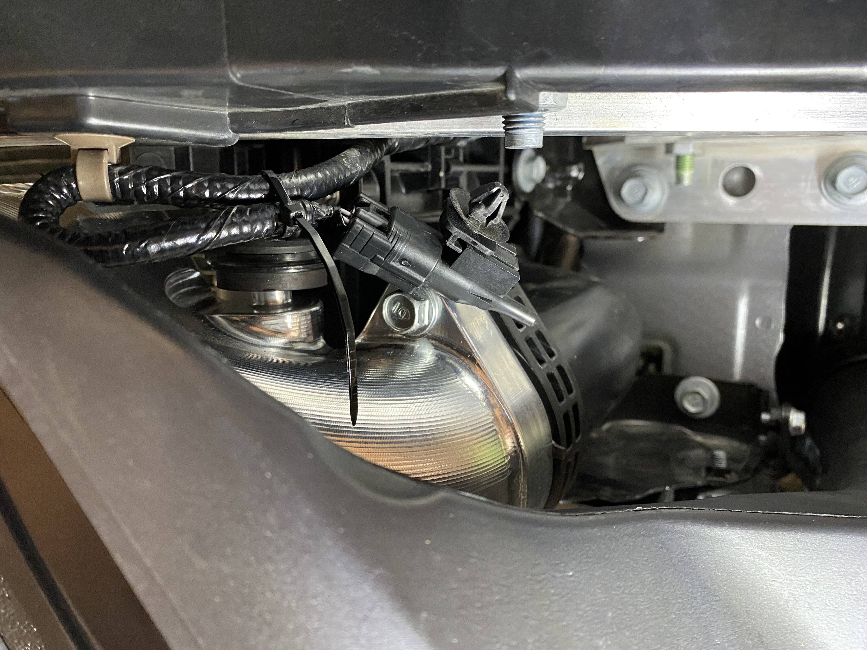

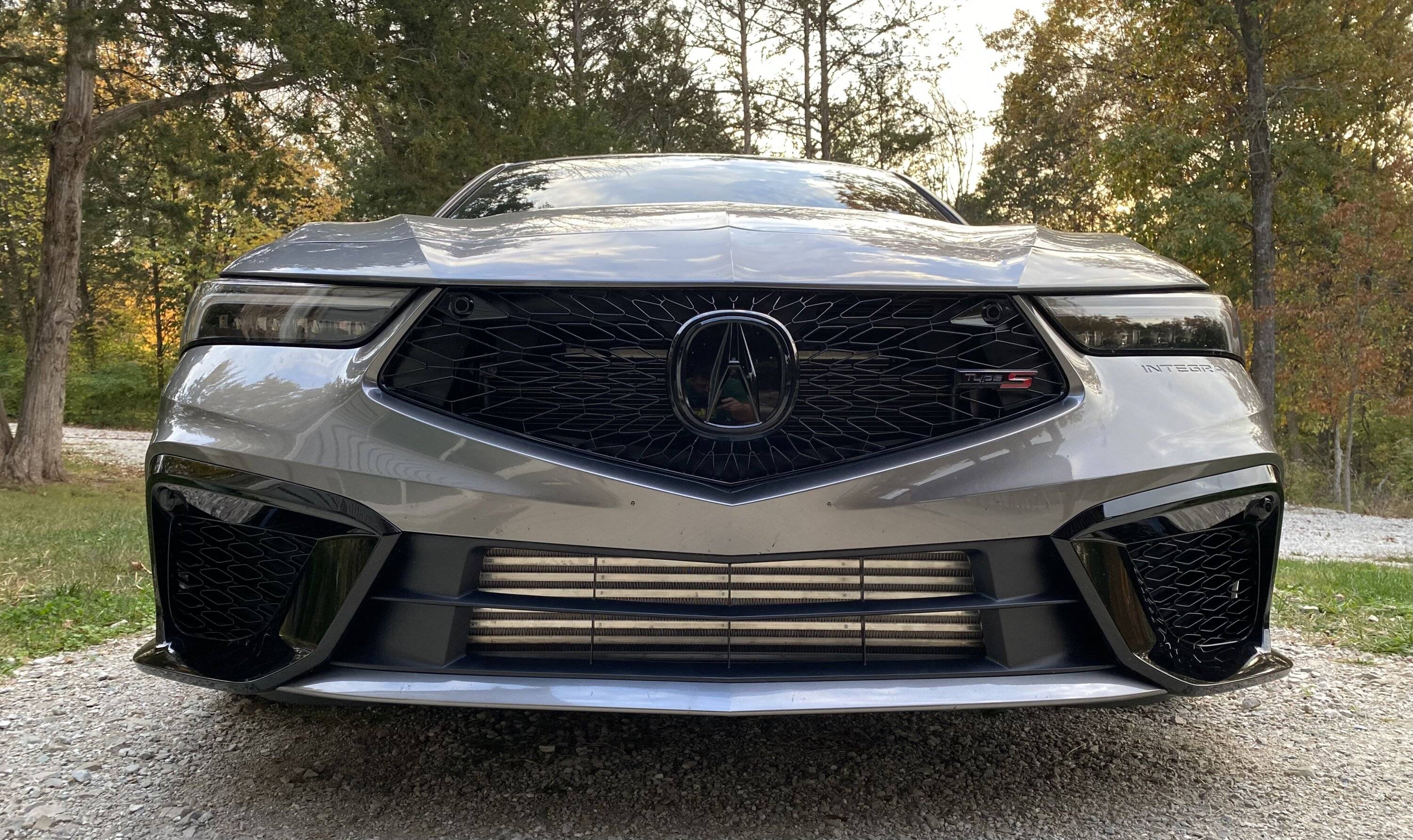

Got the PRL intercooler on last night. Artwork Bodyshop to arrive on Halloween.
A few notes - ambient sensor should be relocated for clearance. The side & bottom internal air guides behind the center matte black grill need to be removed for clearance. The rubber/plastic guards go onto the brake ducts to prevent scratching or noise from vibration. The front bumper is a bitch. I got it close to perfect mounting it back on, but a couple flaws. It will be fixed in time.
The car blasts!

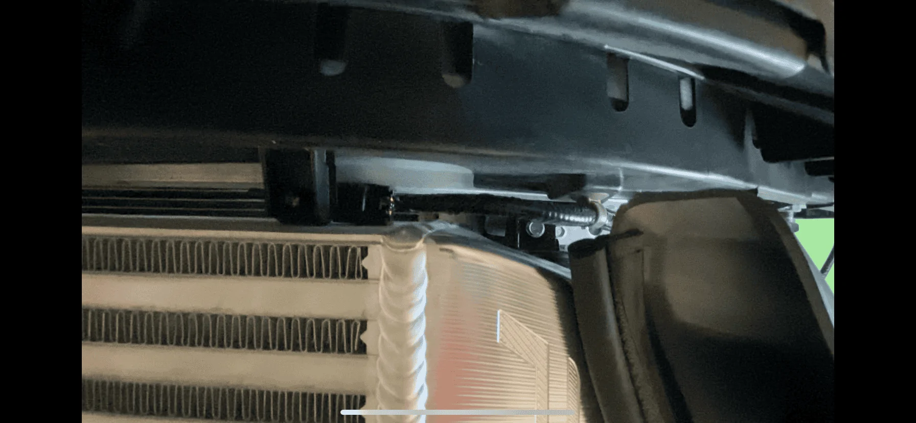

Oh..I drilled a hole and remounted the air temp sensor. I followed what PRL showed for the FL5
I didn't even look at anything besides the AHC video for it & chatted with Arry since he's installed it already. He did mention a couple things like that were different than the FL5. Hole or zip tie, either or is good to function I think. Maybe I'll do that when I take the bumper off again next time though. Charge pipes will be out soon.

Someone needs to make a Type-S stencil for the intercooler. Would look awesome!
That's a great idea! Surprised no one's thought of that yet! I definitely didn't want the same stencil everyone else has either.
