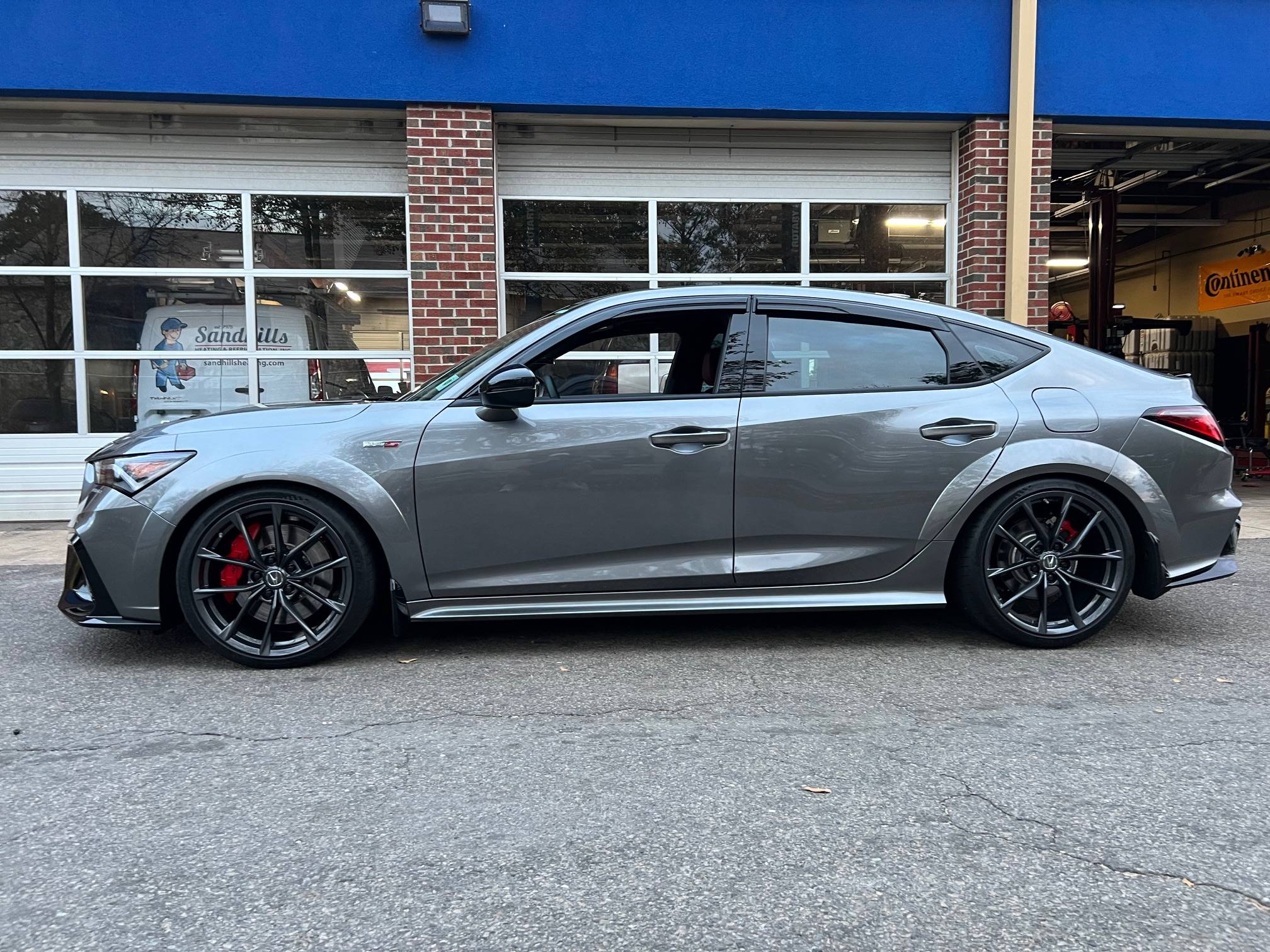

Eibach Prokit Springs installed yesterday. So far I will say it's definitly a but more stiff/abrupt than stock. That's to be expected of course and doesn't bother me at all. Comfort setting on dampers is still fine. Sport+ amps it all up of course. I keep the individual mode on all the time (except track) with dampers in comfort, steering in sport, and exhaust/gauges in sport+.
The stance is great. Tight one finger gap all around. Rear may be a couple mm's tighter but almost exactly the same gap. Stock rims with 15mm spacer front and 20mm spacer rear. Also threw on the Eibach rear sway bar. (need to grease that up a bunch more as it's pretty squeeky)

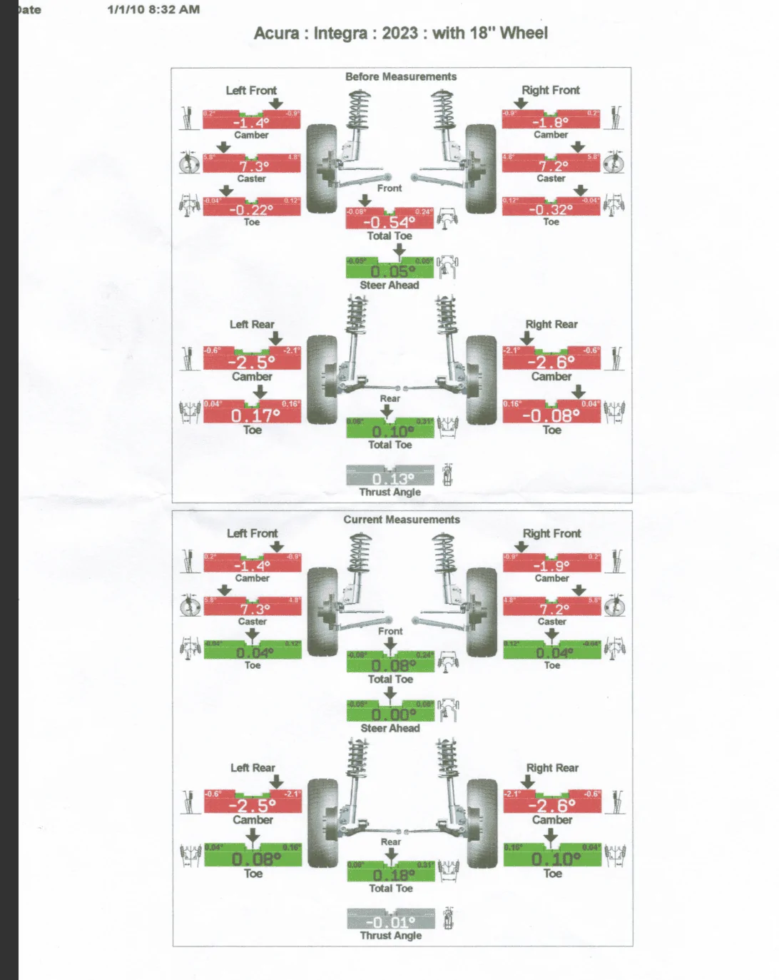

Had the shop do the alignment right away, as I always do. I'll attach the printout here. Of course, they scanned the vin and they did not have the car in the computer, so they chose the 2023 base Integra for the baseline on the alignment, then just dialed it in as good as the car will allow.
Bottom line is I'm happy with results, and I suspect I would have been just as happy with the H&R's.
(sorry about the alignment being on here twice, something I did when doing the copy/paste)

Looks great.. I would call whomever did your alignment because it shows Integra with 18" wheels and not the type S with 19s. Suspension is a lot different...

Yes, I know. Unfortunately they did not have an ITS in the computer. The machine reads actual values and he just adjusted it the best he could, given the limitations of the ITS suspension. No camber adjustments available. Anybody have any insight on this? If the toe is correct and caster acceptable, car is driving straight etc, what should I be on the lookout for? I hate going to the dealer. LOL. Have a tough time trusting them.

Here's the FL5 CTR specs. Looks like you're in the neighborhood, but may have too much negative camber in the rear. Keep an eye on the tire wear. That said, if you've changed the rear sway bar it may be better to have more negative camber in the rear, to keep it more neutral. Can't say for sure, it depends on how you're using the car.

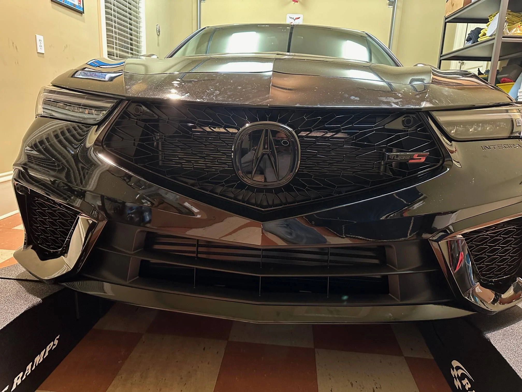

Install a black PRL intercooler. Took a while but finally finished it. Thankfully no CEL. Thanks to Trajectory009 and the ITS Facebook group for the help and advices. Now I have to find where the two extra plugs came from...lol

Looks good! You will have extra plugs from removing the liner under the Intercooler as they don't go back in.

Nope, no rubbing at all. Fronts are stock wheels sitting at a +45 offset now, and rears are stock wheels sitting at +40 offset. You can buy new rims with either of those offsets and you should be good all the way around, or run stock with spacers. If I buy rims, i will go with +45 all around just to have some wiggle room with tires, like if I wanted to go 275 width, etc.
