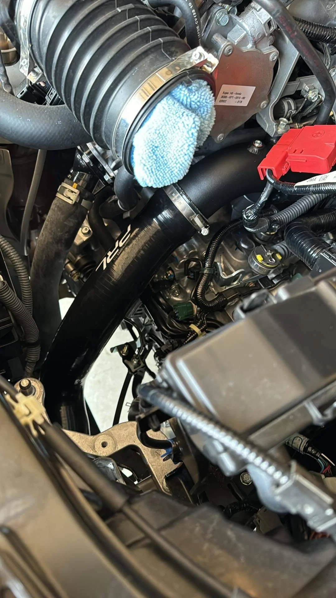

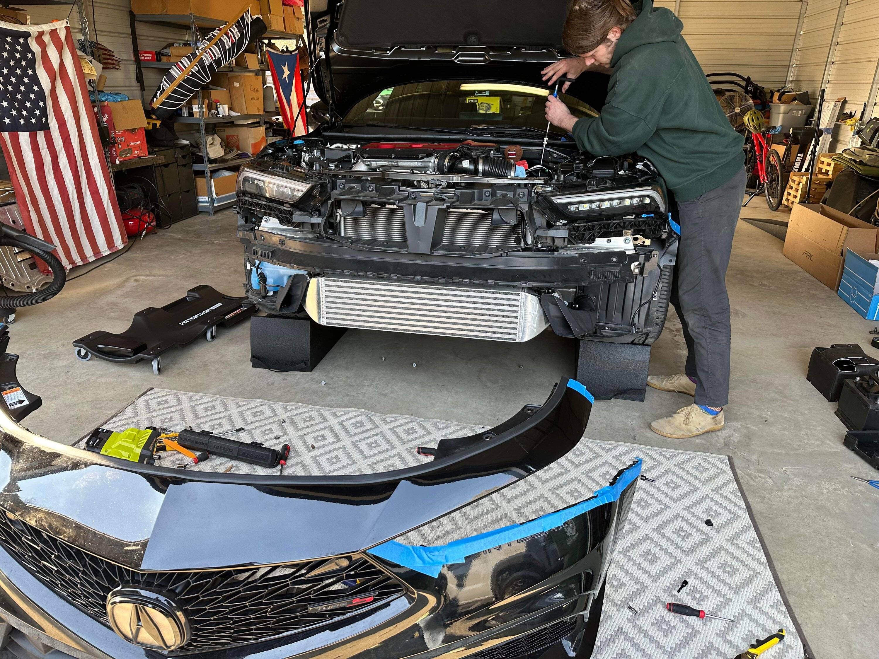

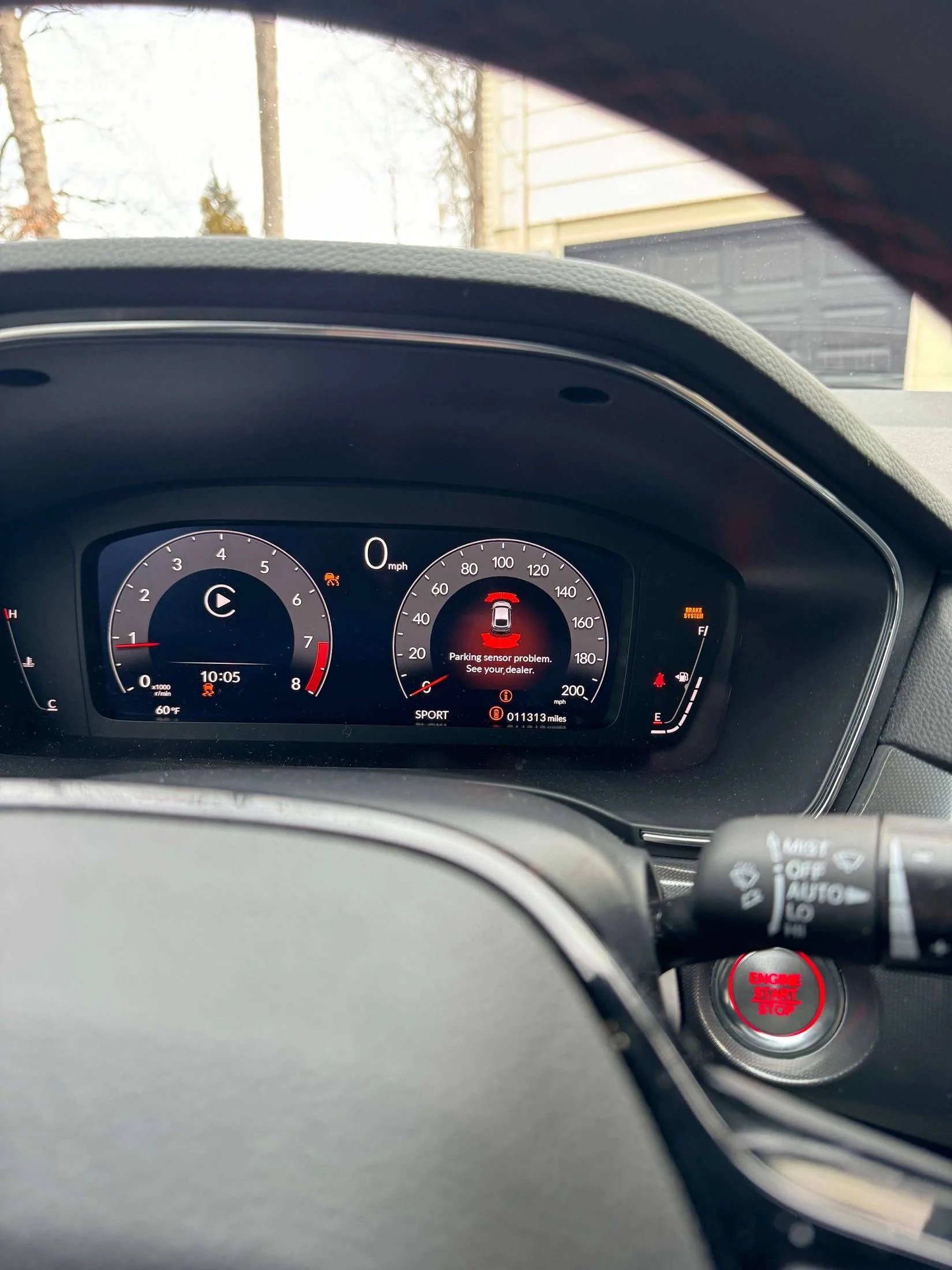

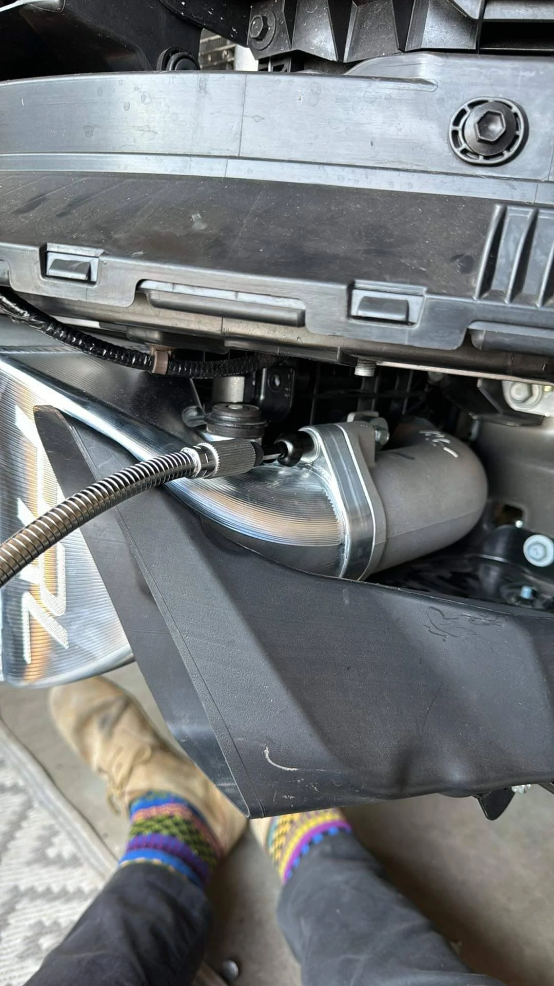

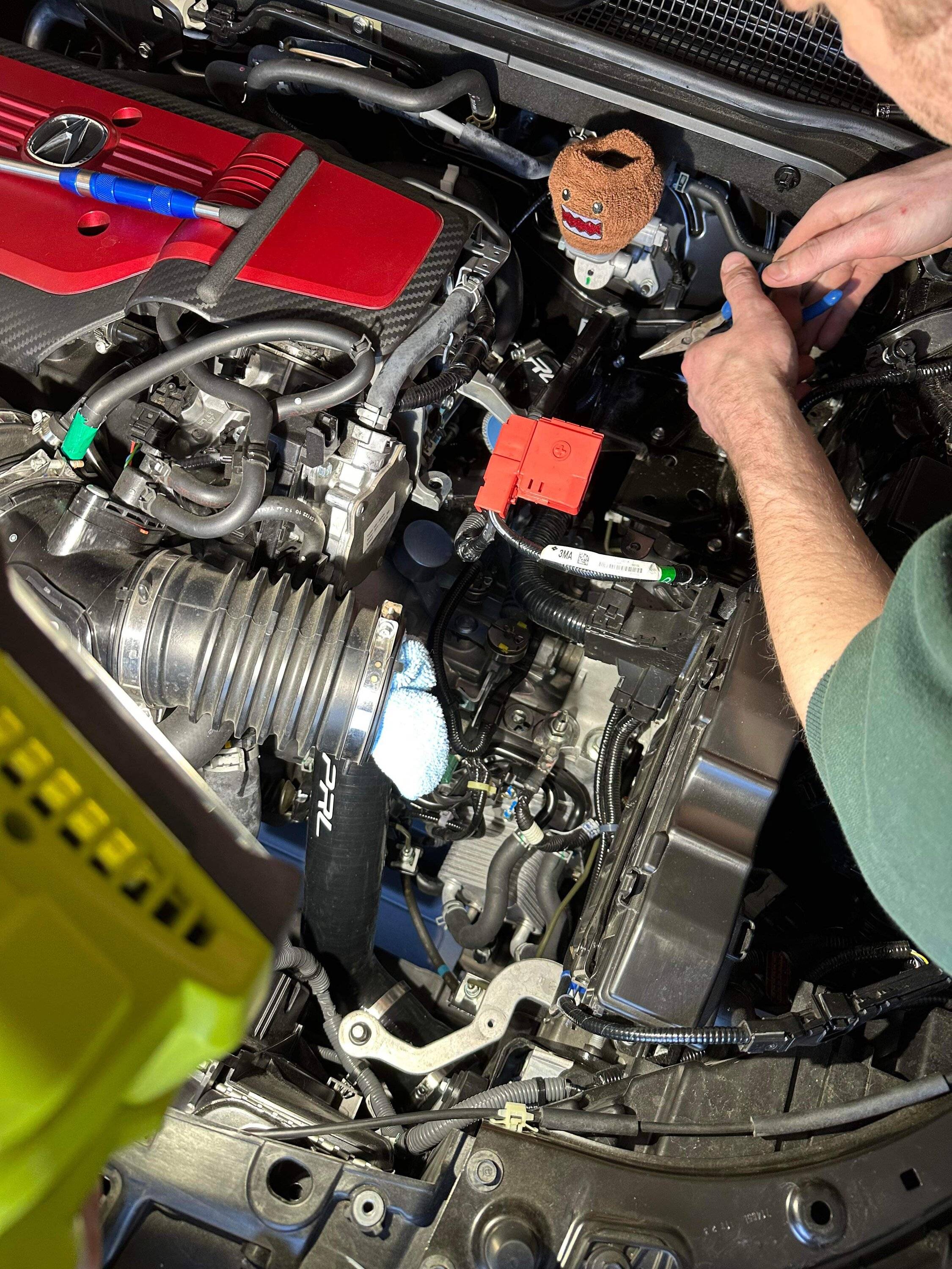

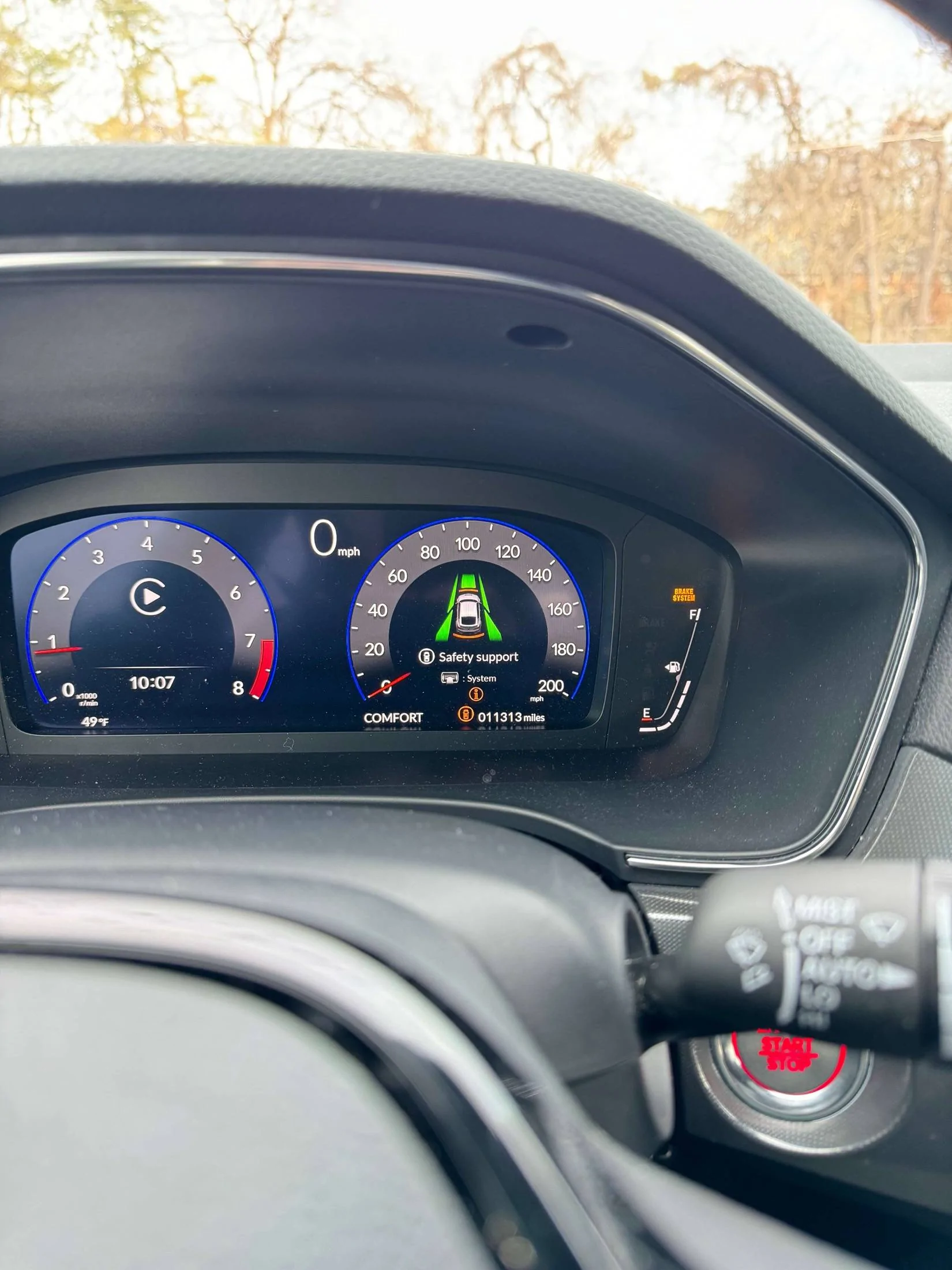

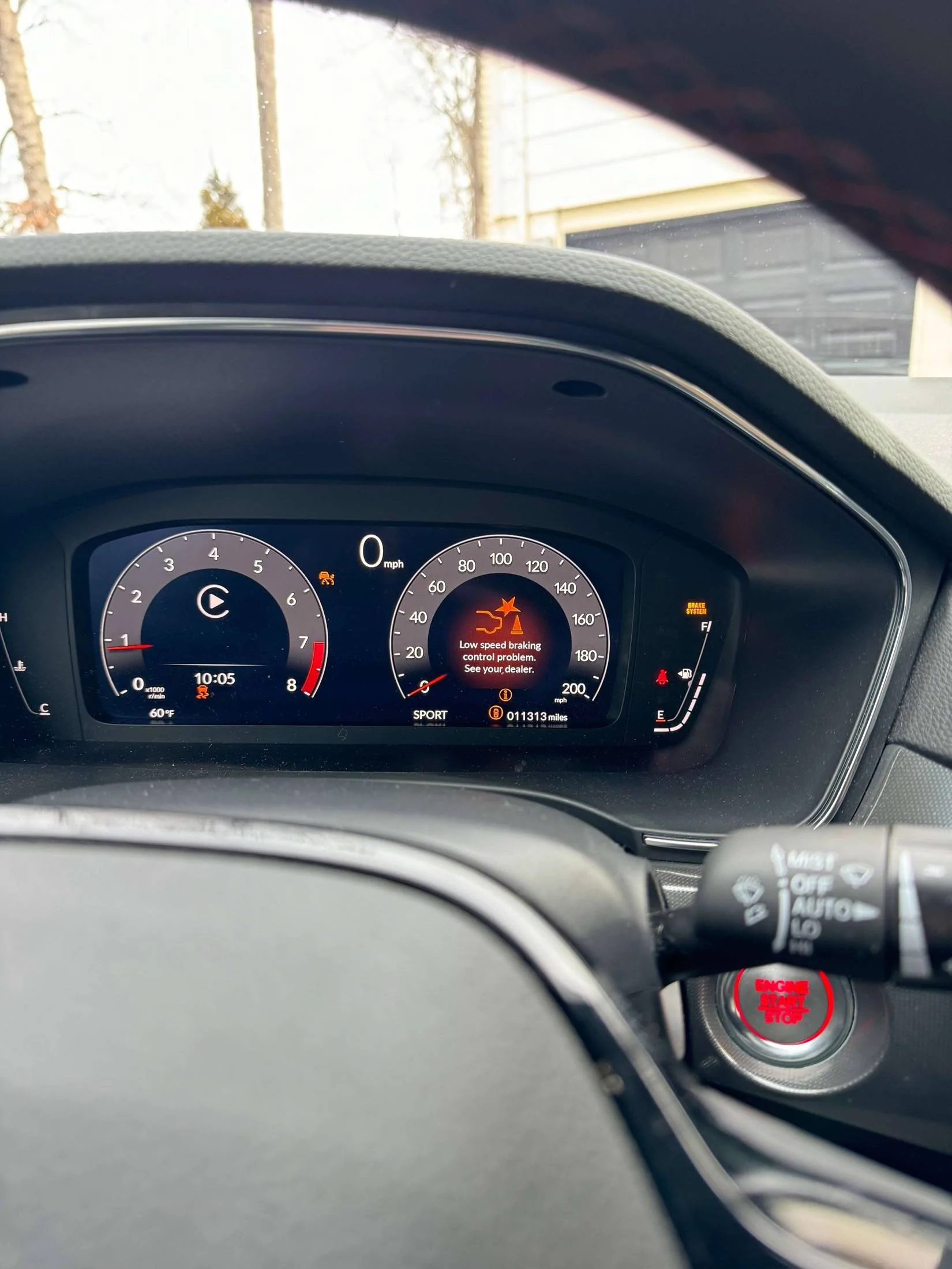

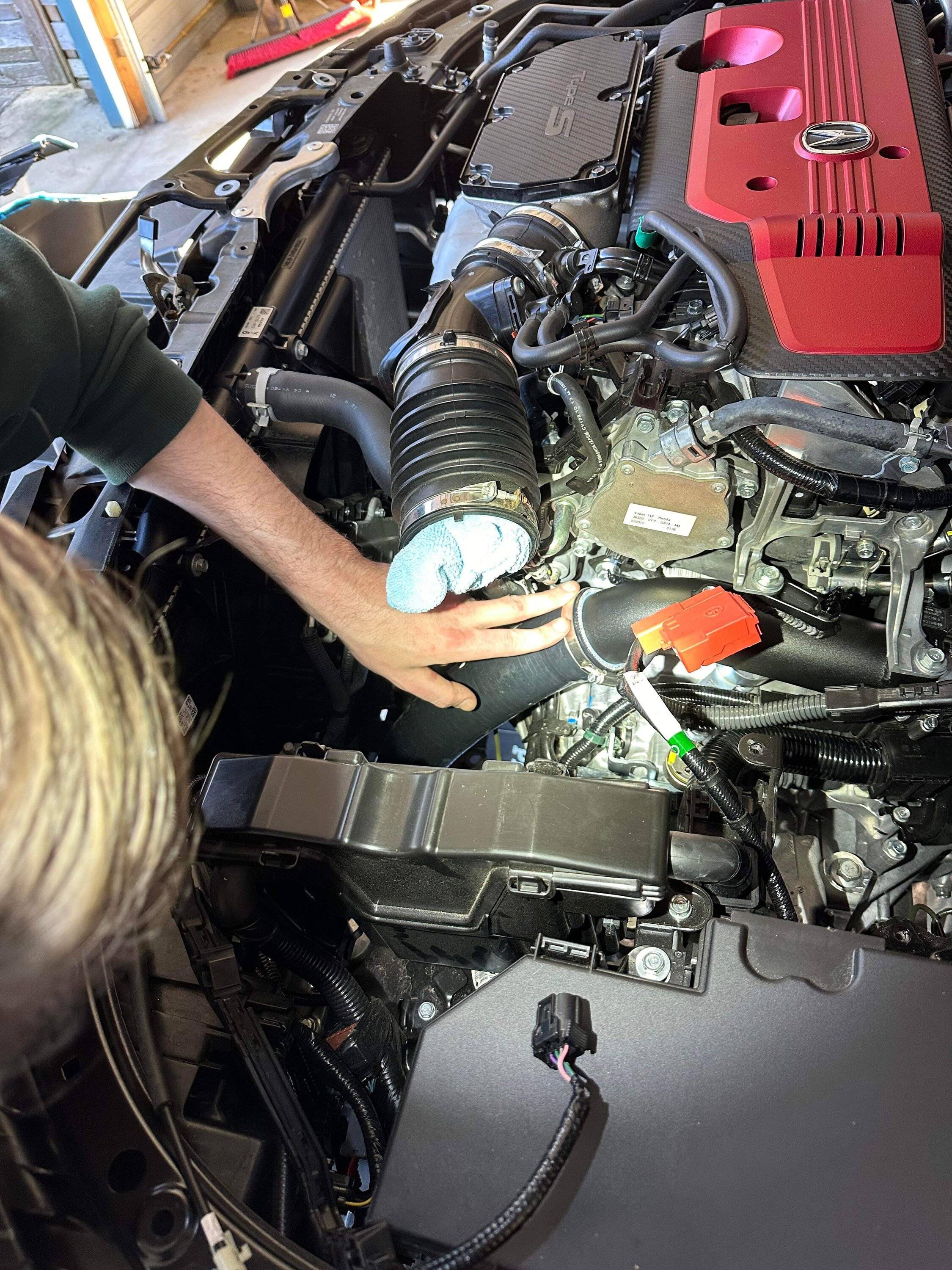

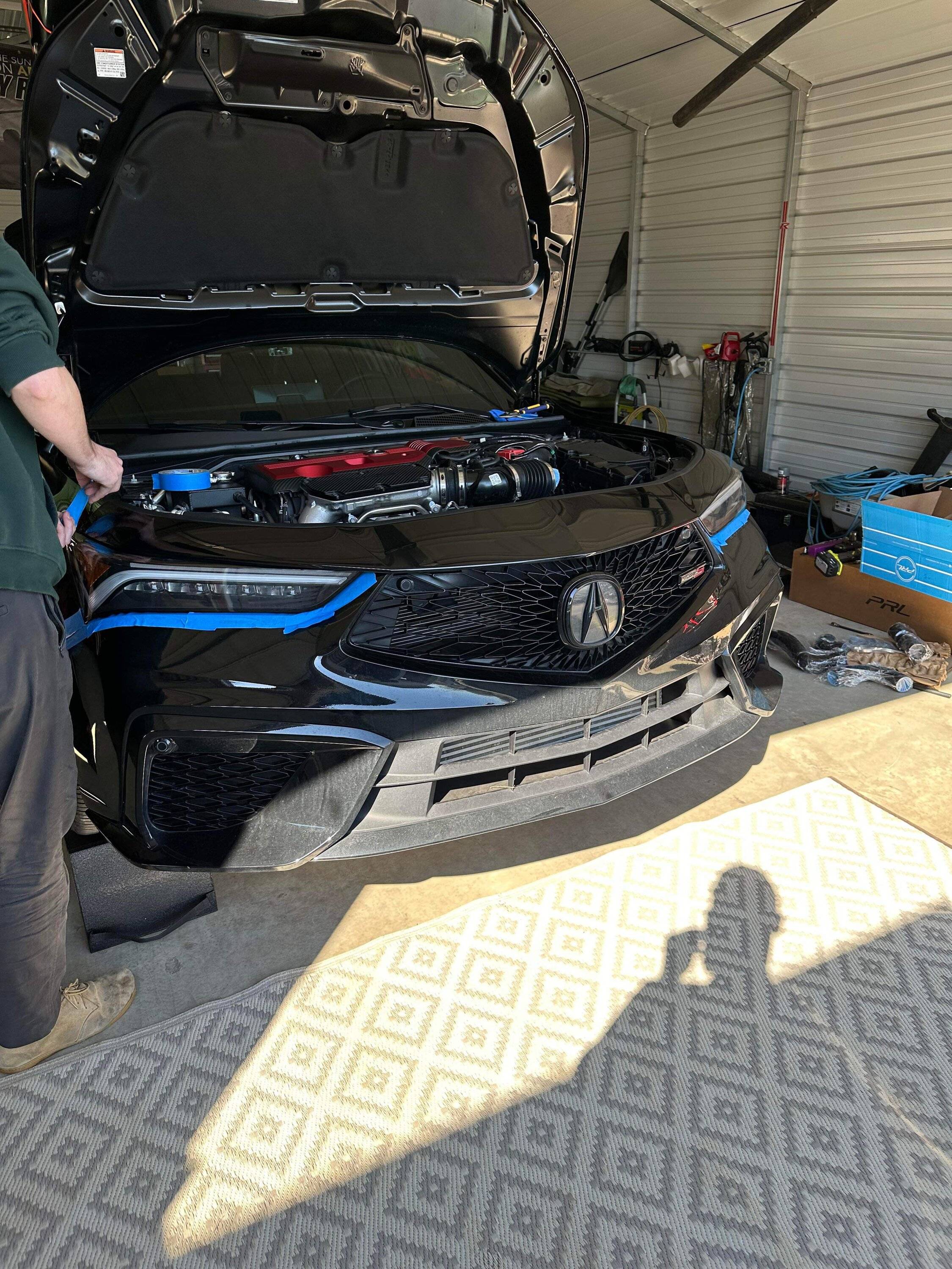

Installed PRL intercooler and charge pipes yesterday. Also messed up something with the sensors in the front bumper 🤦‍♂️

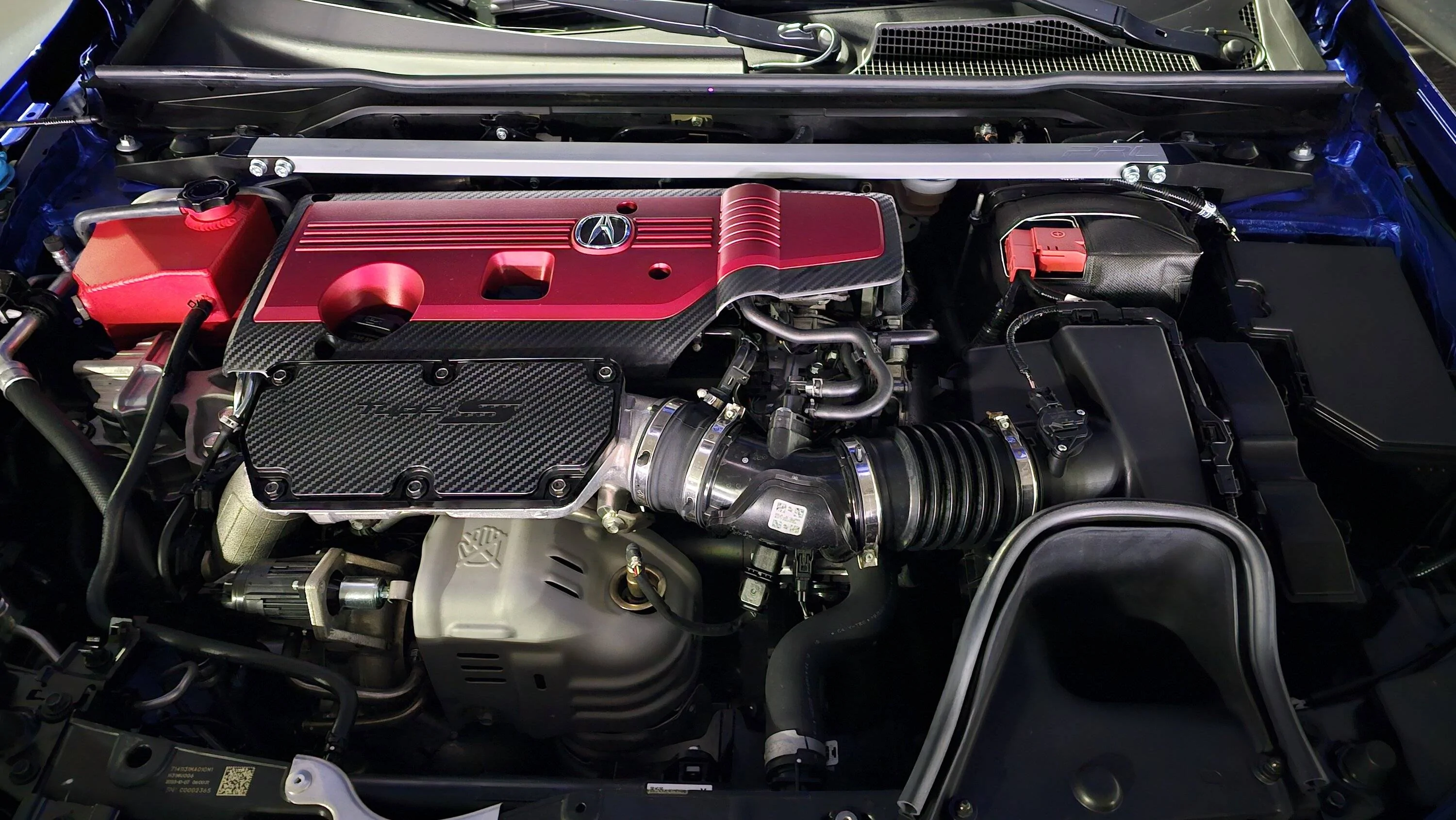

1600 miles in and not waiting for the coolant reservoir to start leaking so replaced it with the Mishimoto aluminum reservoir. The description still says FK8 but definitely fits the DE5.
PRL Strut Tower Brace as well. Torqued to 46 ft/lbs if anyone is curious since the instructions don't state it.
PRL Rear motor mount. Torqued to 69 ft/lbs. No pic since I forgot. Definitely feel the vibration at start up but probably still needs to break in a bit. No more bad wheel hop!

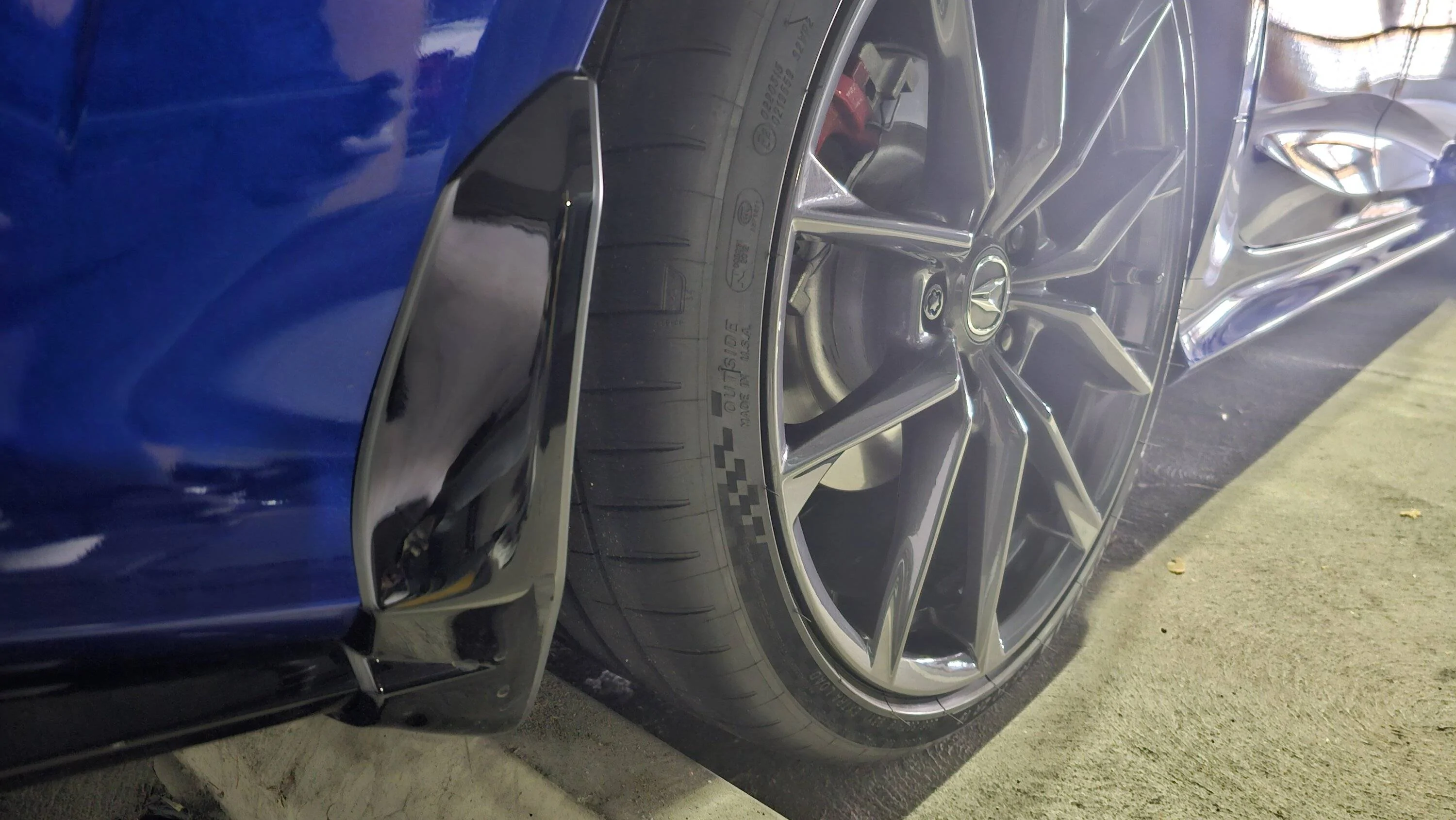

Also installed the splash guards.

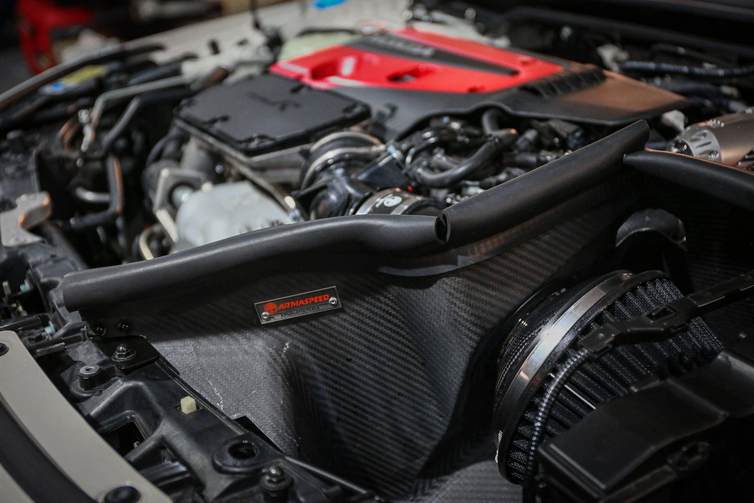

Interesting. I wonder if the rubber trim will be cleaned up and not split into small segments like shown.
I'm not sure until it arrives but it doesn't bother me. I'll post pics and small review after I install and test it out. May be another month or so.

Do these fl5 intakes even fit? My understanding was the intakes wouldn’t work across both but maybe I’m wrong

I had one for my e46 M3 a few years back. The sound was awesome, and it looked pretty sweet when the hood was open. lol
Even with that I couldn't believe I spent $1K+ on an intake. The one for our cars is $1650? Yikes. it definitely looks good. (If someone else does it first and it sounds great...maybe me 2nd) Who's going to be the guinea pig?

Looks pretty generic. If it bothered you, you could probably replace it with a single strip.
