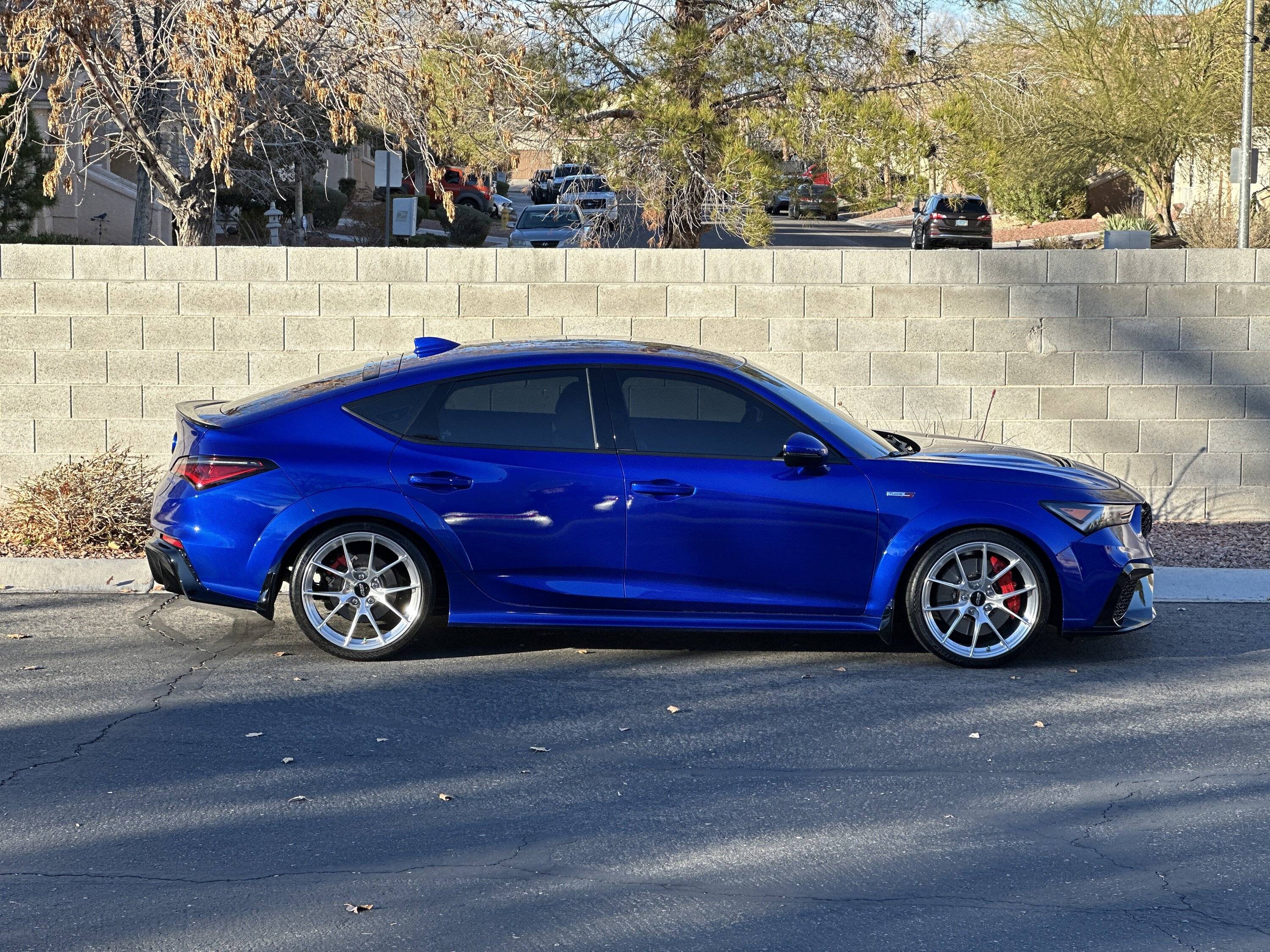

I ordered from evasive motorsports, it’s the same ones for the FL5, the drop is mild, .75” in the front and .6” in the rear.
finally got around to getting the apex wheels mounted and a quick wash for the meet I’m heading to tonight.

Looks good

Looks sweet. Will you give us the specs on the wheels and tires? Thanks.

Need lots of pics of those wheels! Those are what I want to go with too.. sexy

Is that the brushed clear? That finish has been growing on me, plus it'll never show curb rash lol

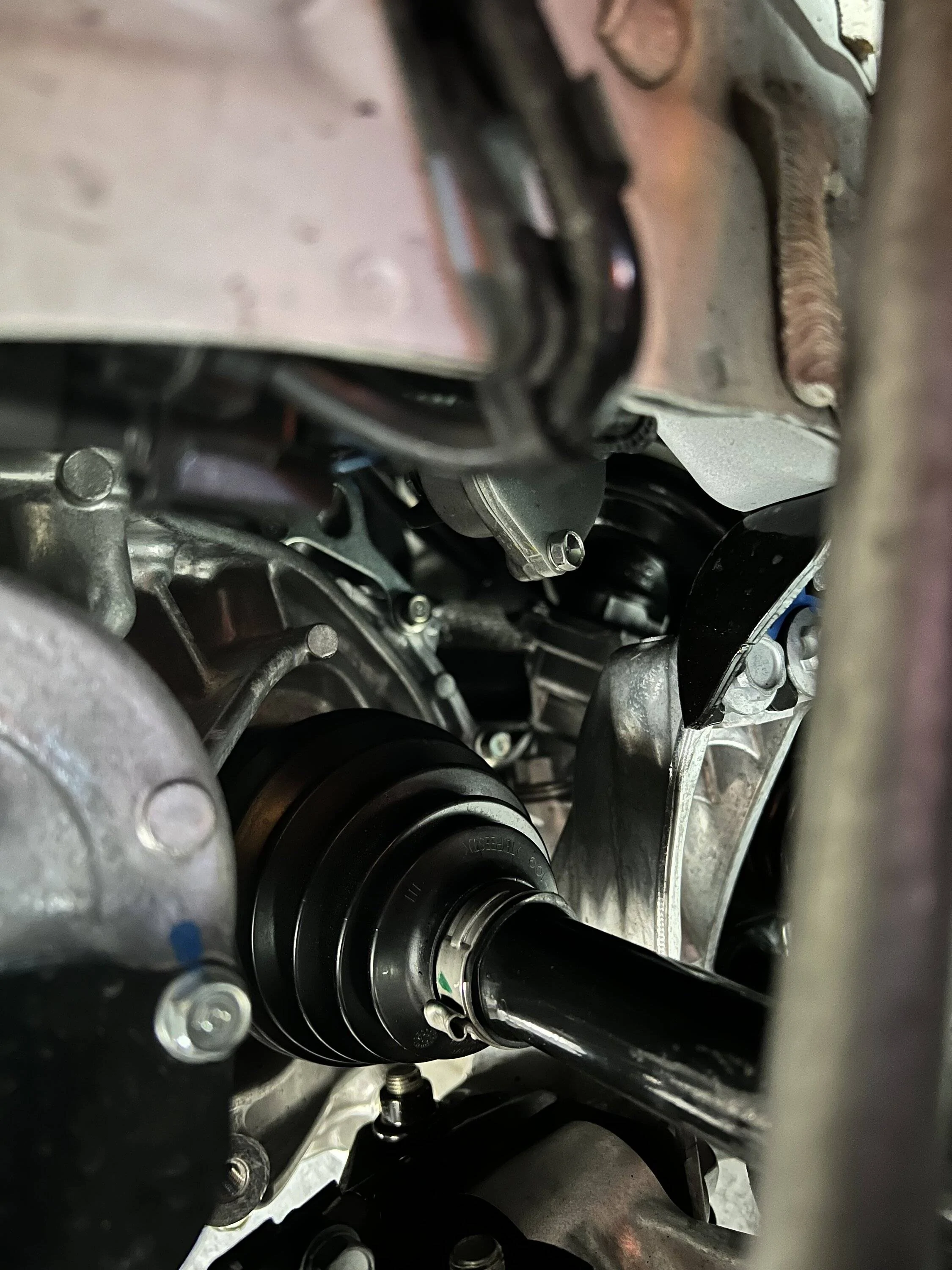

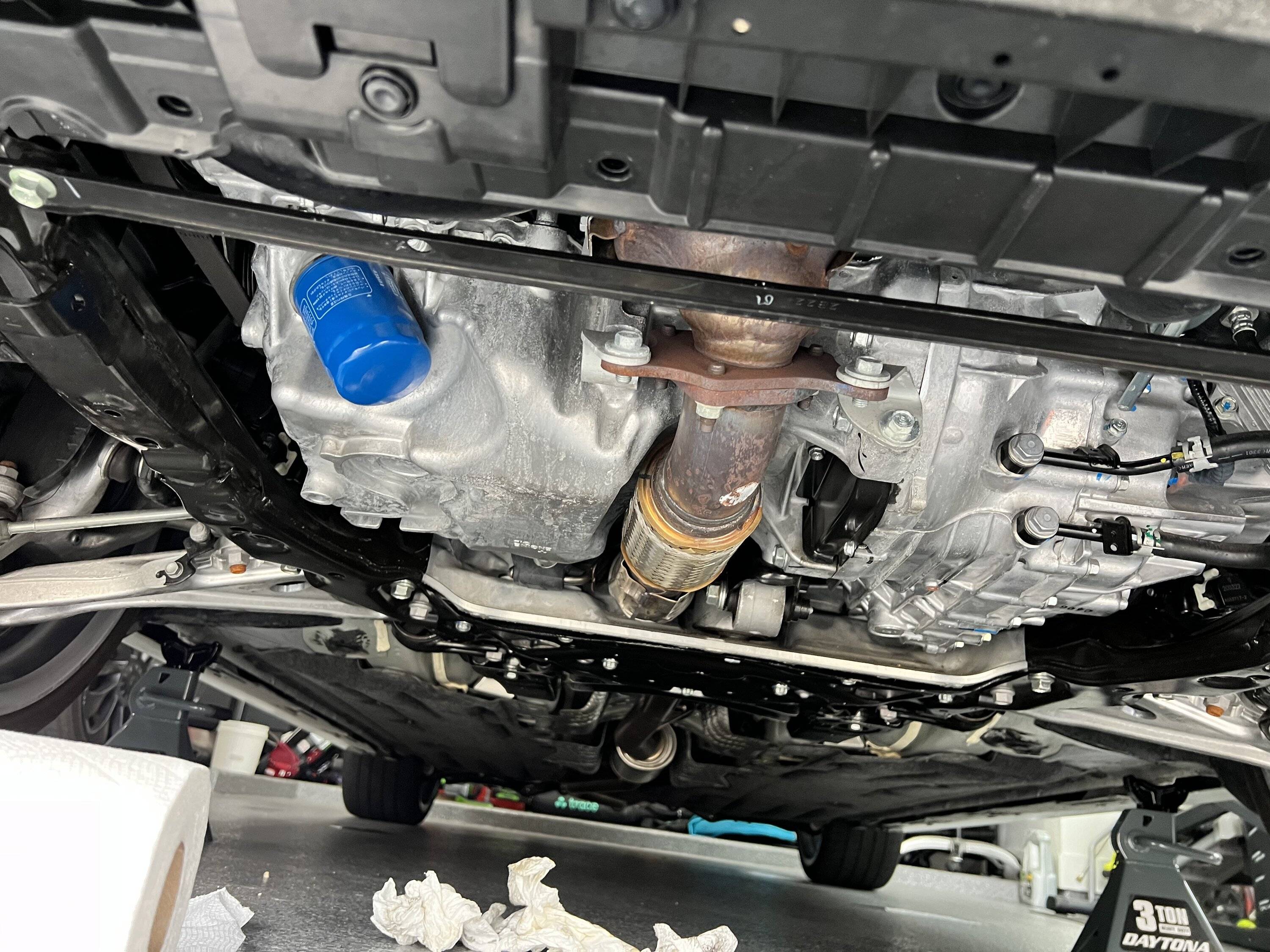

Don’t know where else to ask this…. Did my eibach springs 2 weeks ago car seems good no big deal. Didn’t drive overly to much till was able to get an alignment done yesterday. Got home from left car outside to wash her. Walked in garage and noticed oil like fuild on the floor Changed the oil 500
Miles ago and was laying all over the floor doing springs I would have noticed. So that brings us to now. I have the front end up and took apart all the under trays and looks like the oil is transmission oil maybe coming from

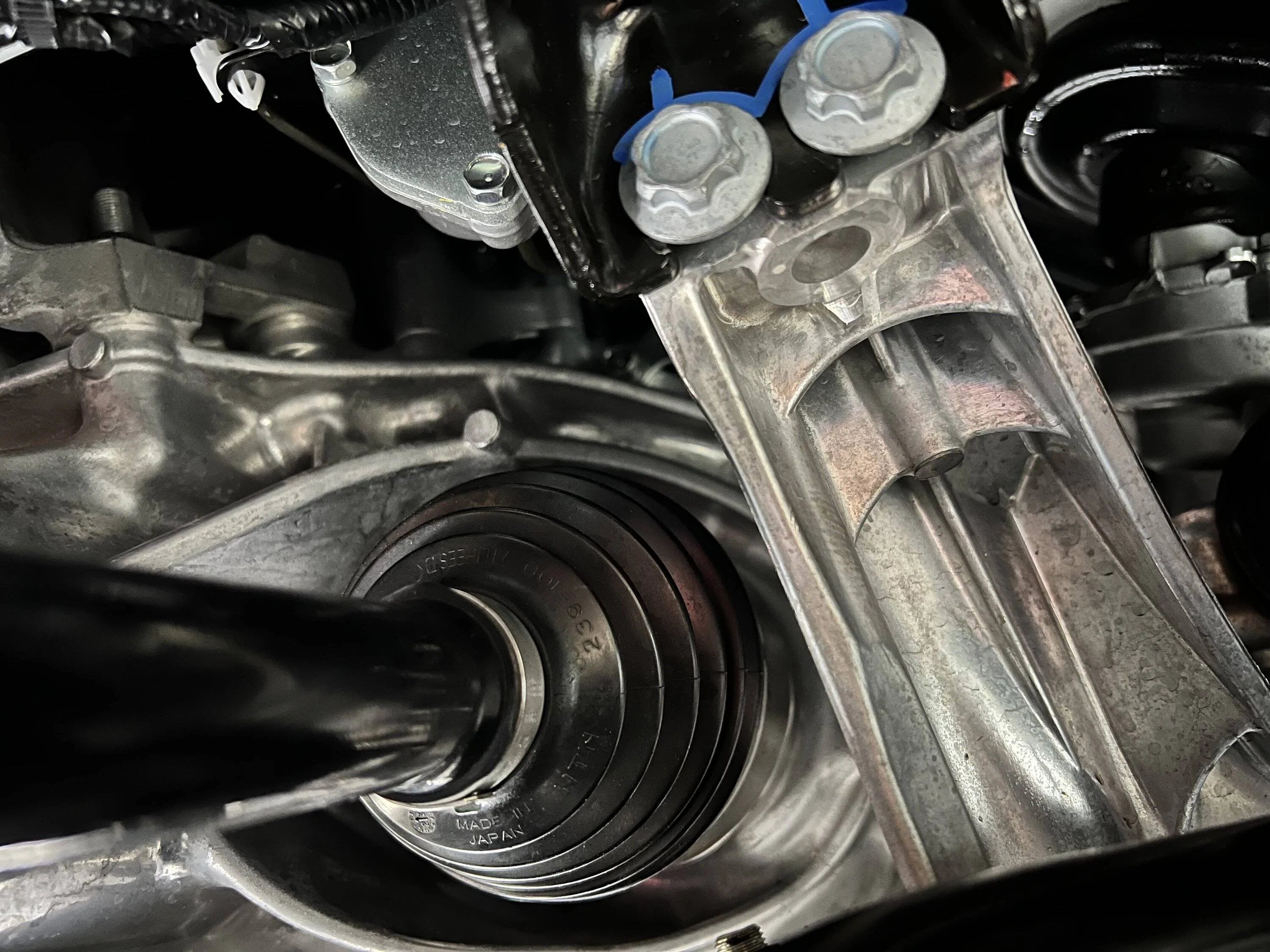

The drive side axel. My axels did come out during spring install. Wondering if that could or just been some coming out when it came out. Or I could have a bigger issue. I’m cleaning it all up now. Ha I told the wife I wanted something to wrench on 🙂

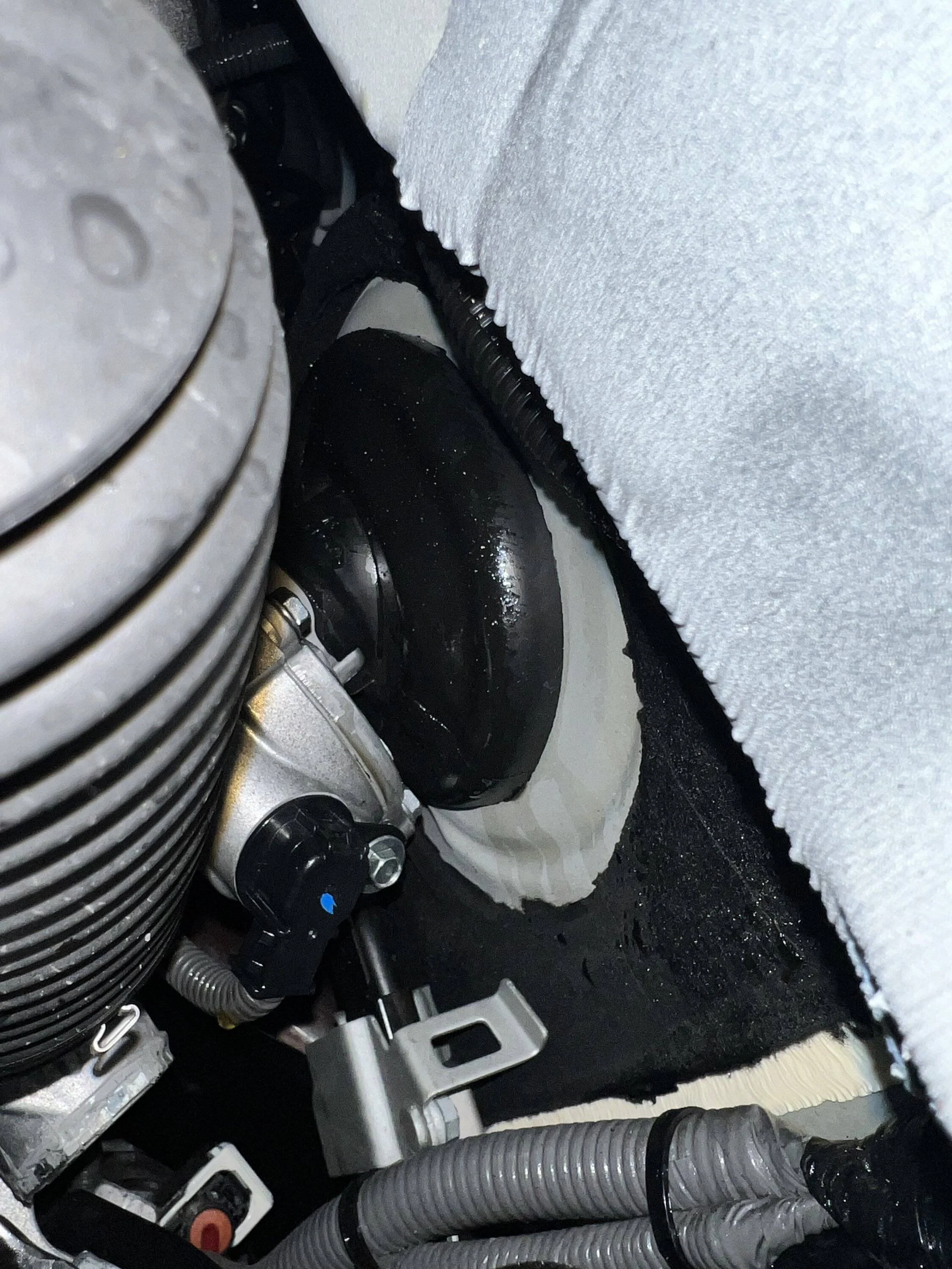

hard to tell anything in the pictures most of the splatter is all over the seal around the streering arm. I don’t know about to call the shop see if they noticed any of this while under it. Feel like they could have seen it. Just hard with all the under trays ? I don’t know.
It is indeed transmission fluid. A spring that holds the axle seal likely broke when the axle came out during the spring installation. Make sure no pieces made their way into the trans. It is a cheap part. It makes a mess if you've been driving, so just be careful and clean best you can- it will eventually burn off, but could be a little stinky.
Part # you will need is 92305-RT4-003
