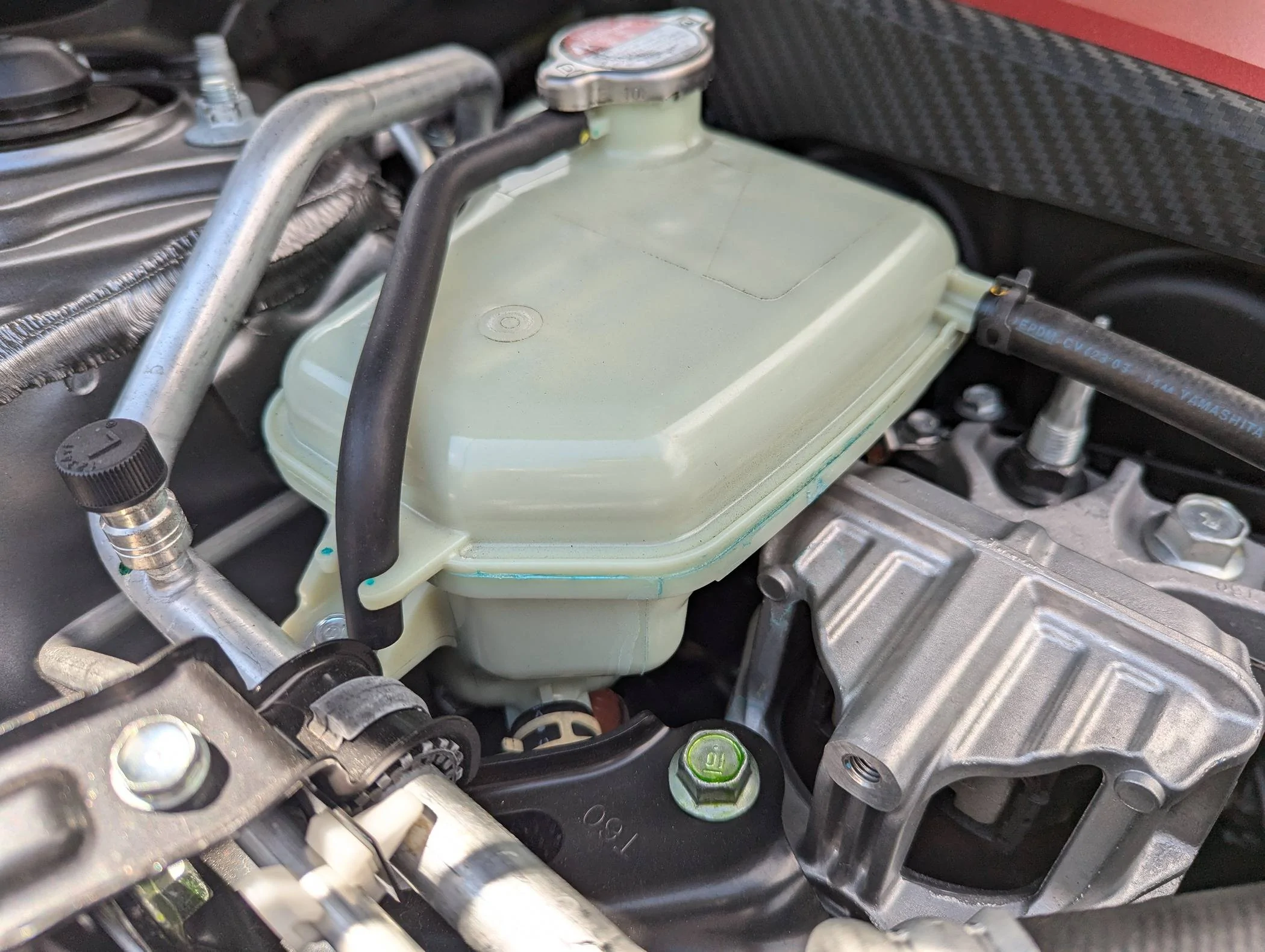

add me to this list! less than 1 yr old (bought in August '23, probably among first production run last year) and less than 1600 miles. will have to get around to installing the mishimoto tank that's been sitting in my garage earlier than i thought i would.

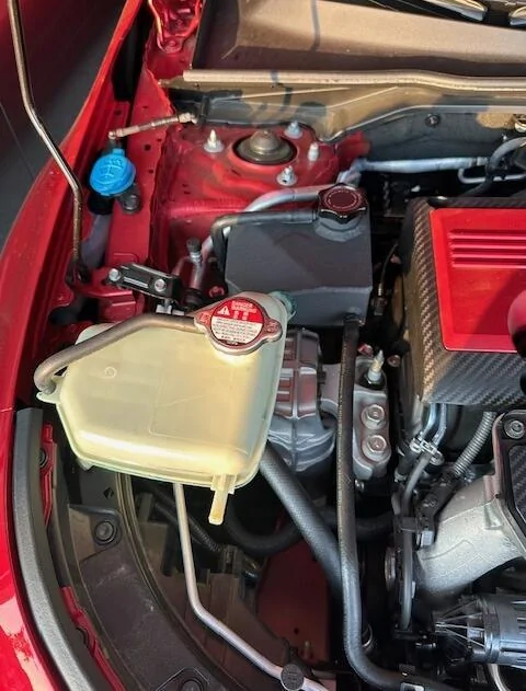

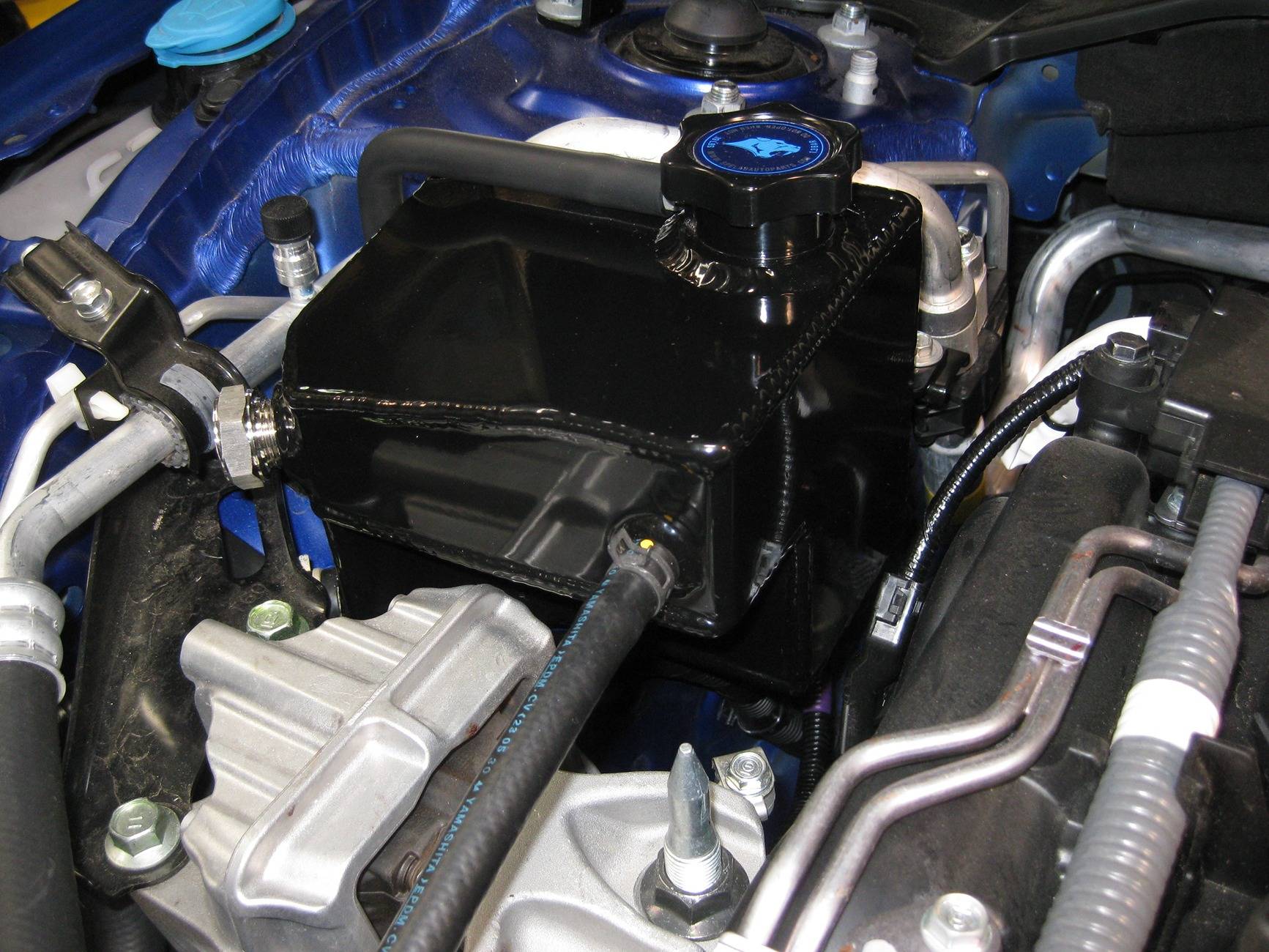

Another victim here, just went Mishimoto. Not even 5K miles Easy install better piece of mind.
Acura Integra Integra Type-S Expansion tank failure. 2024-08-23_11-48-47
Acura Integra Integra Type-S Expansion tank failure. 2024-08-23_11-48-25
Acura Integra Integra Type-S Expansion tank failure. 2024-08-23_11-48-12

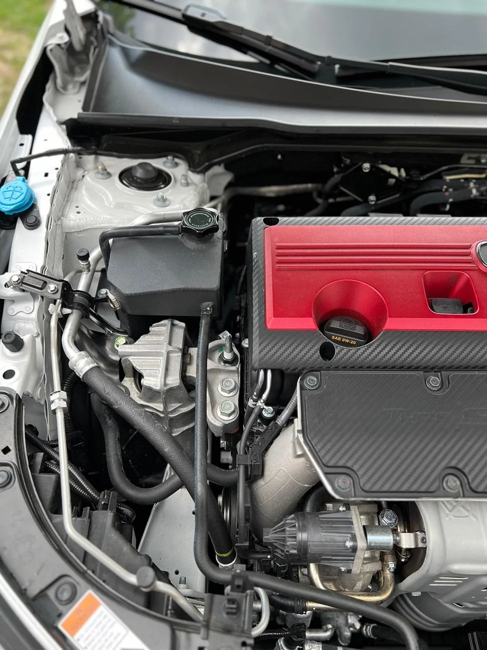

The Mishimoto is worth it for the piece of mind. Got one in mine and the install was pretty easy ......... ;-)
Doskiller
Kevan
Aug 1, 2024
Virginia Beach, VA
2023 Civic Type R FL5
I got ahead of the game as well. These tanks are going to crack ........ it's just a matter of time.

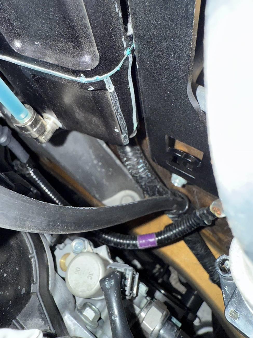

Lower cost alternative? Has anyone tried one of these: https://flasharkracing.com/products/2017-2021-honda-civic-type-r-aluminum-coolant-reservoir-degas ? $139.99 -20% (coupon code COVE20) = $111.99 shipped free, no sales tax. Thought I would ask before I pull the trigger.
I went ahead and bought it and installed it today. It's all good and the discount code COVE20 still works as of today. See details here: https://www.integraforums.com/forum...himoto-expansion-tank-today.52383/post-884834.

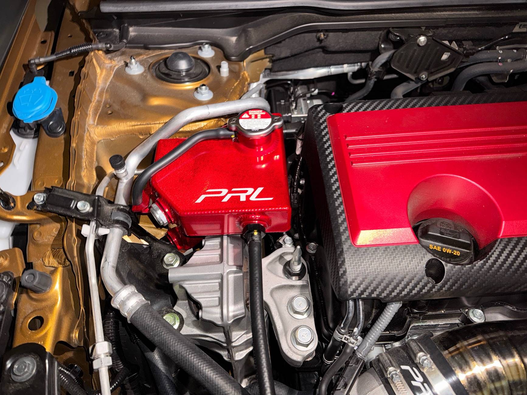

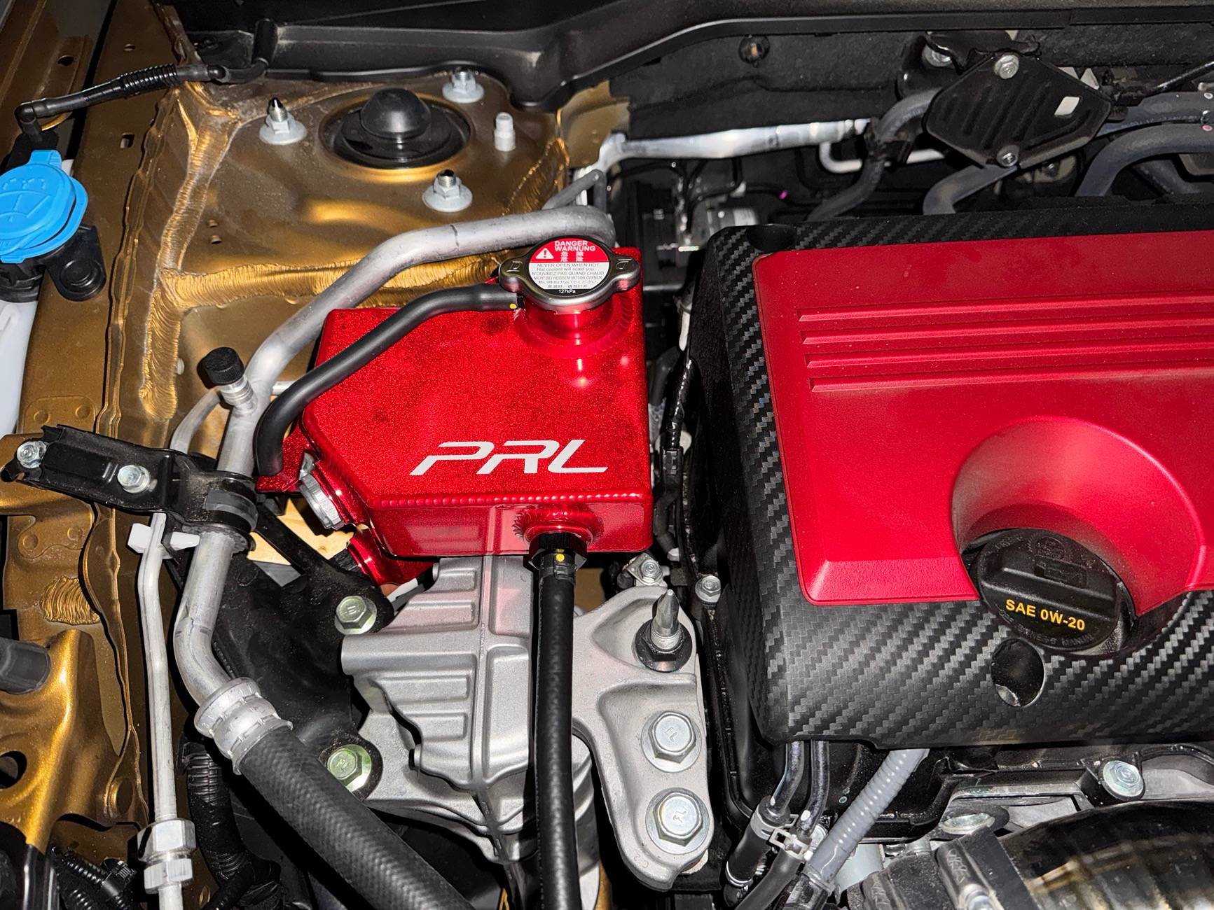

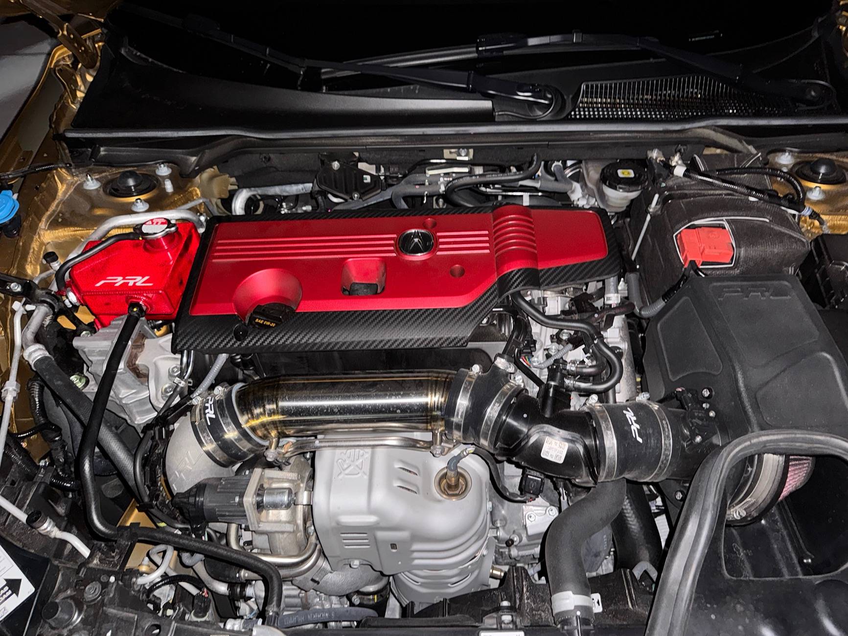

Installed the PRL tank last night, I did not have any issues with the stock one but wanted to get ahead of the game just in case. That bottom hose was a pain to get disconnected. Came out nice.
I like the red on red. Do you have a link to where you purchased it? Thanks!
559
411
the design on this is similar if not identical to the mishimoto right?
I like this one because the welds look so much better to me than the mishimotos.
