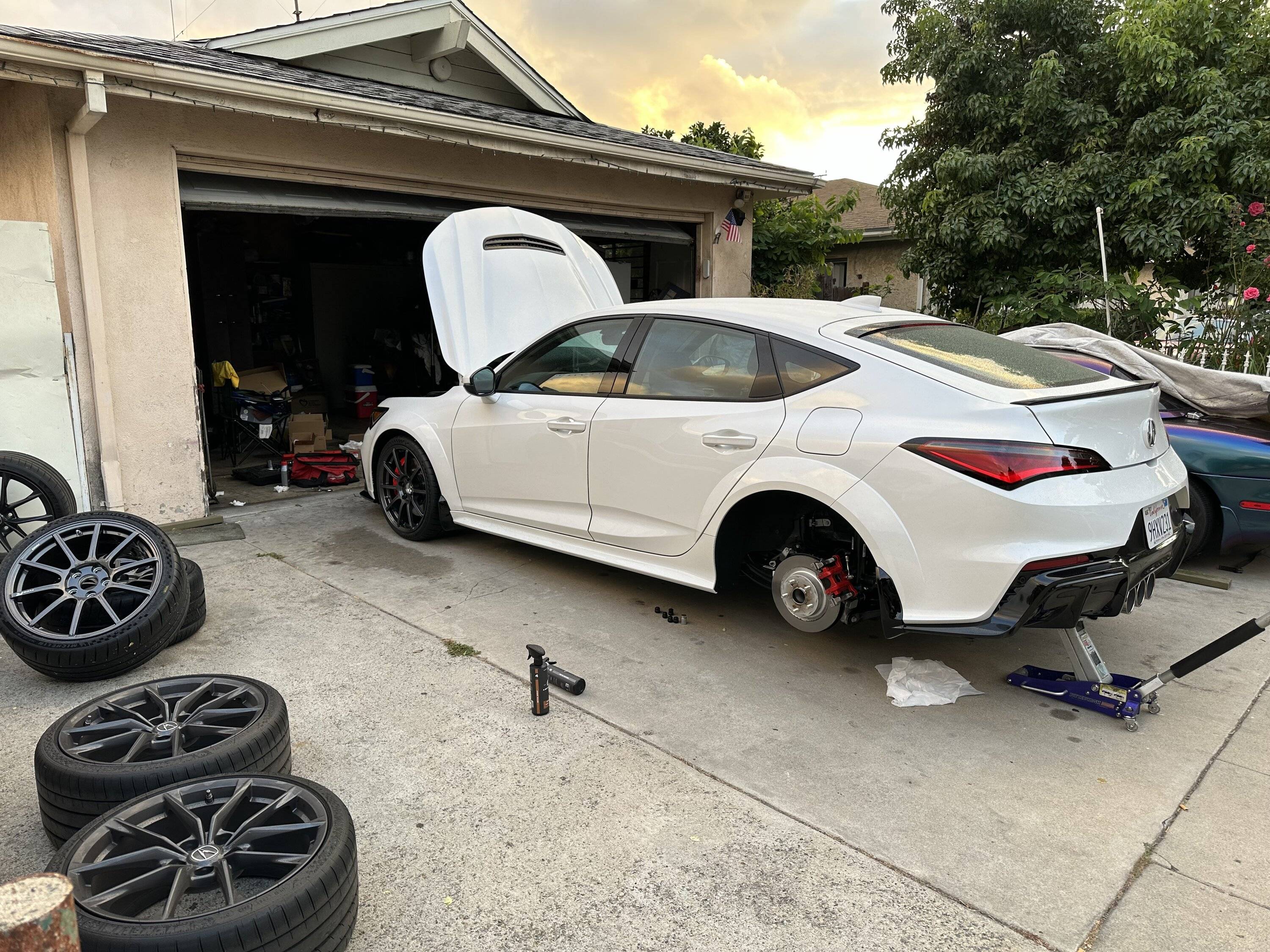

yes, I used the rear jack point. You’re correct, the pic posted (which is also found in the PDI instructions) is for an FL5. I had to use a small wood block to clear the diffuser, the cutout is kind of small; if you’re looking directly at exhaust from the rear, it’s to the left of the exhaust tips, looks like a square metal block protruding down. Worked well, bled brakes and changed wheels

In that particular instance in that photo, I actually didn’t use jack stands 🤫
interesting that there wasn’t enough clearance to place jack stands, I’ll have to check to see if that’s also the case with my floor jack. Will let you know

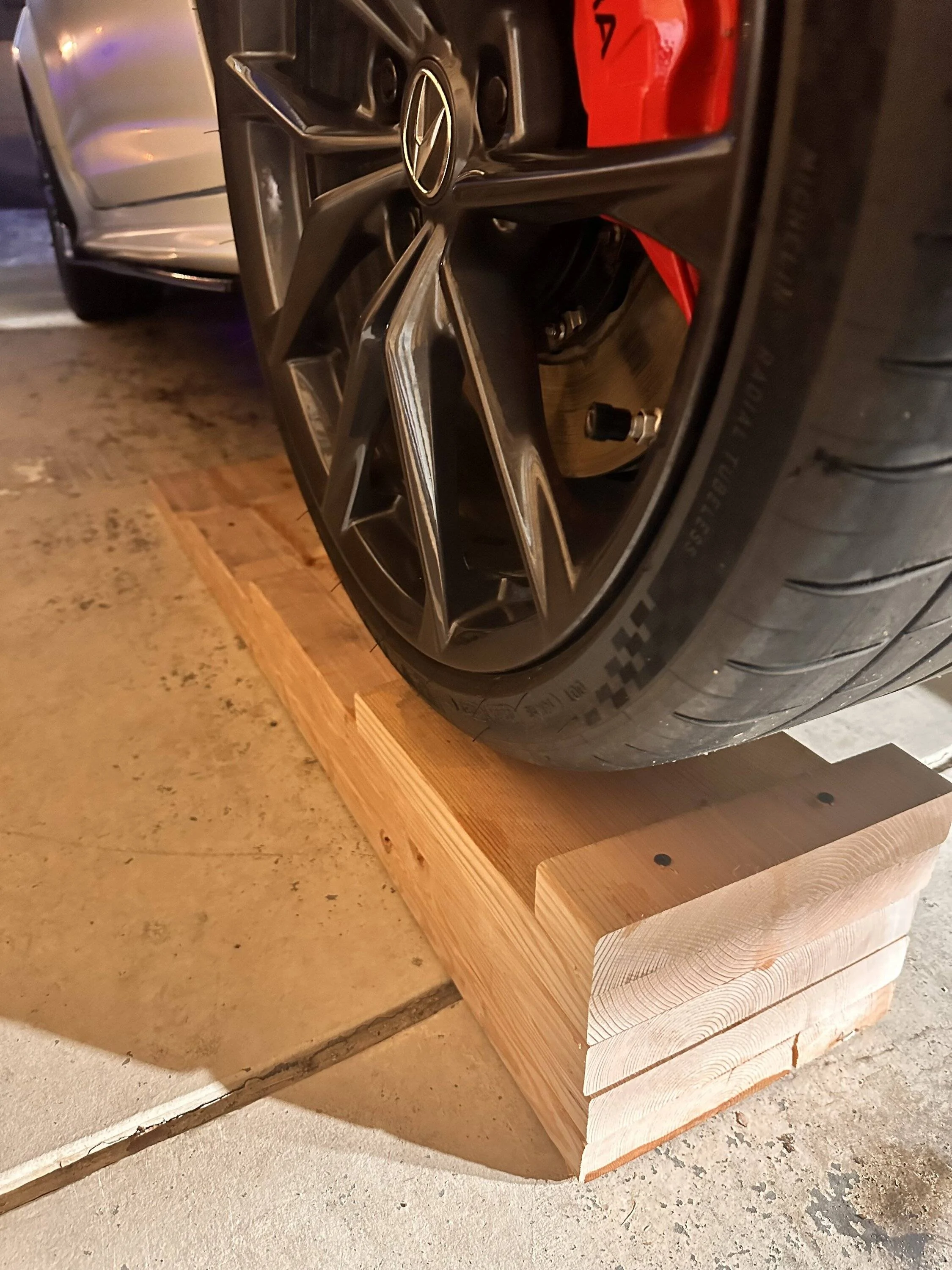

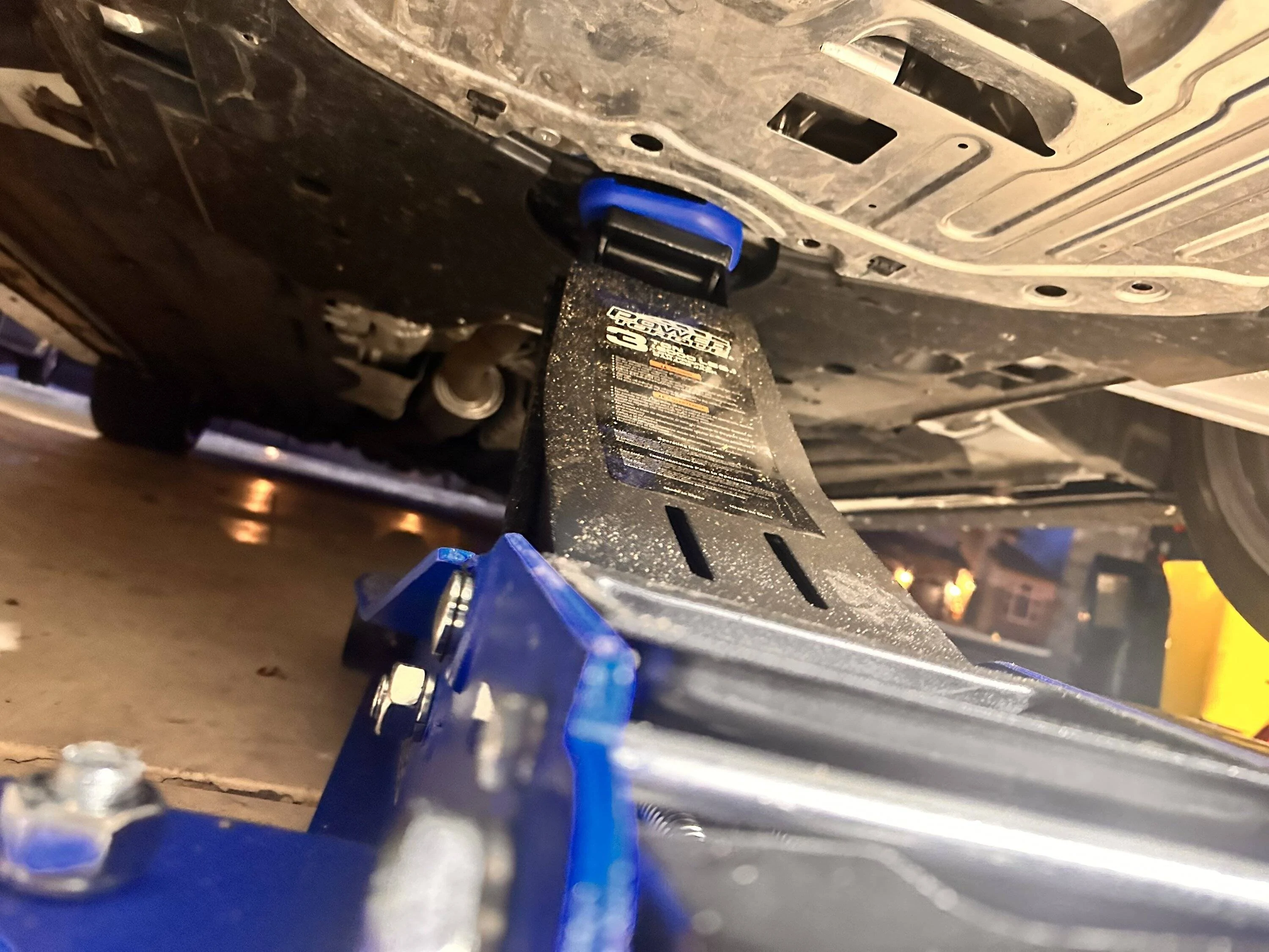

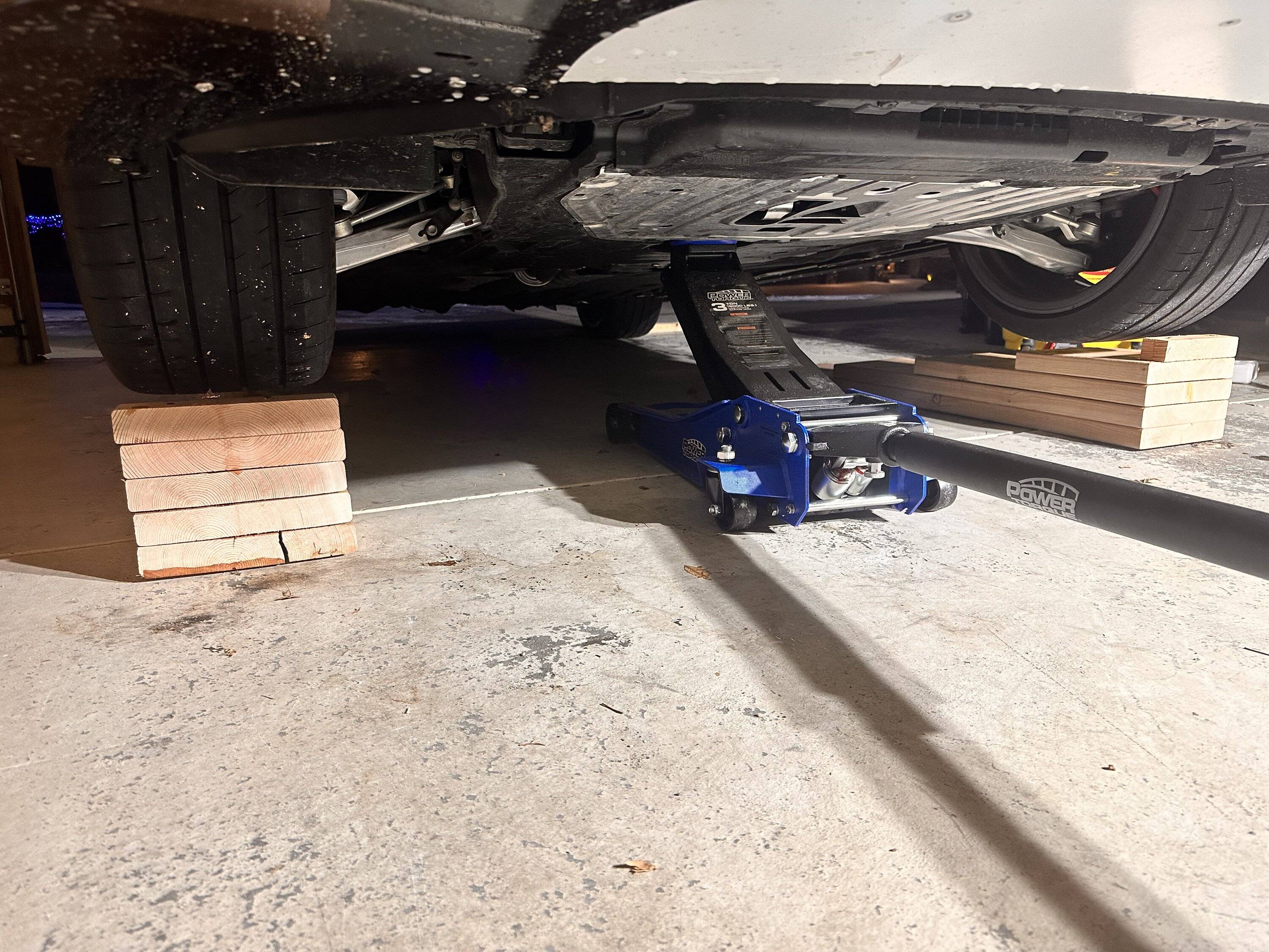

@SlippyFist I did some testing, here are results:
Equipment list:
-Pittsburgh low-profile 1.5 ton aluminum floor jack + rubber pad on lifting surface
-Pittsburgh 3 ton aluminum jack stands + rubber pad on jack point surface
-Megan Racing 2-piece low profile ramps
-6 pieces of 2”x8”x12” wood
Lifting at rear jack point with my floor jack maxed out will not allow jack stands to fit under rear pinch weld locations. So I used my wood pieces to create a raised platform for the floor jack to be on, increasing ground clearance. My jack stands are still a little too tall, so I’m going to buy some low-profile jack stands for rear-lifting duty.
No issues with front jack point; drive on ramps, place jack and lift, easily clears for my current jack stands

here you go:
right. now try it without the wooden ramps lol. hey i have those same jack stands lol
i'm probably going to end up getting the QJs honestly, i'm not willing to do the song and dance with ramps and multiple jacks and all that. plus my parents both have a 5 series BMW so i can use it for oil/tires on their cars too
