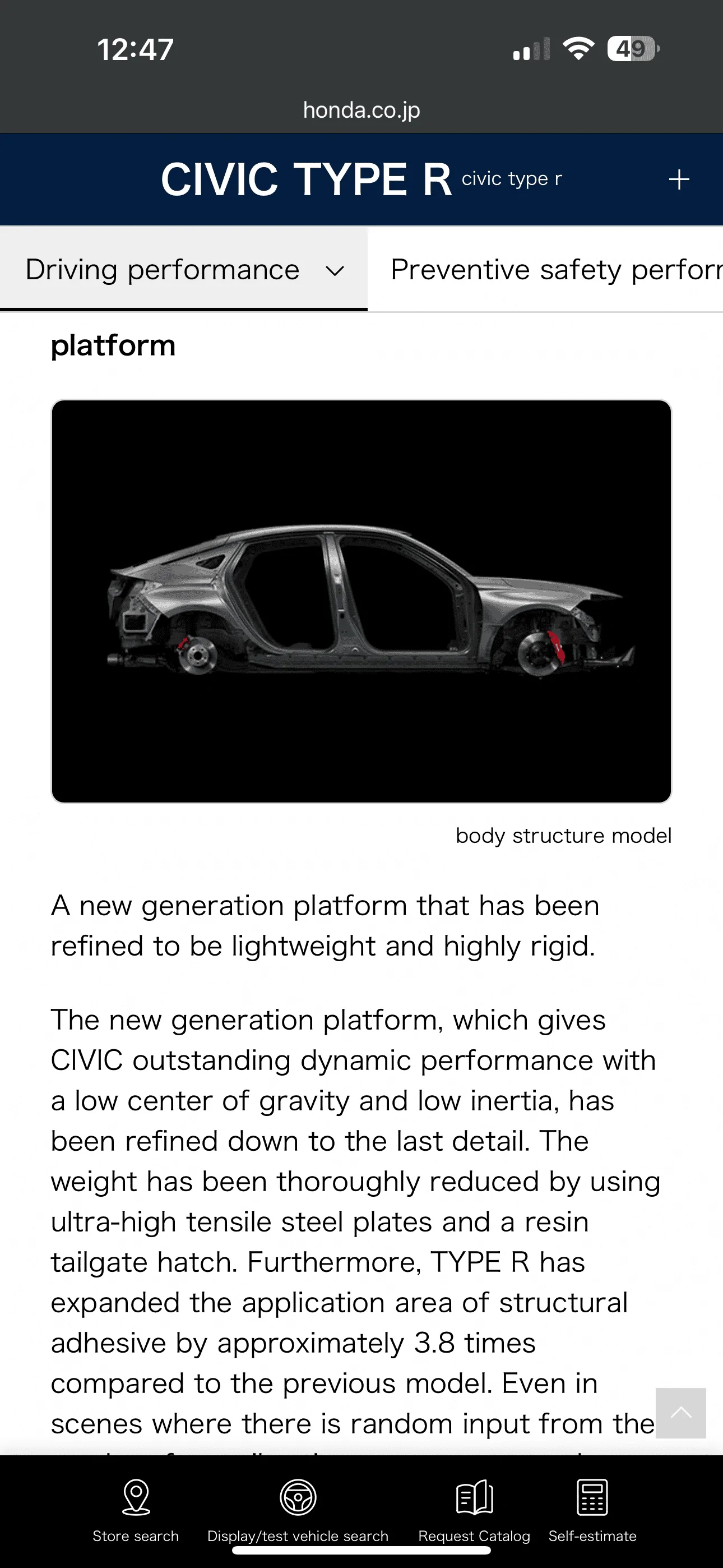

I see. What I did with my GR86 was use the front left and jack it up high enough where it would lift one side of the car and then put a jack stand in the rear left to change two wheels at a time. Is the integra stiff enough to do the same?
it’s a very stiff car, but CTR/ITS uses a special type of metal:

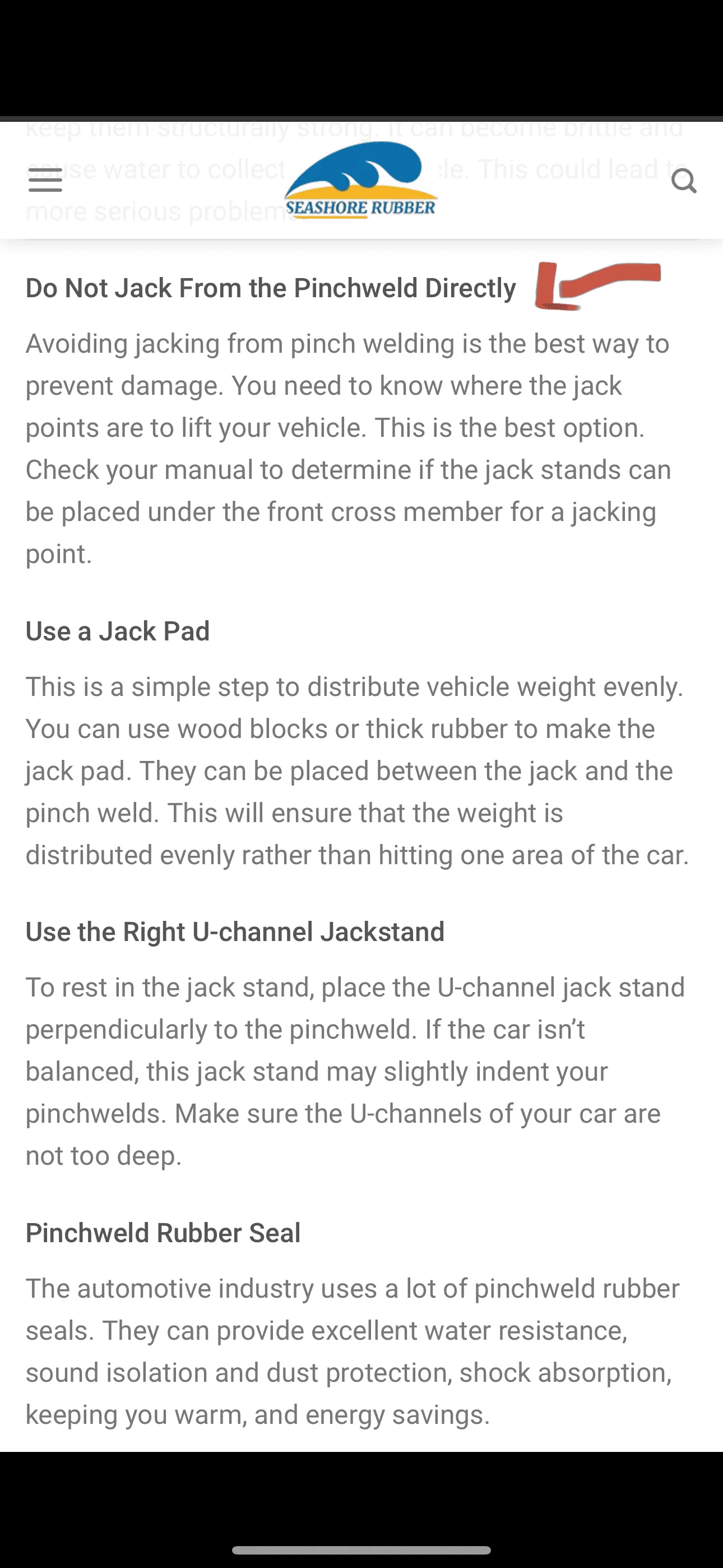

Acura Integra Lifting the car for servicing FECAF337-392E-4F98-AA5E-AC962257D961
In general it’s best to avoid jacking up from the side support location pinch welds
Acura Integra Lifting the car for servicing 47A756A3-3F55-49D8-9AD8-9F5B184E6F21
why not just change the two front and rear tires at the same time instead of the side?
Interesting, that post says don’t jack from pinchweld directly but right under that it’s insinuating to use a jack pad to even out the force on the pinchweld? I was thinking for doing a tire rotation it would be easier this way. It’s also easier to access pinchweld compared to the front and rear jacking points for me.
I think they are saying the pinch welds are only for jack stands..
