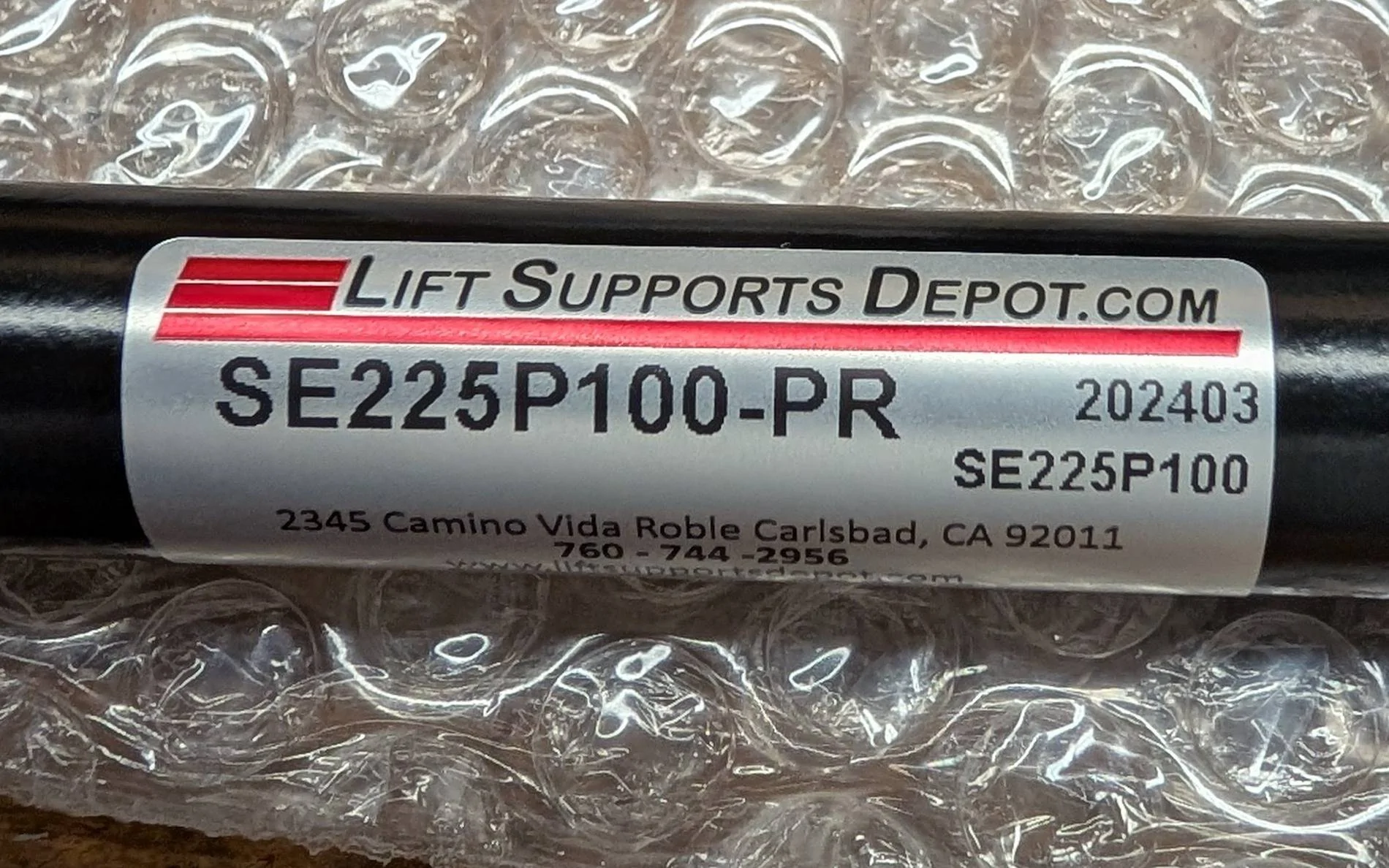

So just wrapping up my efforts here. I purchased an after market strut and I think it's the perfect size. I ended up pairing one factory and one aftermarket because the aftermarket "bumped" at the top of it's range and the factory one is a hair shorter so it stops the travel before it reaches the end. Trunk opens by itself and can be closed with one hand!
