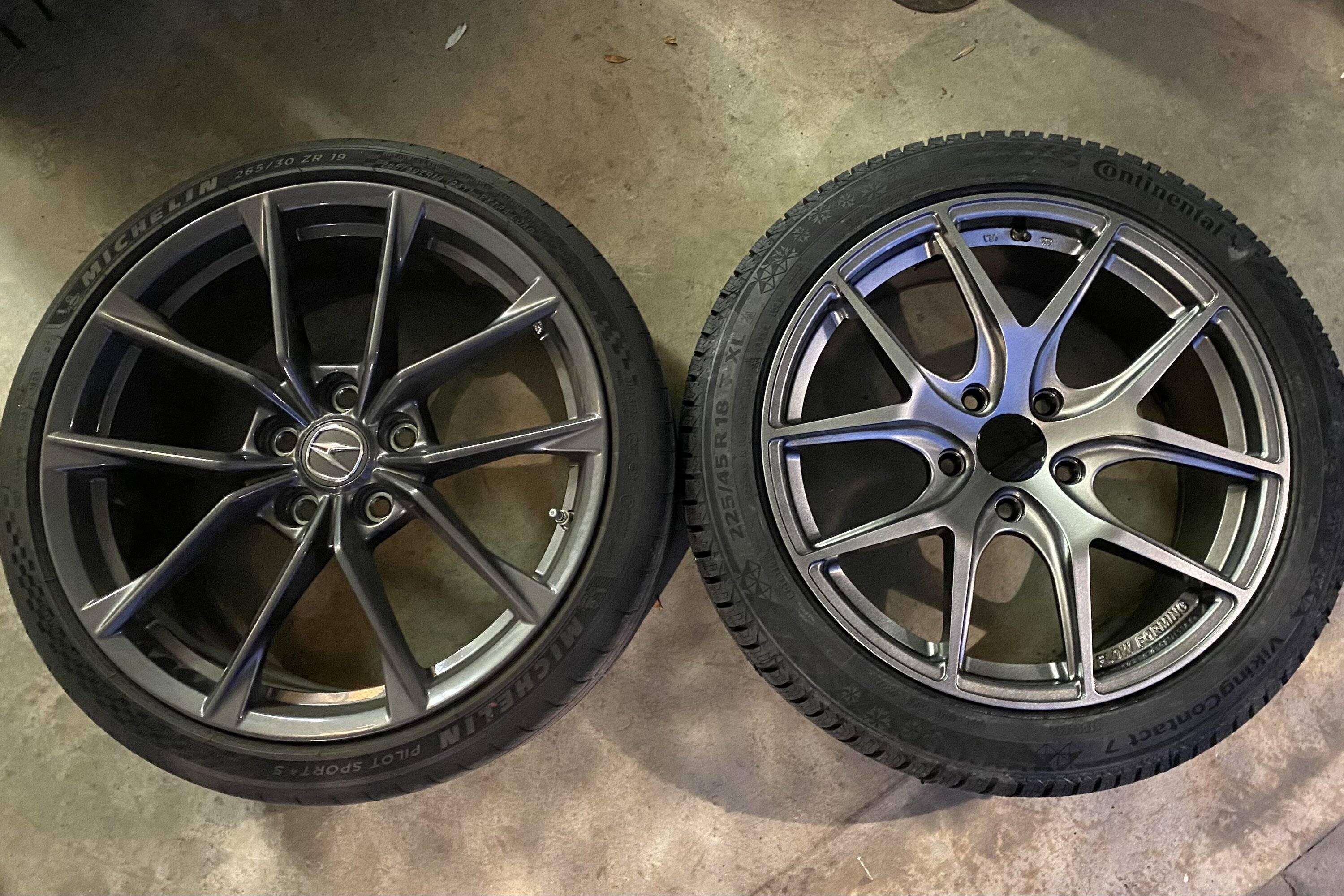

We get a lot of snow around here, so I went with a tall and narrow tire for best performance in deep snow and slush.
  • Fast Wheels FC04 Titanium 18x8 +40
  • Continental VikingContact 7 225/45R18
IIRC they weigh in at 43 pounds per corner, vs 53 for the stock setup. The larger outer diameter adds roughly 3/8" of ground clearance.
At this time of the year it can take weeks to get an appointment in a garage, so I bought these online already mounted and balanced so that I could install them myself. Unfortunately, the aftermarket TPMS they use do not sync automatically like the OEM ones. I dropped by a garage and they were able to activate the sensors... for 80 CAD. Hopefully the car will still remember this set of sensors next year, otherwise they'll end up costing me a lot more than the OEM sensors.
Wide stance looks a bit weird from the rear with these narrow tires!
Acura Integra Type S Winter Wheels / Fitment Specs IMG_6389
Acura Integra Type S Winter Wheels / Fitment Specs IMG_6387
