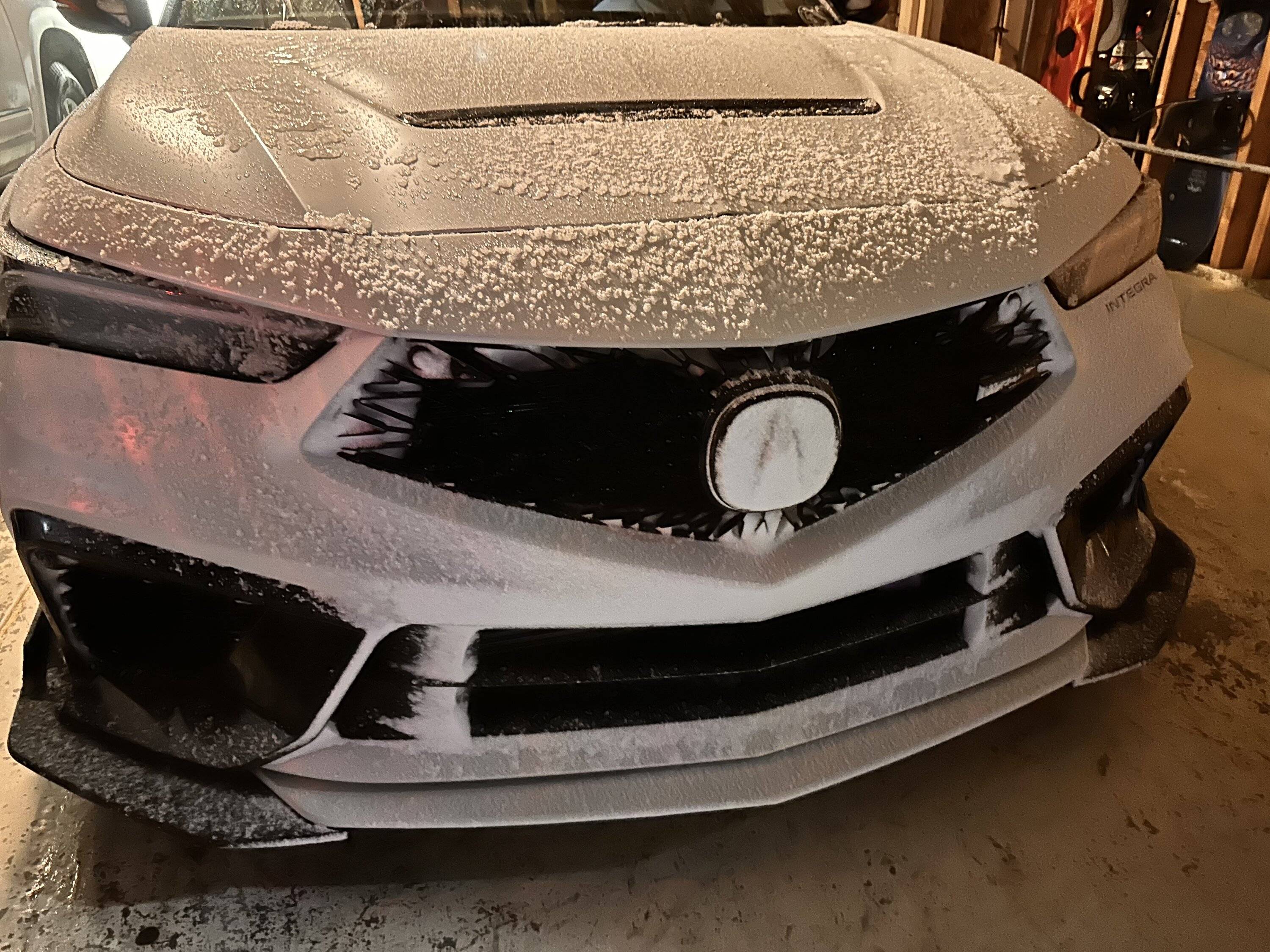

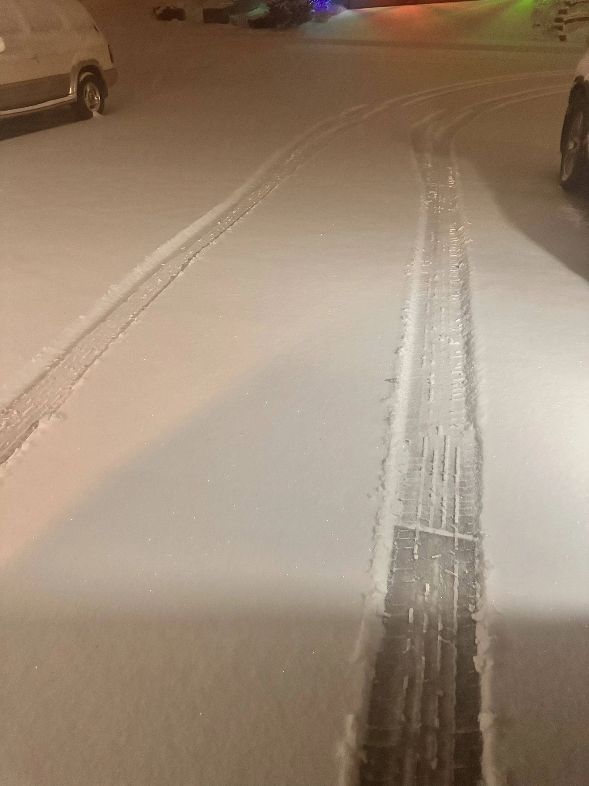

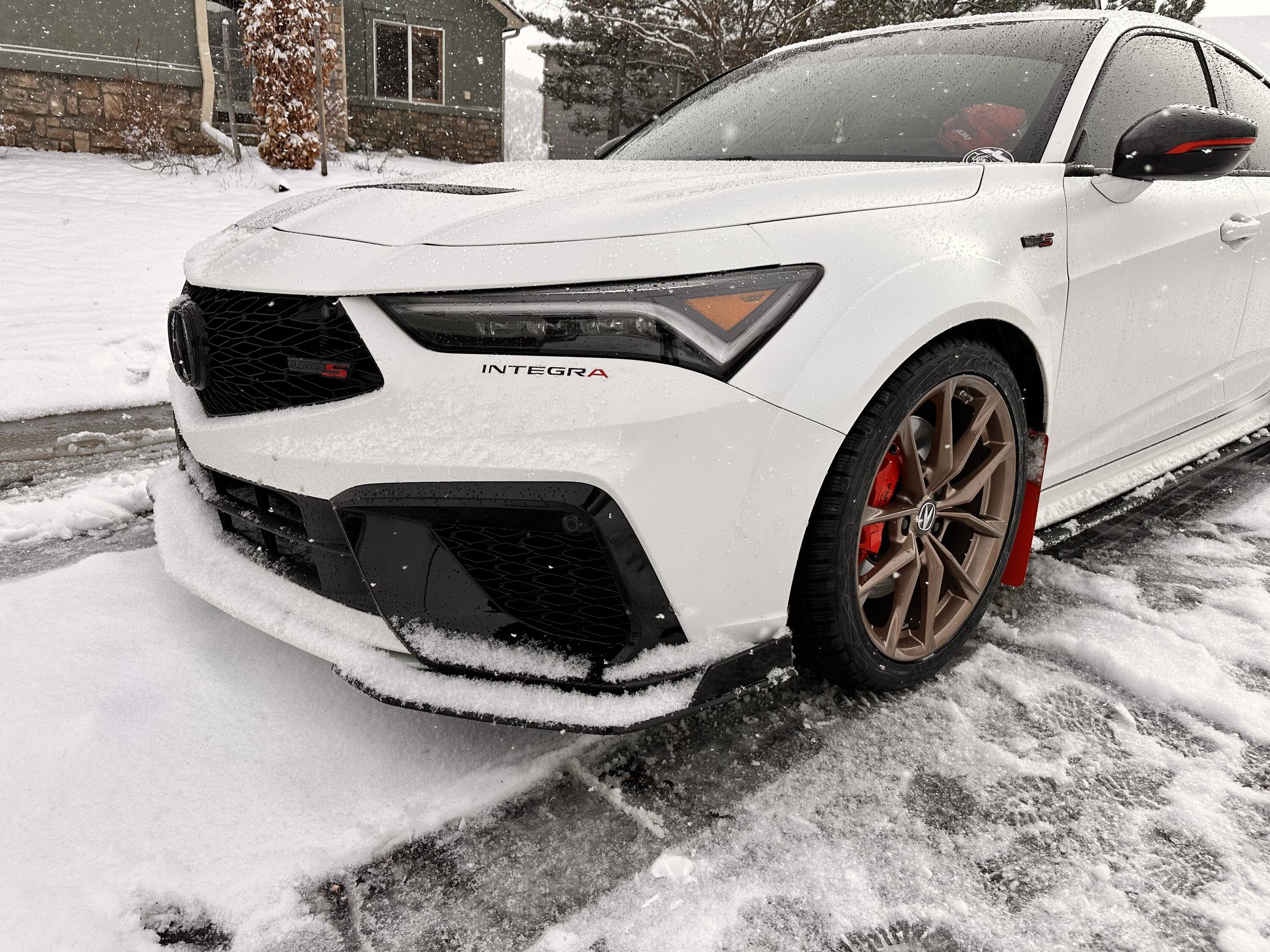

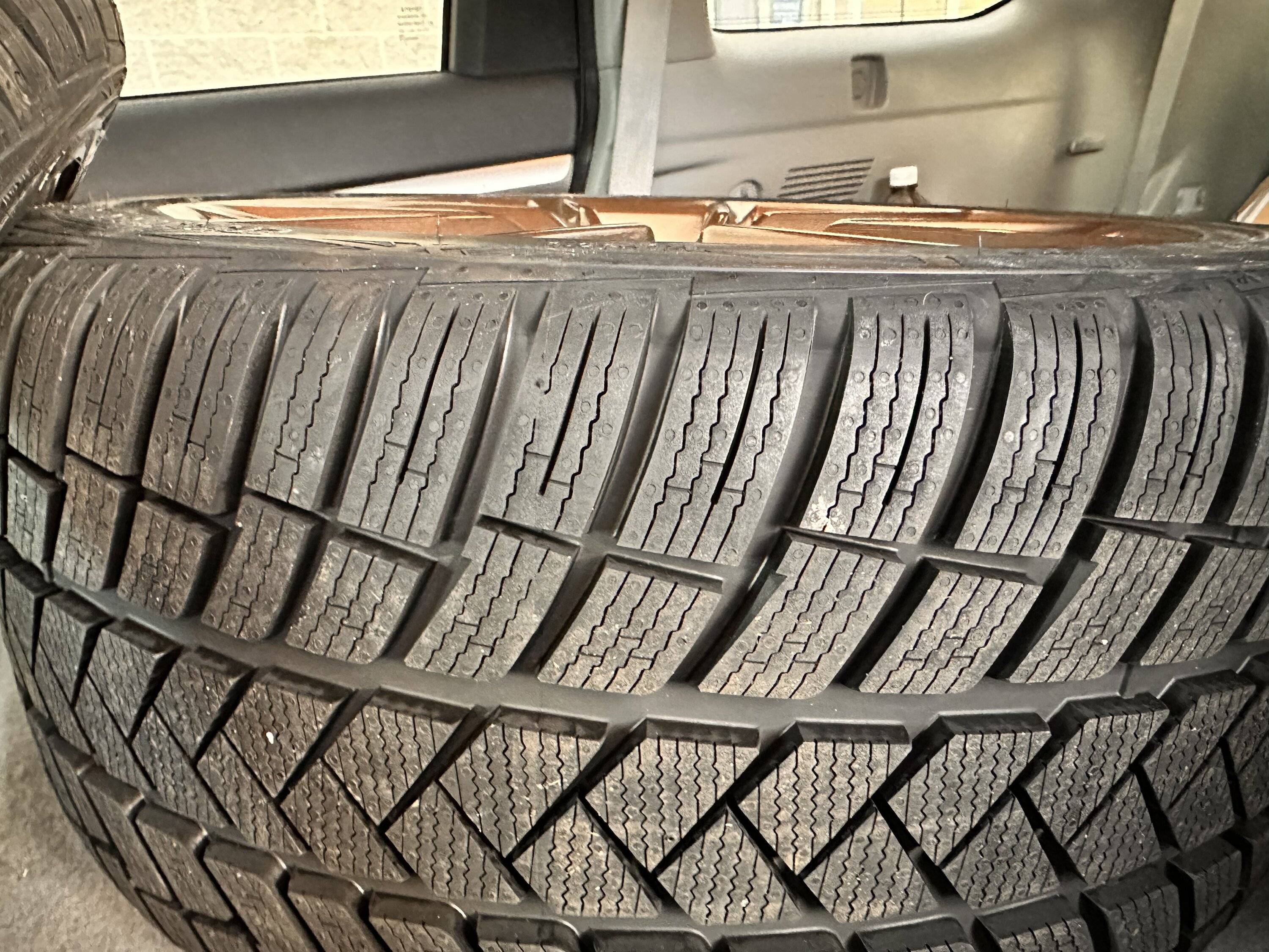

Colorado here. Plenty of snow in winter season, though it does melt fast. Originally I had ordered Pirelli P zero winter, went on back order. Then was going to get Wintercontact TS 860S but when I showed up they only had two in stock.
ended up with Veredestein Wintrac Pro 275/35R19 dedicated winter tires:
Acura Integra Type S Winter Wheels / Fitment Specs 6224A477-EBEE-45CC-9492-2BB1E06B6CF0
Acura Integra Type S Winter Wheels / Fitment Specs B1422222-706B-43F5-9048-CBE44EED357F
Acura Integra Type S Winter Wheels / Fitment Specs B078614A-A8D4-4D71-AF5A-7173605BBA27
Acura Integra Type S Winter Wheels / Fitment Specs 6B7F7370-D2AB-4C18-B97D-AE39E8D6648B
with these tires the car climbs up inclines like a champ. If you get heavy snowfall and freezing temperatures it’s important you get performance winter tires that are flexible in sub freezing temperatures with tire sipes maximum traction on icy surfaces.
you can still have fun on snow or wet pavement if you really pushed it. But the key factor is when you start sliding you have winter tires that will get you grip back as soon as possible. When making split second decisions when someone is about to slide into you or you’re uncontrollably sliding into a collision, every microsecond counts. Safety first and ability to breeze through blizzards without getting stuck is gold.
get the Alpin 5, TS 860S or Wintrac Pro, all tested to be excellent in hazardous conditions with minimal stopping distance

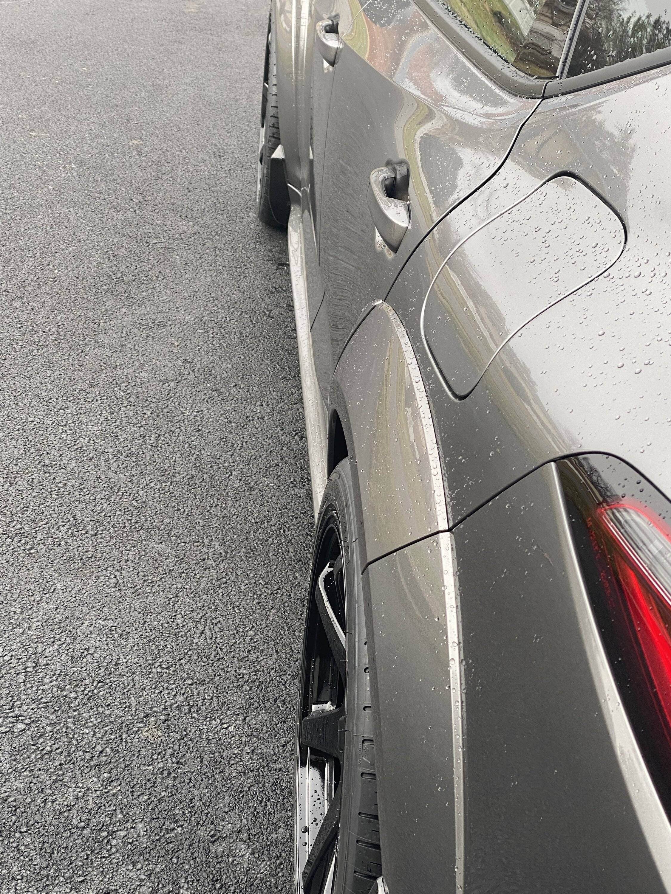

We get a lot of snow around here, so I went with a tall and narrow tire for best performance in deep snow and slush.
  • Fast Wheels FC04 Titanium 18x8 +40
  • Continental VikingContact 7 225/45R18
IIRC they weigh in at 43 pounds per corner, vs 53 for the stock setup. The larger outer diameter adds roughly 3/8" of ground clearance.
At this time of the year it can take weeks to get an appointment in a garage, so I bought these online already mounted and balanced so that I could install them myself. Unfortunately, the aftermarket TPMS they use do not sync automatically like the OEM ones. I dropped by a garage and they were able to activate the sensors... for 80 CAD. Hopefully the car will still remember this set of sensors next year, otherwise they'll end up costing me a lot more than the OEM sensors.
Wide stance looks a bit weird from the rear with these narrow tires!
When you put the Fast FC04 wheels, did you find that the rear were a bit of a tighter fit than the front?

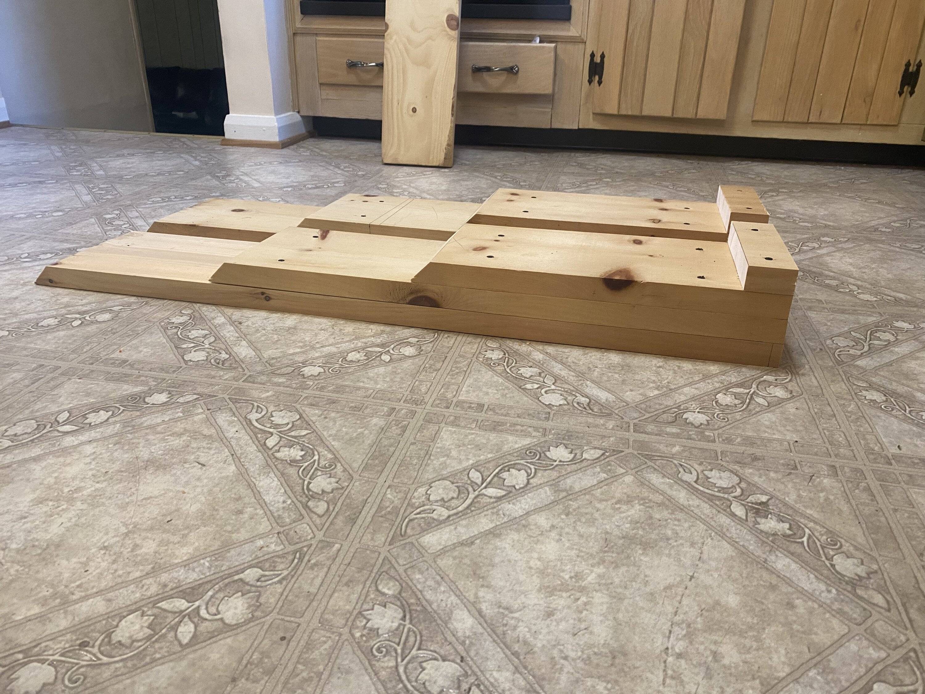

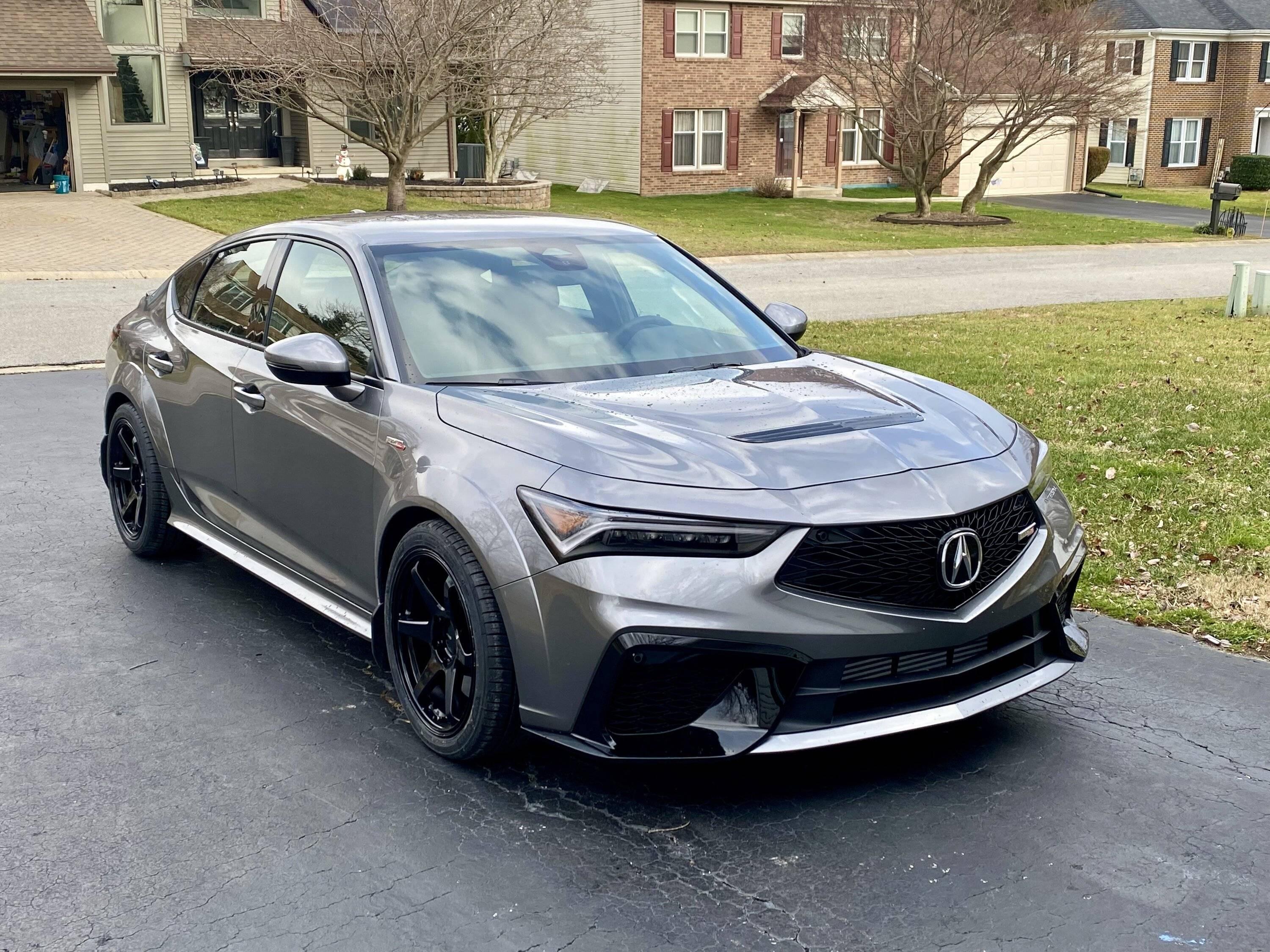

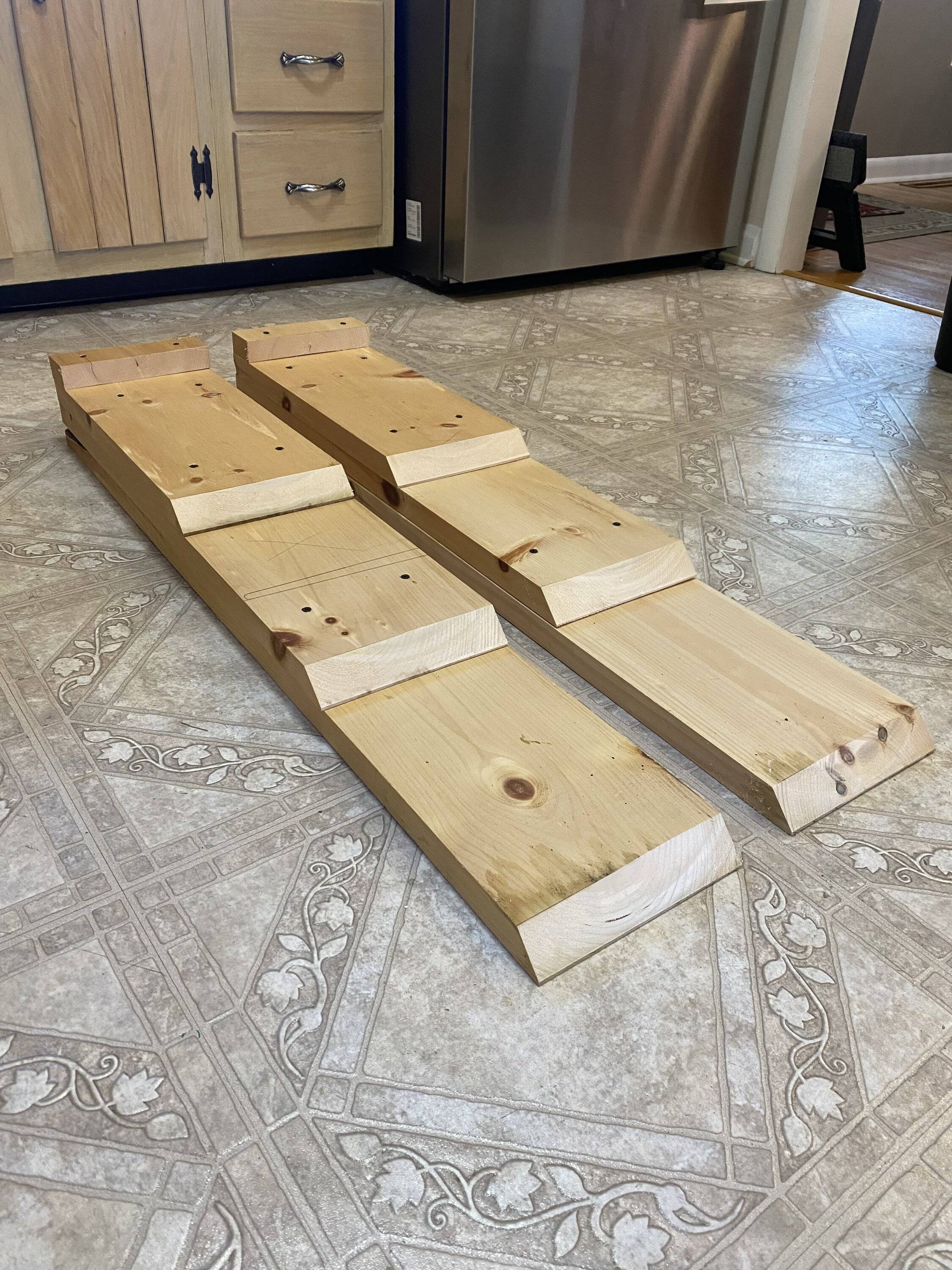

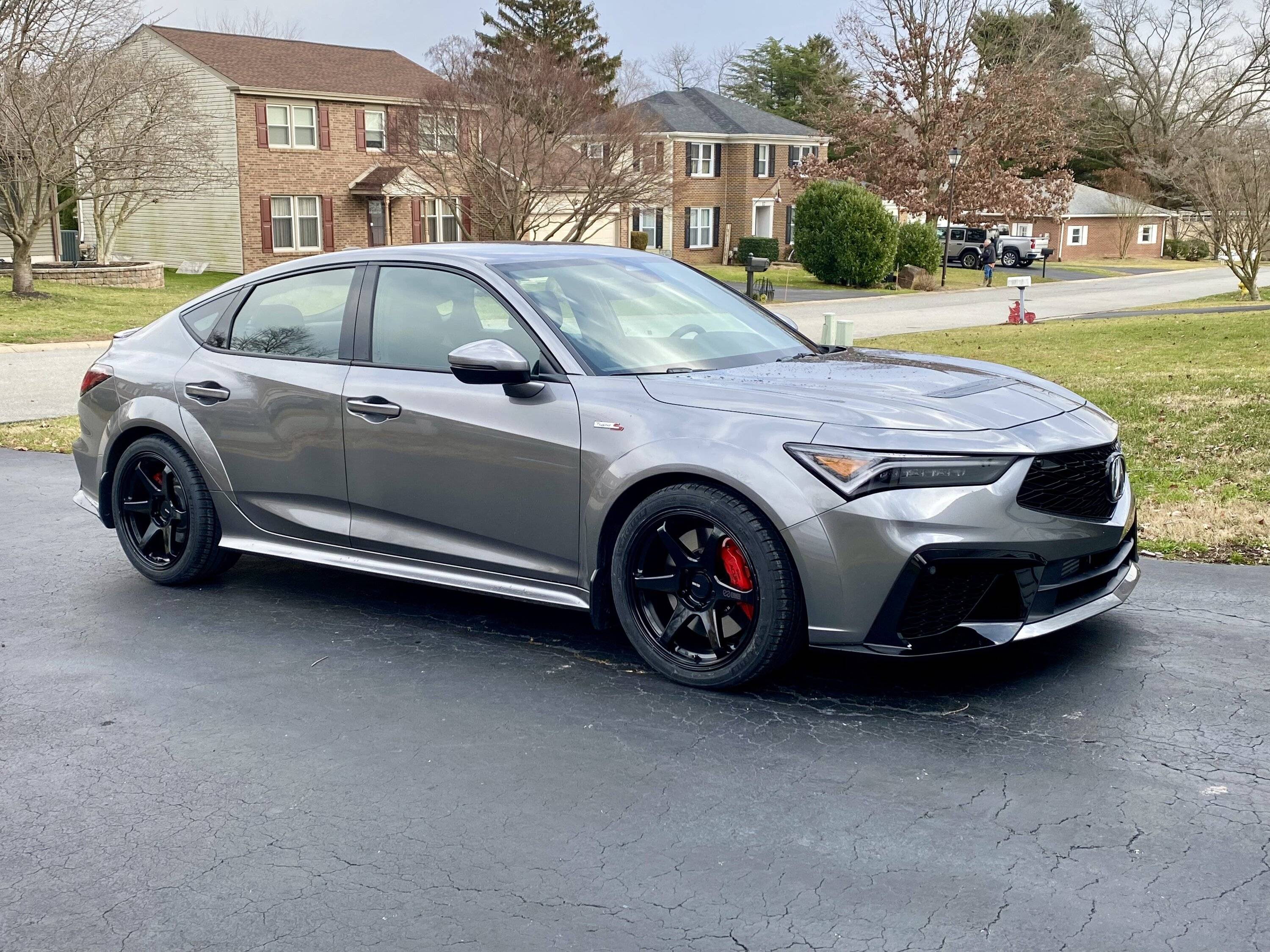

Finally got the winter set up on along with the splash guards. With some help from this thread, I went with 18x9.5 +45 Enkei T6Rs and Michelin Pilot All Season 4 of n 265/35 18. Ordered the package from Tire Rack and even got an $80 discount for picking them up since the distribution center is 5 miles from my house. Ordered with the TPMS sensors and they work great. Took about 1 mile of driving and they automatically connected.
I must say, the ride in this setup has completely changed for the better. I was not expecting it but I guess I know why it's so popular with the CTR crowd. We don't get much snow here in Delaware, so I wanted something that would keep the handling characteristics of the car.
Install wasn't bad at all. Ended up building my own low profile ramps out of 2x8 scraps I had. Used a low profile jack at the center jack point. Rear was even easier. Had to buy a Husky low profile jack from Home Depot though.
