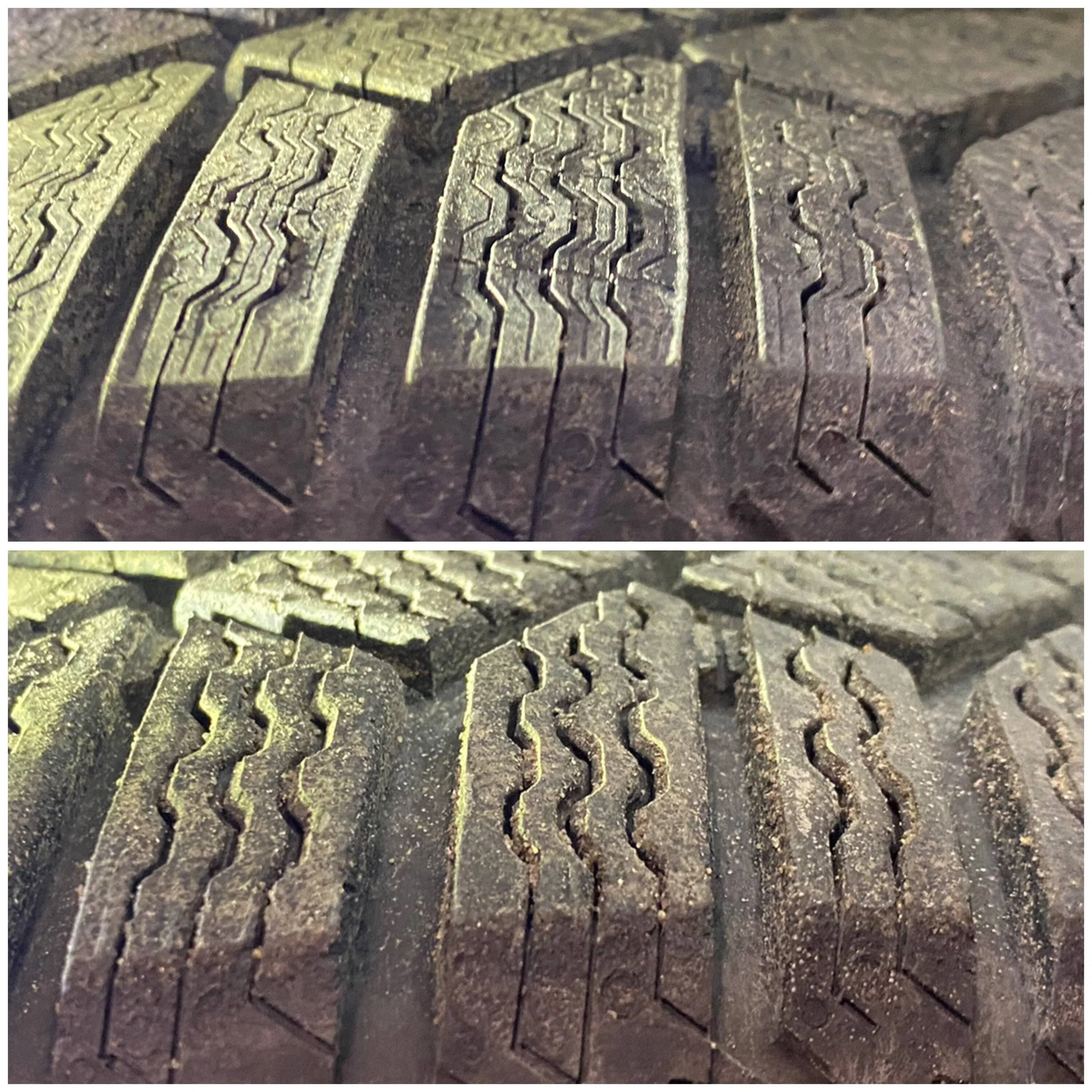

Here's how the Vikingcontacts look after 1500 km, mostly on dry pavement. Top is a rear tire and bottom is a front tire. I probably should drive more gently with these, also I'm still getting used to the way traction control behaves in this car. With these tires it is easy to break traction when flooring it in 2nd gear, even on dry pavement, and I'm finding that traction control may or may not cut power in this situation.
Funny that all the superficial sipes have disappeared from the front tires. These would only boost ice performance for a tiny fraction of the tire's life.

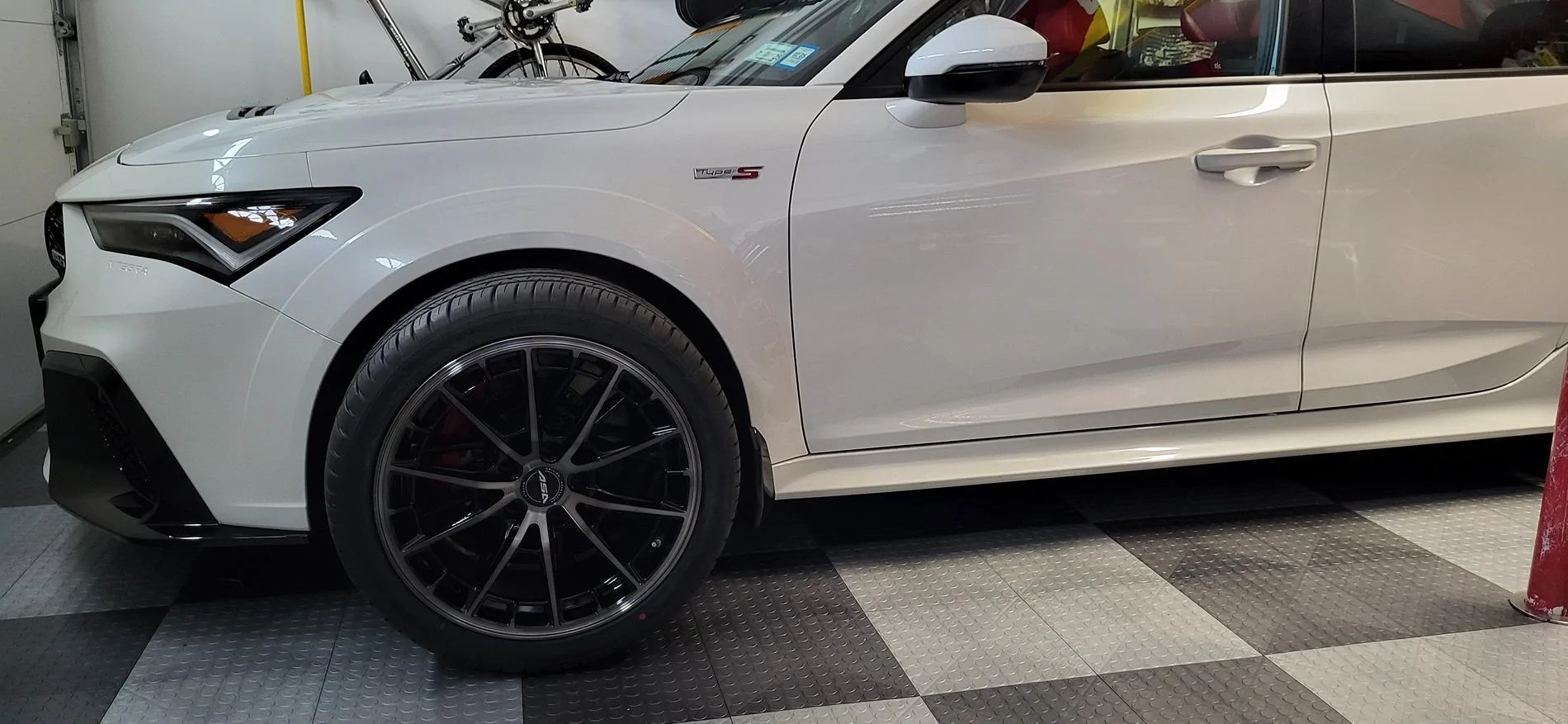

Just wanted to share what my plans are for this winter. Was deciding between stock wheels and all seasons vs a dedicated set of tires like many in this group.
I decided to go with a dedicated set. Ordered these on Tire Rack, 18x8 +32 ASA wheels with 235/40 Cooper Zeon All Season tires (they'll poke out about 9mm more than stock).
These tires are discontinued and were a great price. Wheel and tire package came to $1340 after the discounts/rebates (and Rakuten!)
When it's time to slap these on in November I'll report back to see how the tires do in NYC area. I don't plan on driving in the snow, but needed something for the cold weather.

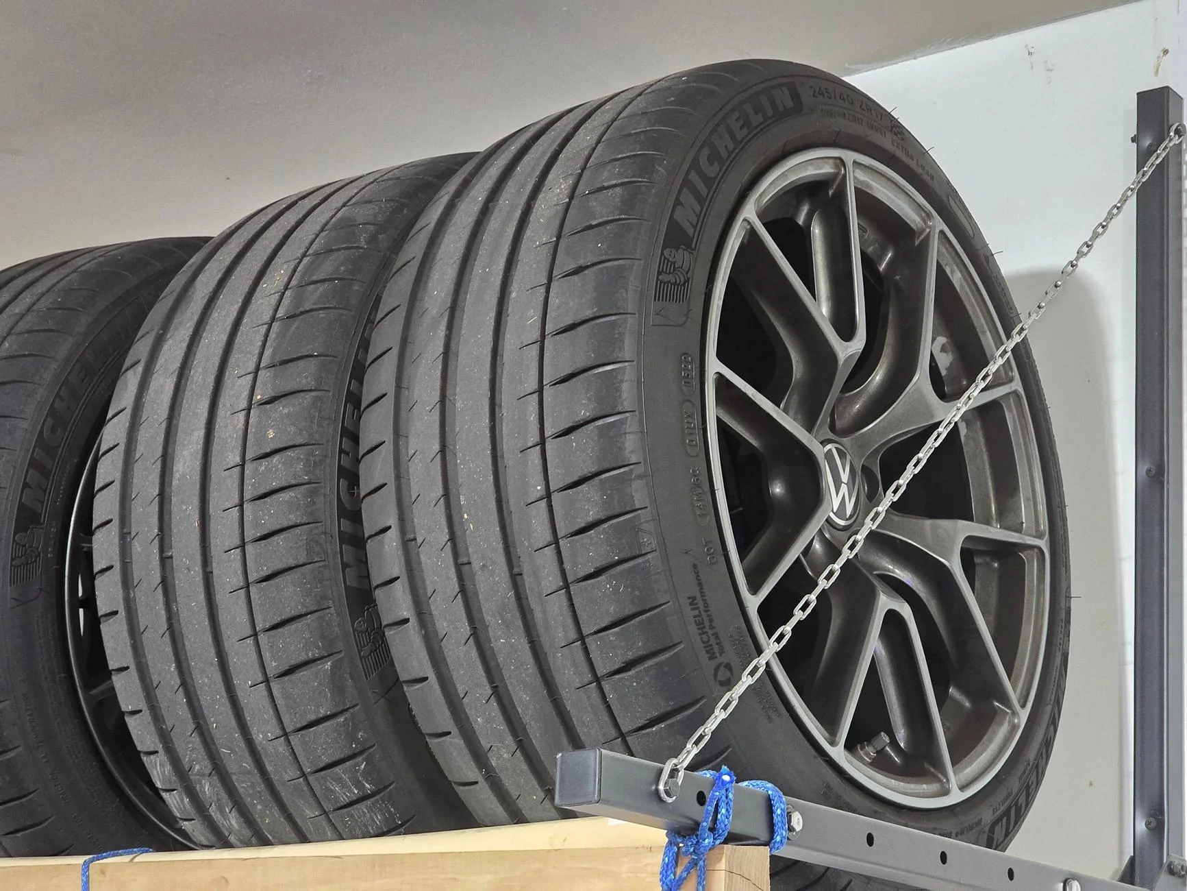

As a general rule, for every 0.5" size change in wheel width, you account for a 10mm tire size difference. Factory is 9.5 and 265 and it already has a decent amount of stretch on an already VERY wide tire (because it's a summer tire). So that means an 8.5" would have the same stretch with a 245 on a summer tire. Winter tires are the narrowest at the tread and as are in between. So you can expect a 235 as to have quite a bit more stretch than factory. Having a taller sidewall will create more "bulge" to make this stretch less visually apparent, but tell that to the pothole...
Here's a photo of a 245/40 ps4s on a 17x9. There's "a lot" of stretch here on an already very wide summer tire. If you even think about bumping a curb, you will get rash. If your tire pressure is a bit low, a pothole will bend or rash it pretty badly... I speak from experience on this... Two of the 4 wheels there have felt it. This would be less stretch than a 235/40 on an 8.5 with an as or winter.
