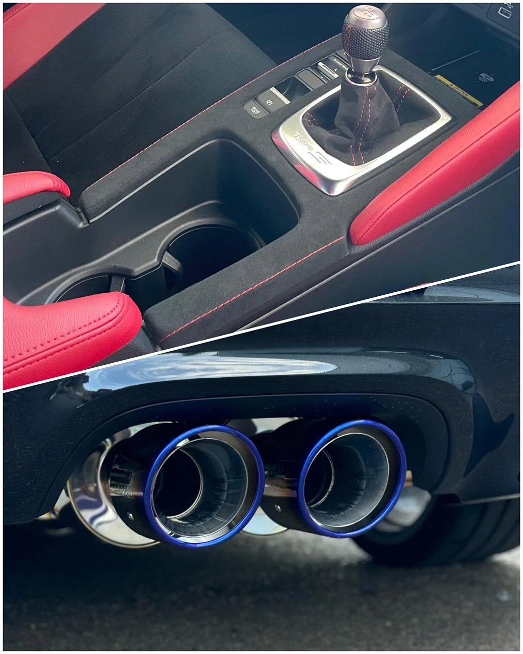

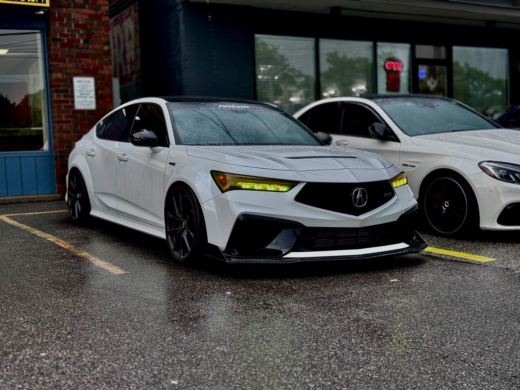

Not all installed today but picked up the car about a month ago and this has been the progress so far. Waiting for my APR lip to show up to install that.
PRL HVI Intake
Hybrid Racing Short Shifter
Hybrid Racing Chicane Shift Knob
Swift Spec-R Springs
Bonoss 20MM Spacers All around
AWE Track Exhaust
PRL Rear Motor Mount
ECU Unlock + Hondata Flash (93 map)
Roof wrapped in Gloss Black
Full Headlight yellow tint

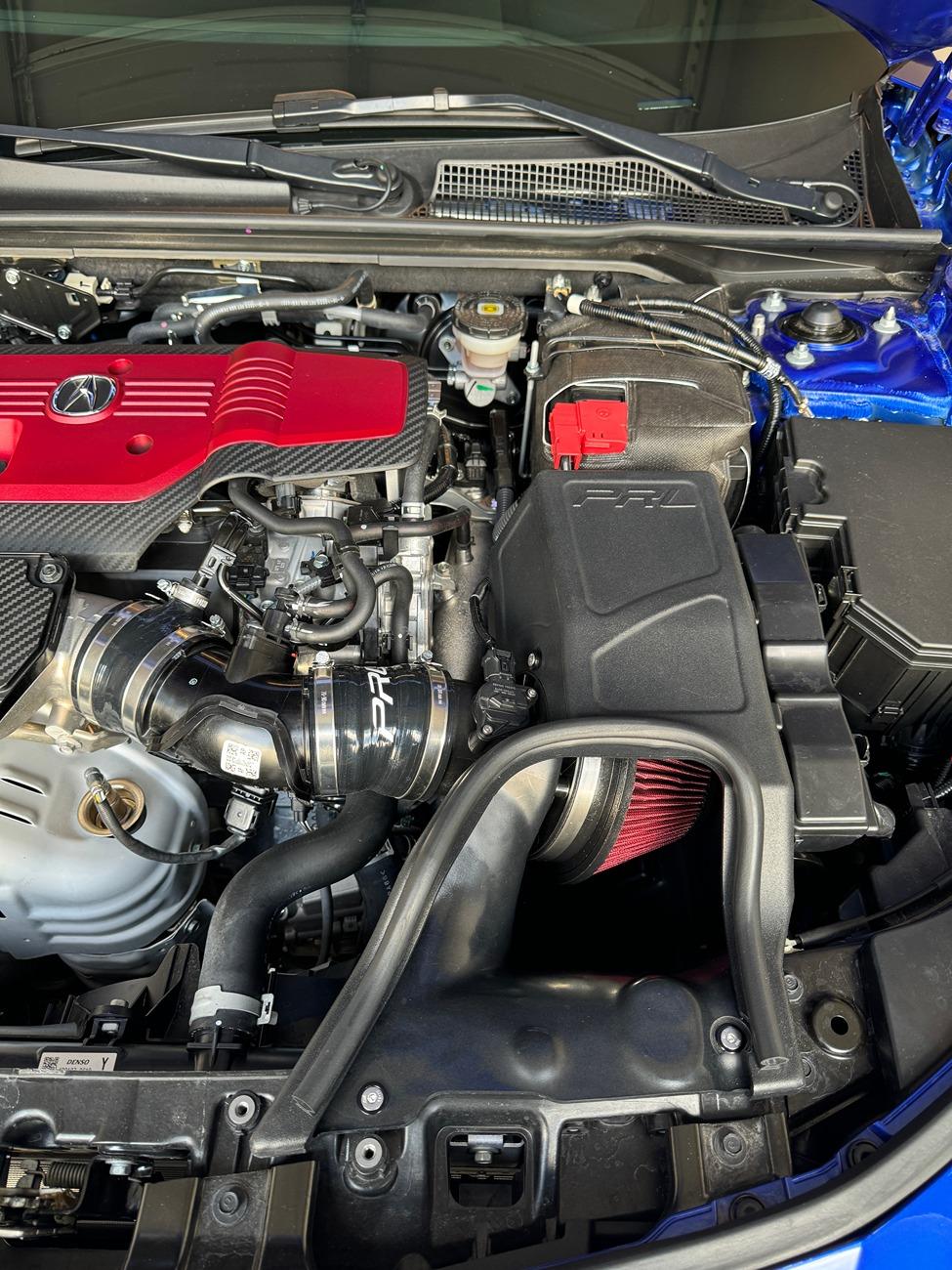

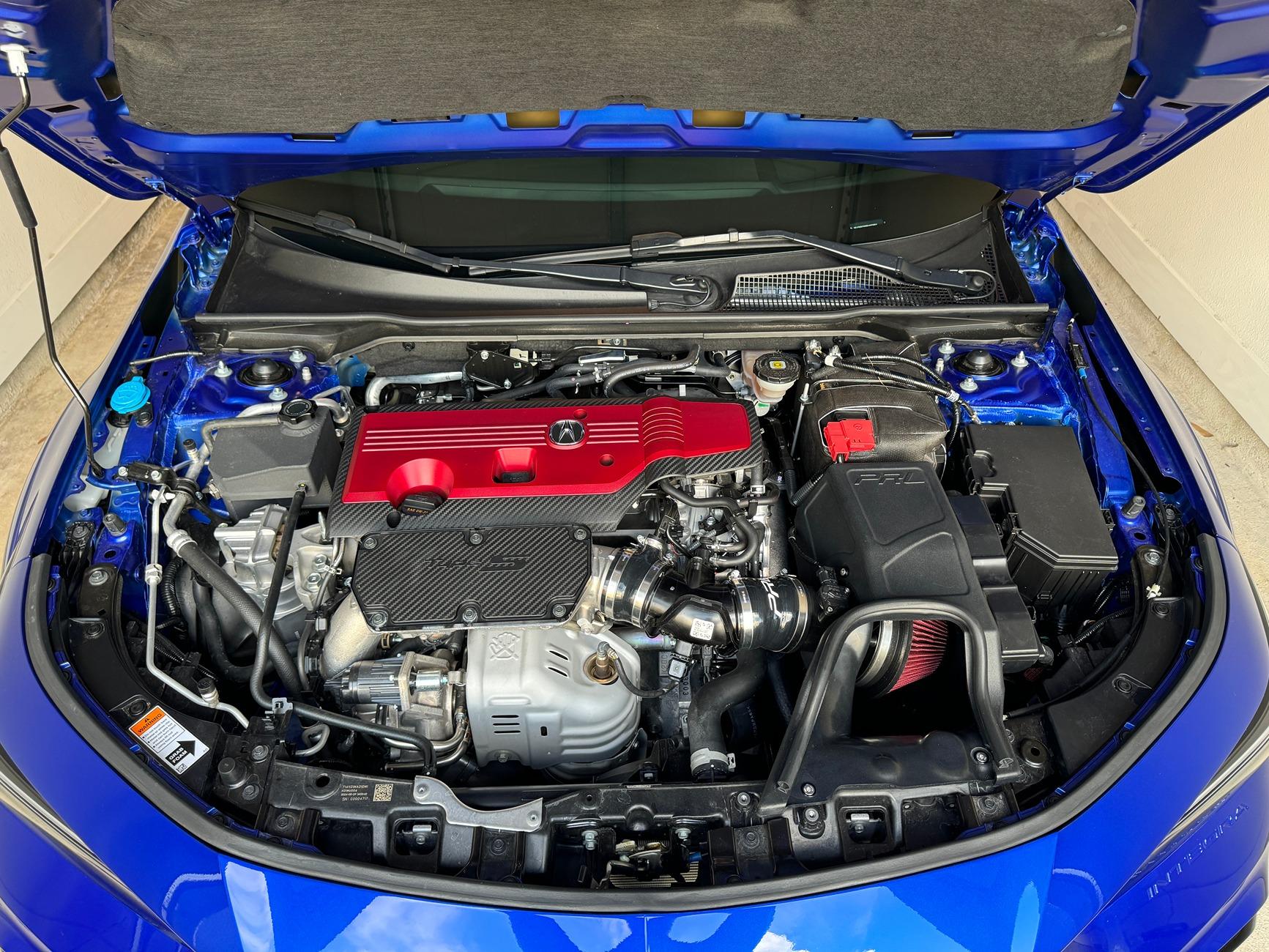

Installed PRL's high volume intake. Took me over 5 hours... but definitely learned while tinkering with the car! Also gave it a much needed wash!
Will be posting my build and progress on IG: @thatsriskybro
For anyone considering the HVI:
Not going to reinvent the wheel here, plenty of install videos on the FL5 available which is basically a carbon copy as far as the engine compartment is concerned. Overall, it was a simple install - just a pain in the ass (especially fitting the hoses).
Videos I used to help guide install - PRL's how-to guide was okay but for someone that has not much experience working on cars outside of oil changes I needed more detail to navigate the install:
Shout out @koatic
Just need patience - take your time.

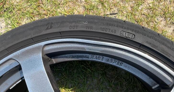

same thing happened to my aftermarket wheels at the track.. darn 30's dont have enough rubber wall..
Wow. PS4S tires?
