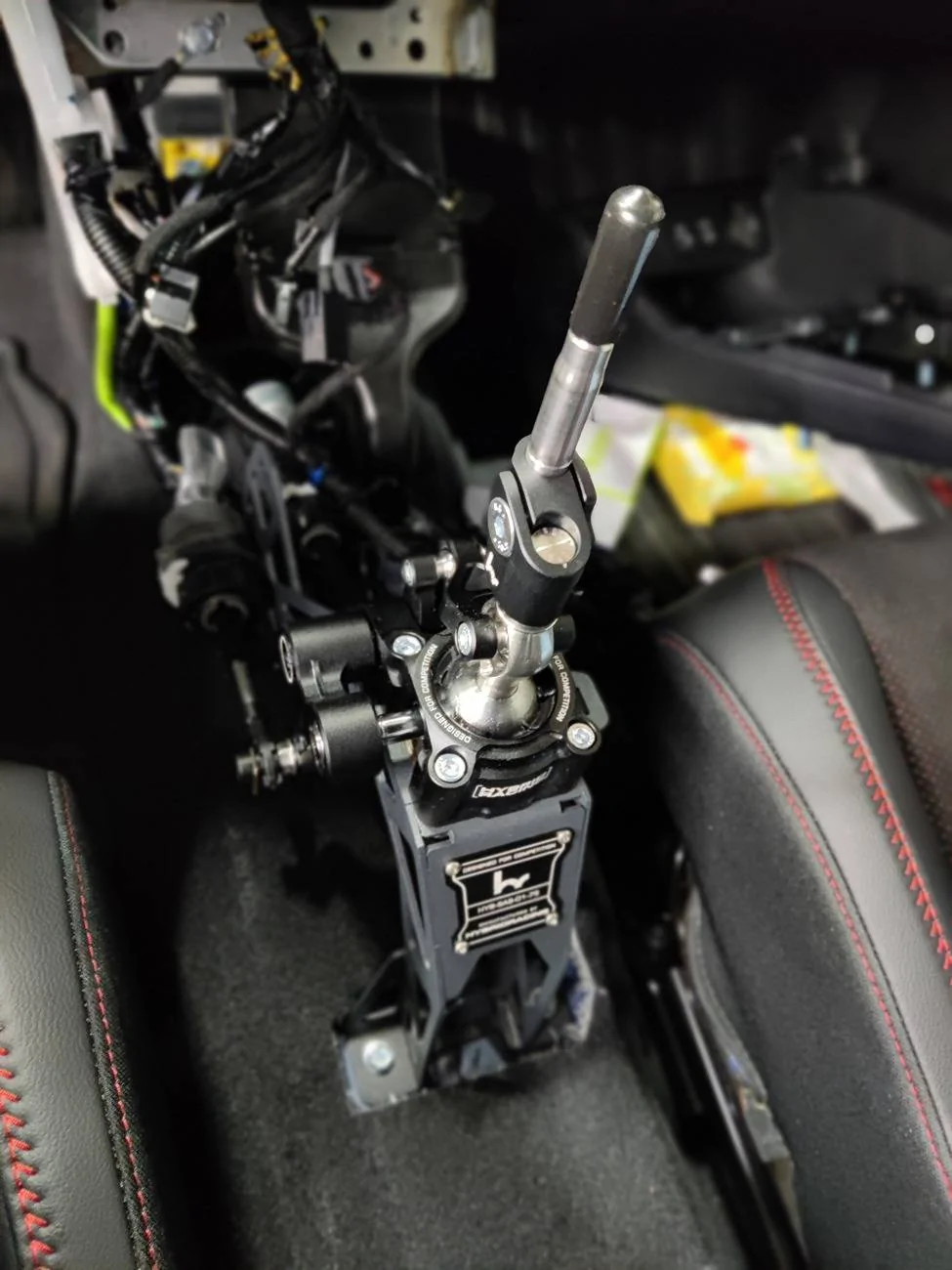

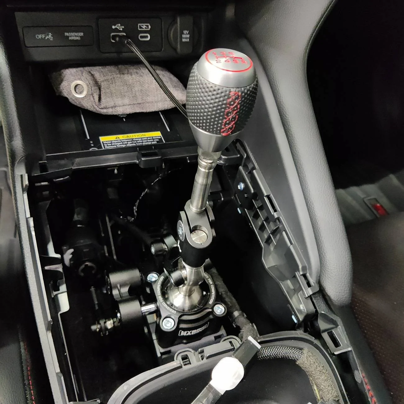

Installed the Hybrid Racing short shifter on Friday night and have since put 200 miles on the car. Trying to decide between the stock shifter and the Skunk2, leaning heavily towards the Skunk2 because of the weight.

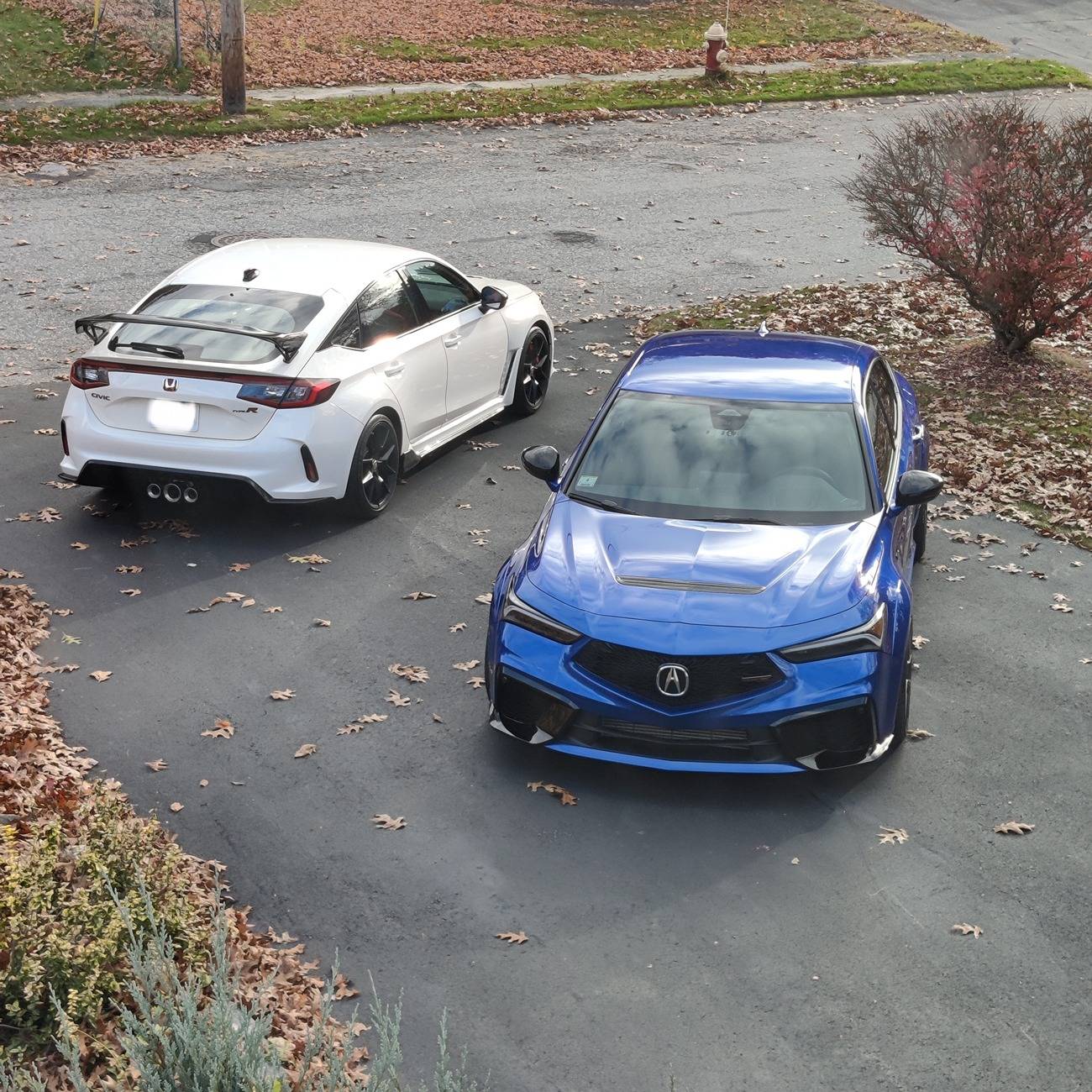

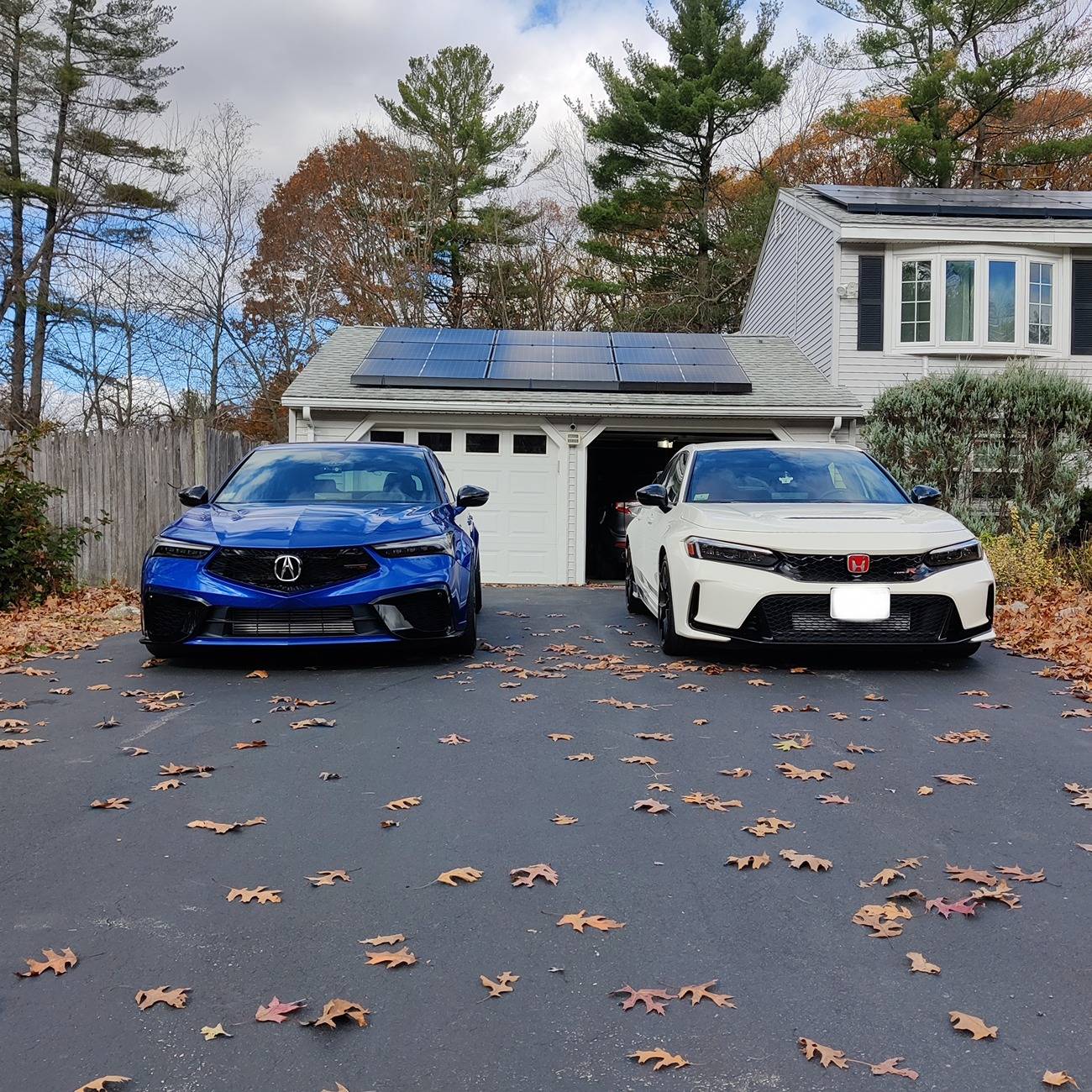

My buddy also came over with his Type R this morning and we traded cars for the day so I got to have some time with the stock shifter and my hybrid racing set-up.

I'm putting in the shifter this week as well. Any tidbits to watch out for when installing? Any tips on setup?

I don't know why, but I had the most difficult time trying to unplug the cigarette lighter connector. There's no clip release or anything, you just tug but mine was on especially tight. The only other bit that I can think of would be the shift collar, everyone seems to have difficulty with the factory one.
Outside of that, it's very straightforward, no real pitfalls or potential to damage anything. I would recommend magnetic tools if you have them or a magnet on standby for when you inevitably drop a screw into the void.
Tools needed:
5mm hex key
8mm socket
10mm socket
10" extension
Panel popper(s)

Before you put the shifter cable assemblies in the new base ....... polish, grease, or lubricate the openings for a way better install experience. For taking off the small clip to the gate assembly, I put a small wire tie around the exposed outer edge and just pulled it out. Way better than a pair of pliers and you don't bend it ......... ;-)

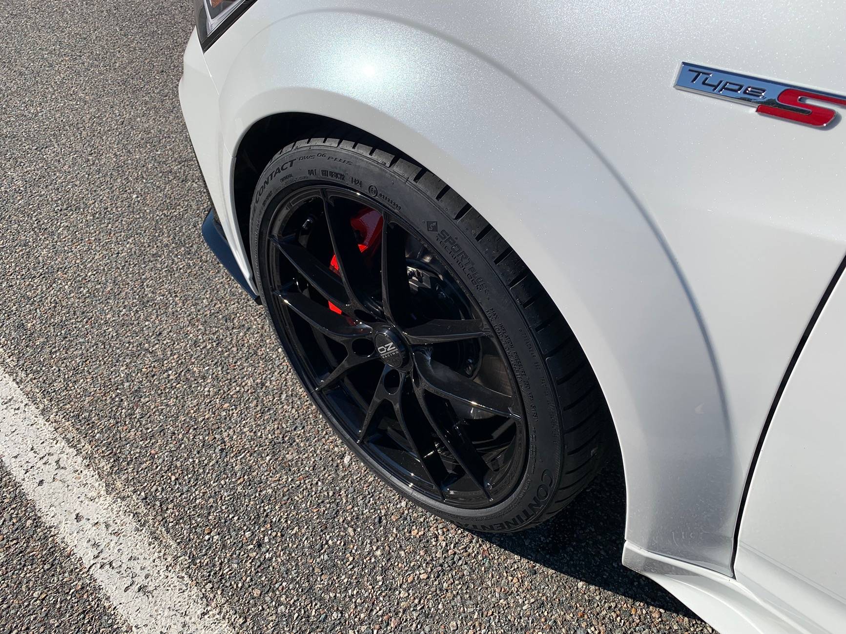

Finally had a free Saturday to work on the car. I installed my new wheels and all seasons, and did my first oil change.
Wheels are OZ Leggera in 19x9.5 e51, wearing 275/30 DWS06+ tires. The combo weighed ~46.2lbs. Edit: my stock wheel/tire combo came in at 51.0lbs, so this is a wider tire with a hair more sidewall, 18mm wider track, and 4.8lbs of weight saved per corner.

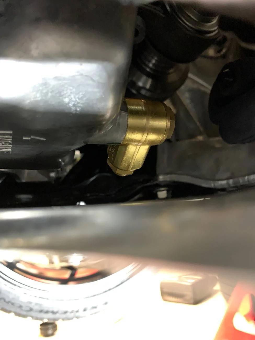

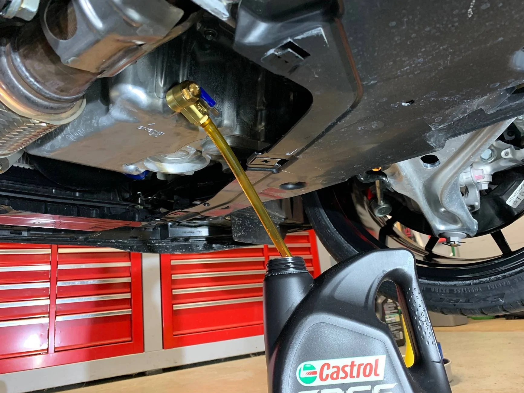

During the oil change I installed a Fumoto F106SX valve - there was tons of room to position it how I liked.
Acura Integra What did you do to your Integra Type S today? πŸ™‹πŸ»β€β™‚οΈ img_7445-jpe
Acura Integra What did you do to your Integra Type S today? πŸ™‹πŸ»β€β™‚οΈ img_7448-jpe
I used a new OEM filter and 5.5qts of Castrol Edge. Cut open the original filter and it was clean. Hit all the exposed suspension hardware with a light coating of Fluid Film for rust prevention.
